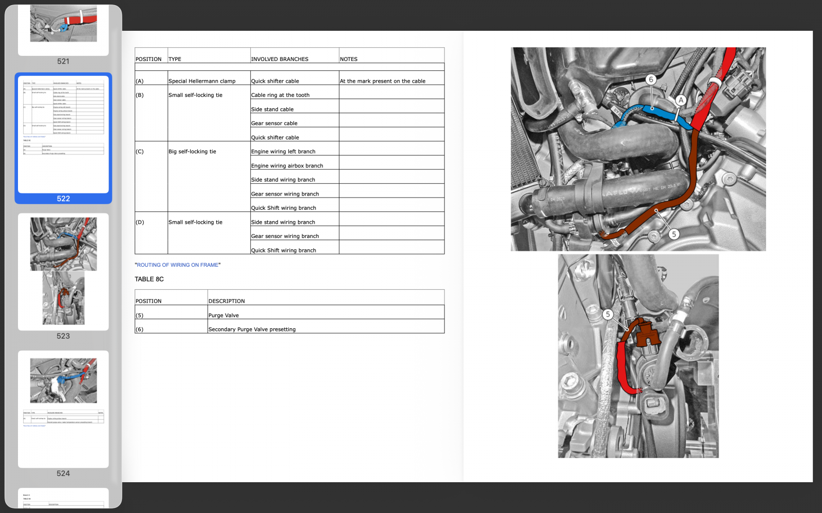

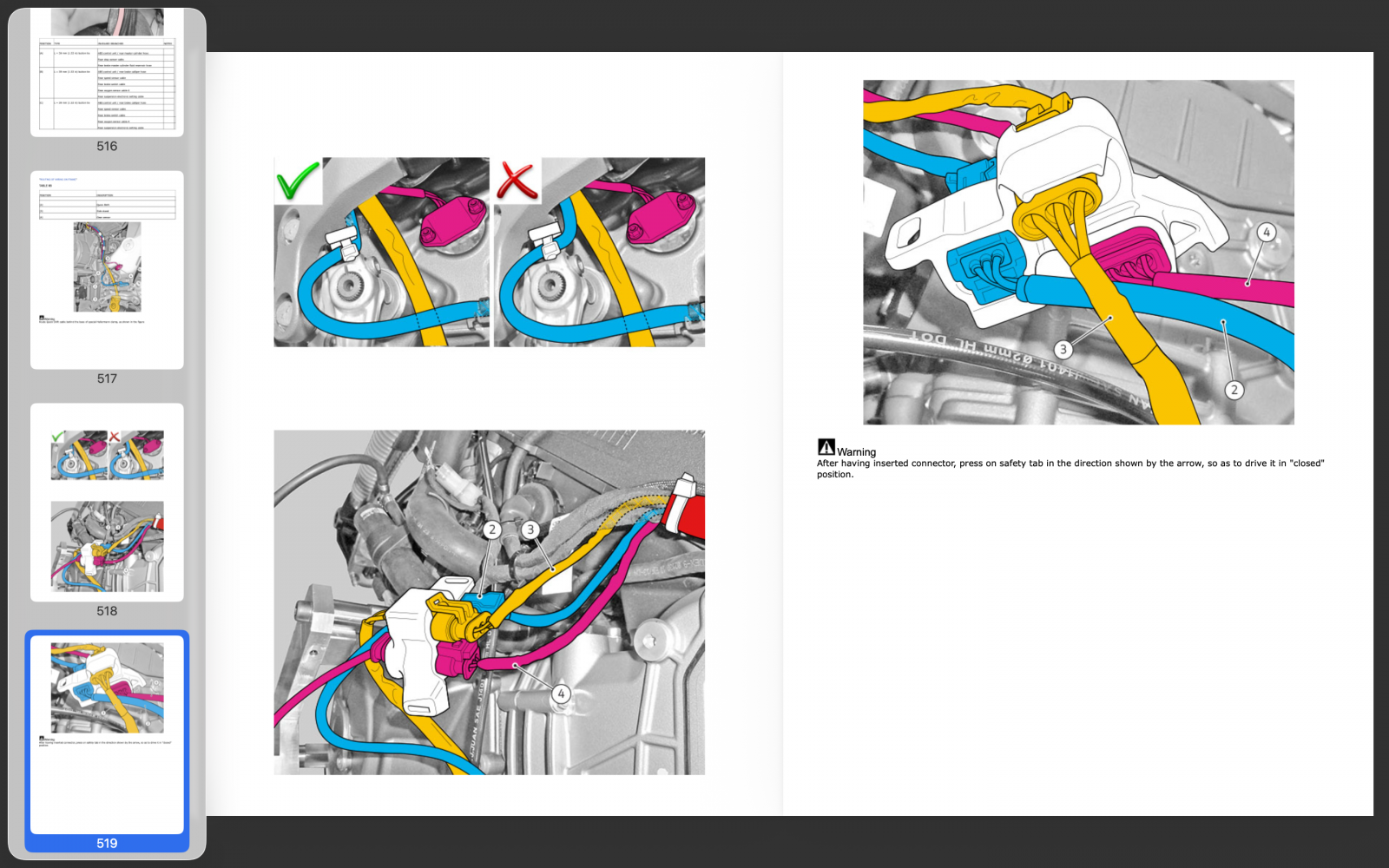

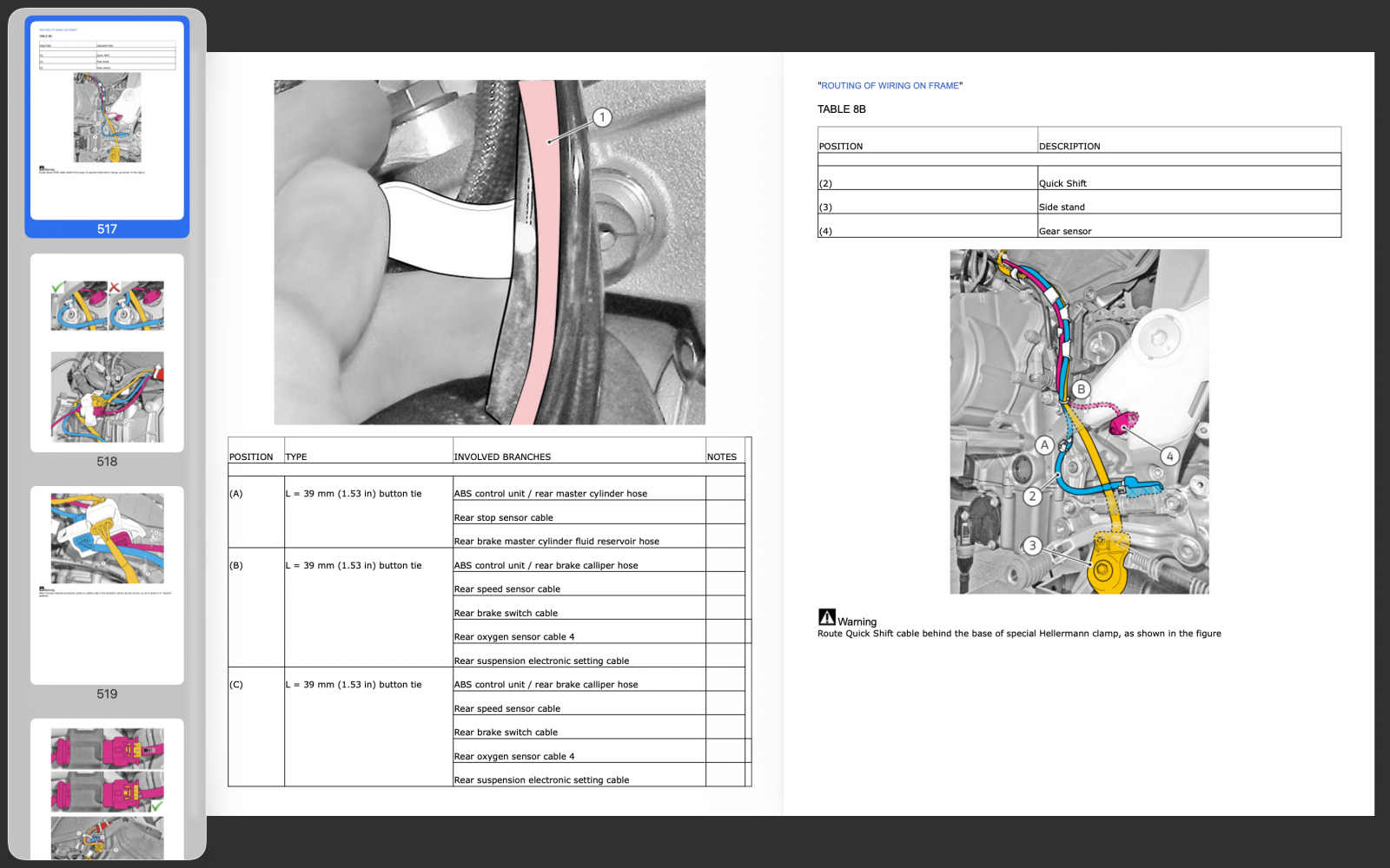

Does anyone know where the plug/socket for the quick shifter terminates? I've had a look but it's not particularly clear!
@gc6269, if you go to the Ducati web site, the 360° picture of the VS can be rotated to show the QS side of the bike. On my iPad, I can copy the image to my library, where I can then zoom into it to it. It shows the cable disappearing behind the frame almost vertically above the gear lever. Andy
It's a bit more complicated than I thought, I'm perhaps thinking of the 1299. These are from the workshop manual, not sure if they'll help, I think once covers are removed it should be straight forward
