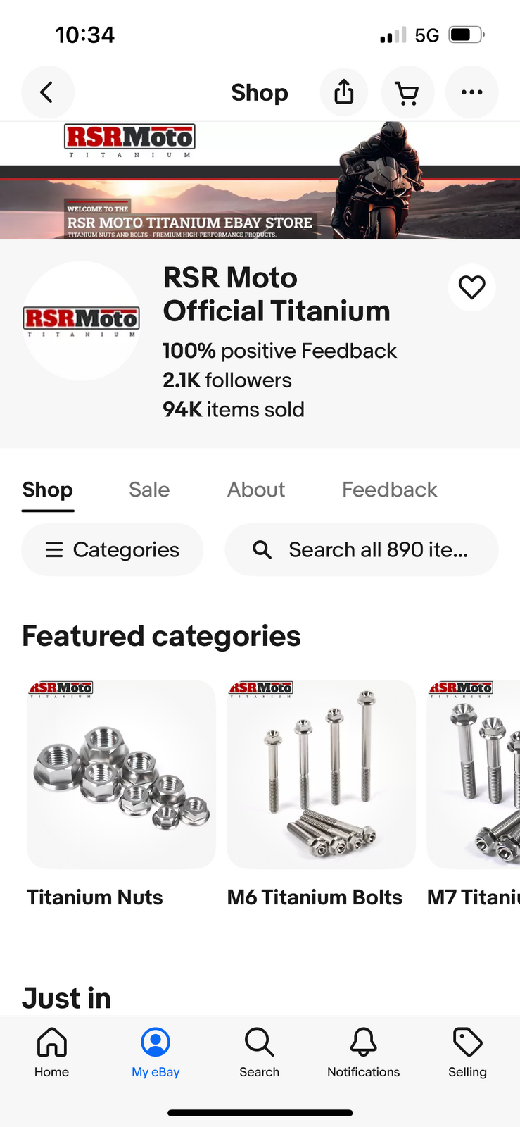

  11. I used these people.
    Collect discs this weekend. Will let you know how I get on.

    I bought replacement titanium bolts from RSR moto as above, all torqued to spec. with no problems. :upyeah:
