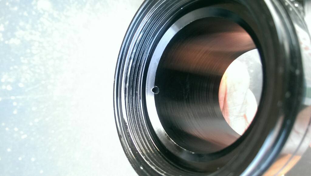

    This bastard leaks. I think it's because of this little bastard hole. Happens with very full tank on hard acceleration.
    Never had a fuel cap like this before.
    Q's:
    Are they supposed to have this hole (must do). Breathing?
    Is something missing?
    Is it just a design fault?
    Do racers only use 2/3 tank of fuel?
    [​IMG][​IMG][​IMG]

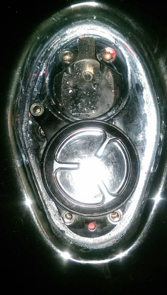

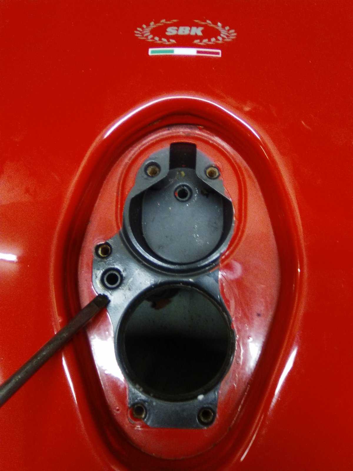

  5. The mounting, in the tank itself, that plate. There is a hole, it looks like a small hole. There is supposed to be some small tube thingy on it. The cap closes onto it.
  6. When the cap screws down it is a long way off sealing the hole.
    Is that hole there to let air IN as the fuel goes down?
    The tubing should be on the inside?
    • Nuke Post Nuke Post x 1

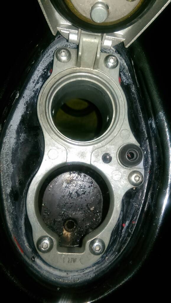

    OK see where I'm pointing to on this 999 tank - there is supposed to be some kinda weird little IMG_20170406_201946.jpg kinda mushroom tubey thing attached to the top of that pipe I'm pointing to. You know the fuel builds up a lot of gas inside the tank innit?

  10. Got something like that on the OEM fuel cap.
    This cap has nothing like that.

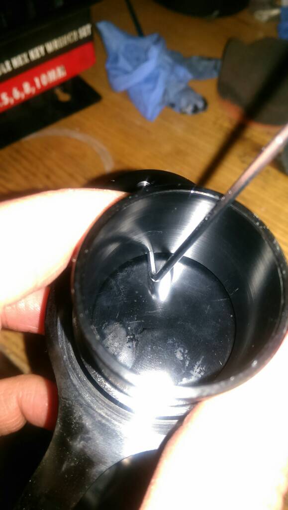

    The screw down cap is way off the hole internally as can be seen with this hex key stuffed in.
    And on the outside
    So it all fits together like this
    And you can see the hole.
    So with a full tank when I accelerate hard the fuel sloshed up and goes through the hole into the well in the tank the cap sits in and sloshes about and then eats my paint.

  11. So maybe there should be a small tube that connects this hole to that vent with the rubber bit? Is that what you're explaining to me?
  12. Yes that what I was trying to say - that ring thingy on your OEM cam goes over that tube in the base. I can't tell from the photos whether you'd have enough room to route a small hose to it. What's also strange is that hole in the filler neck, my guess is that's their way of venting it, I dunno? it's strange because with your OEM vent the gas escapes via that ring/mushroom thing but the petrol doesn't. I guess the tank would have to be pretty full though for the petrol to come out of it.
    What I originally thought was that you'd omitted to fit that ring thing, but even if you did that the fuel would still escape from where it already is... you could see if you could route a pipe to it but then how would the gas escape?? :(

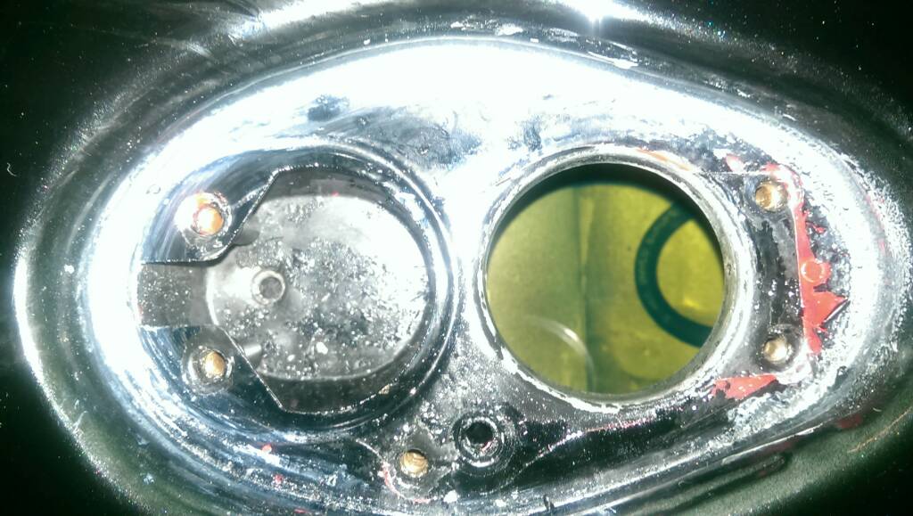

  14. Ah! Is the front tube blocked?? I think the front one is a drain into the tank, when you have had a leak and take the cap off does the front 'well' have fuel in it??
  15. ...so the excess fuel comes out of that hole in your cap, drains into that well and back into the tank instead of out over the front of the tank

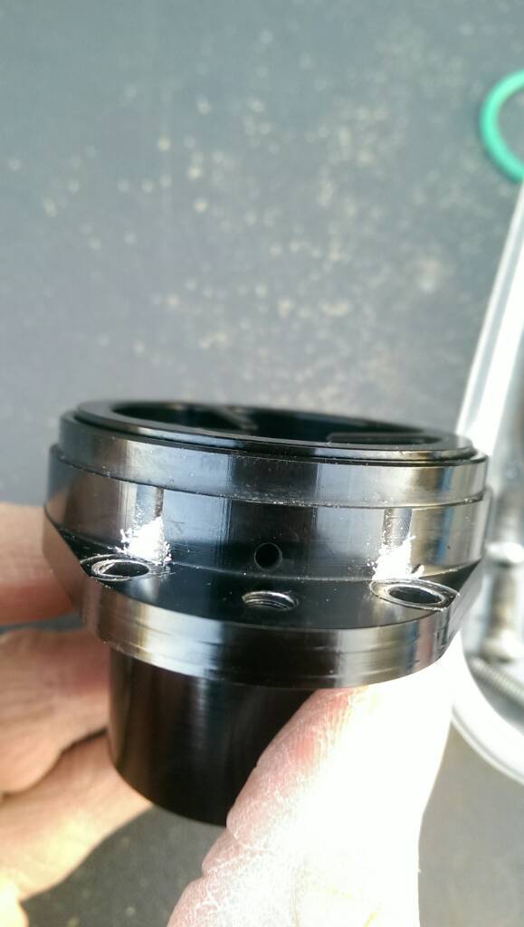

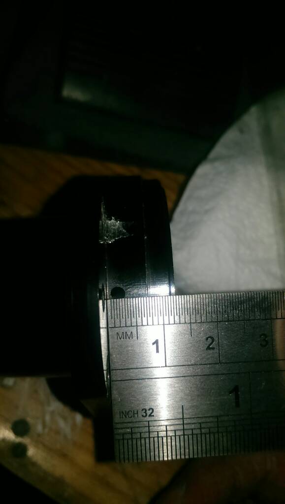

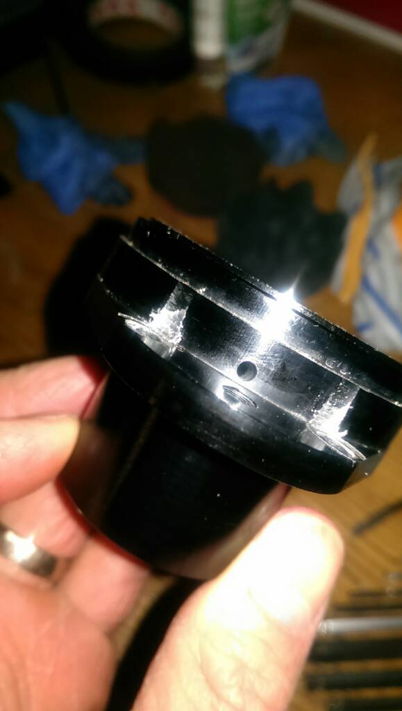

    This is the hole, 3mm I think.
    This is how it fits in the tank.

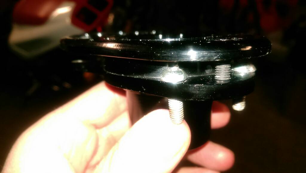

    This is my tank stripped.
  17. As you can see it doesn't block the vent. It's the small hole at the back the fuel comes out of.
