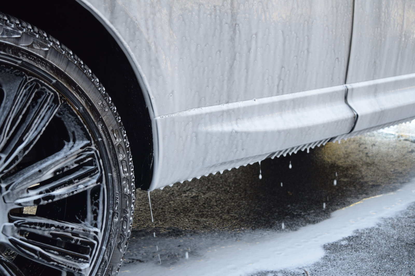

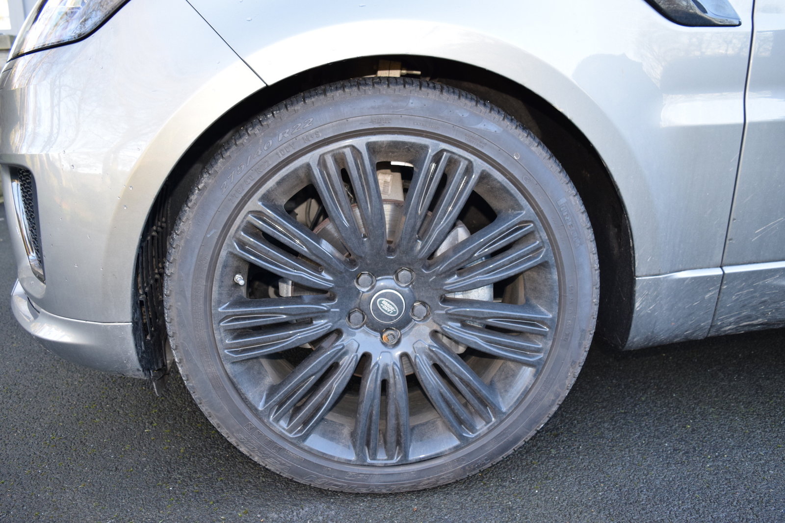

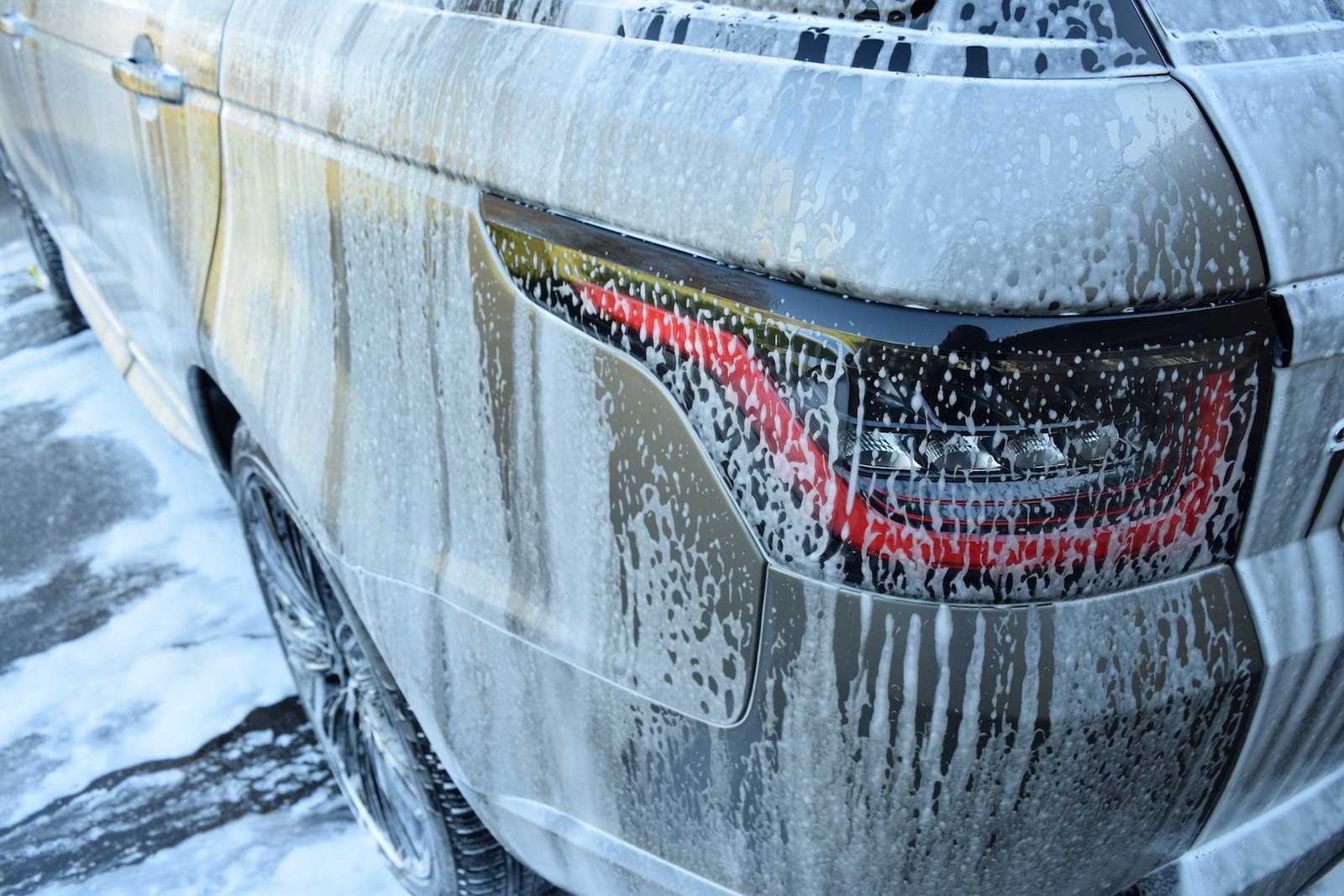

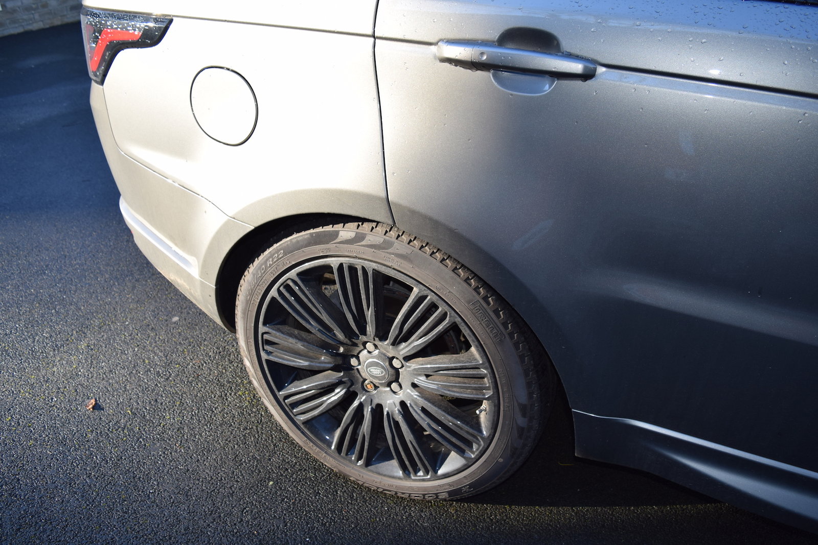

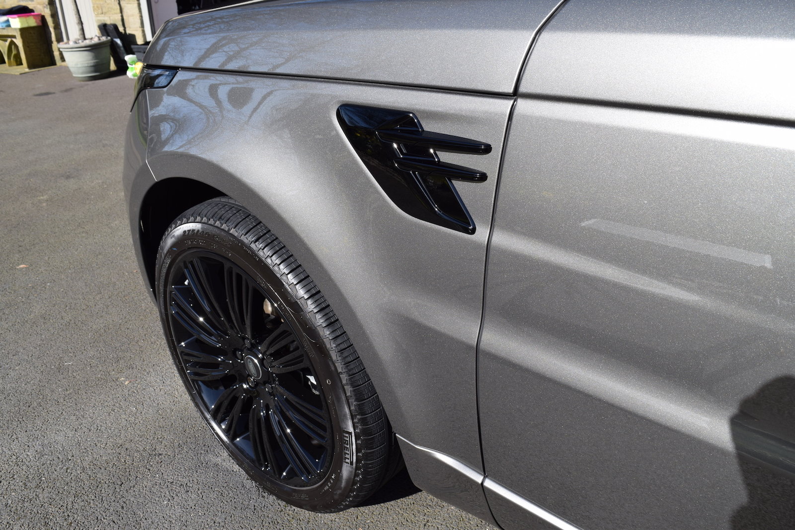

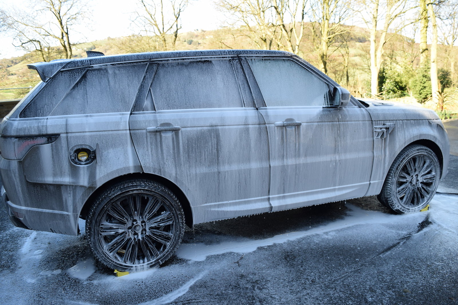

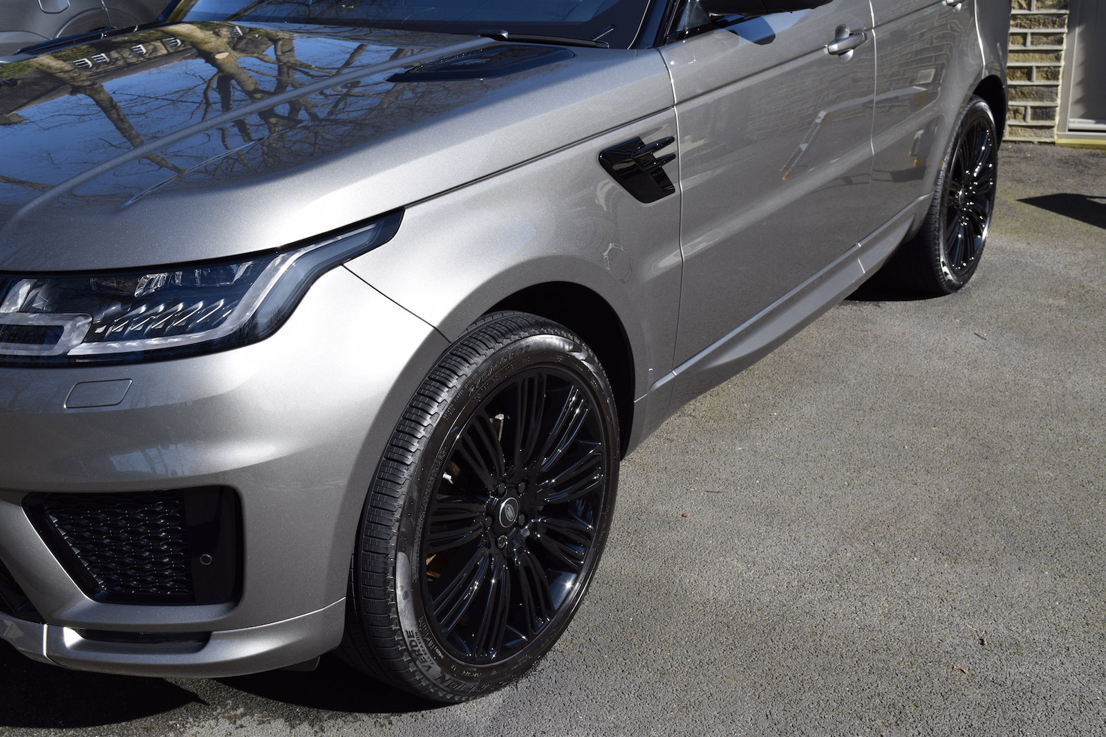

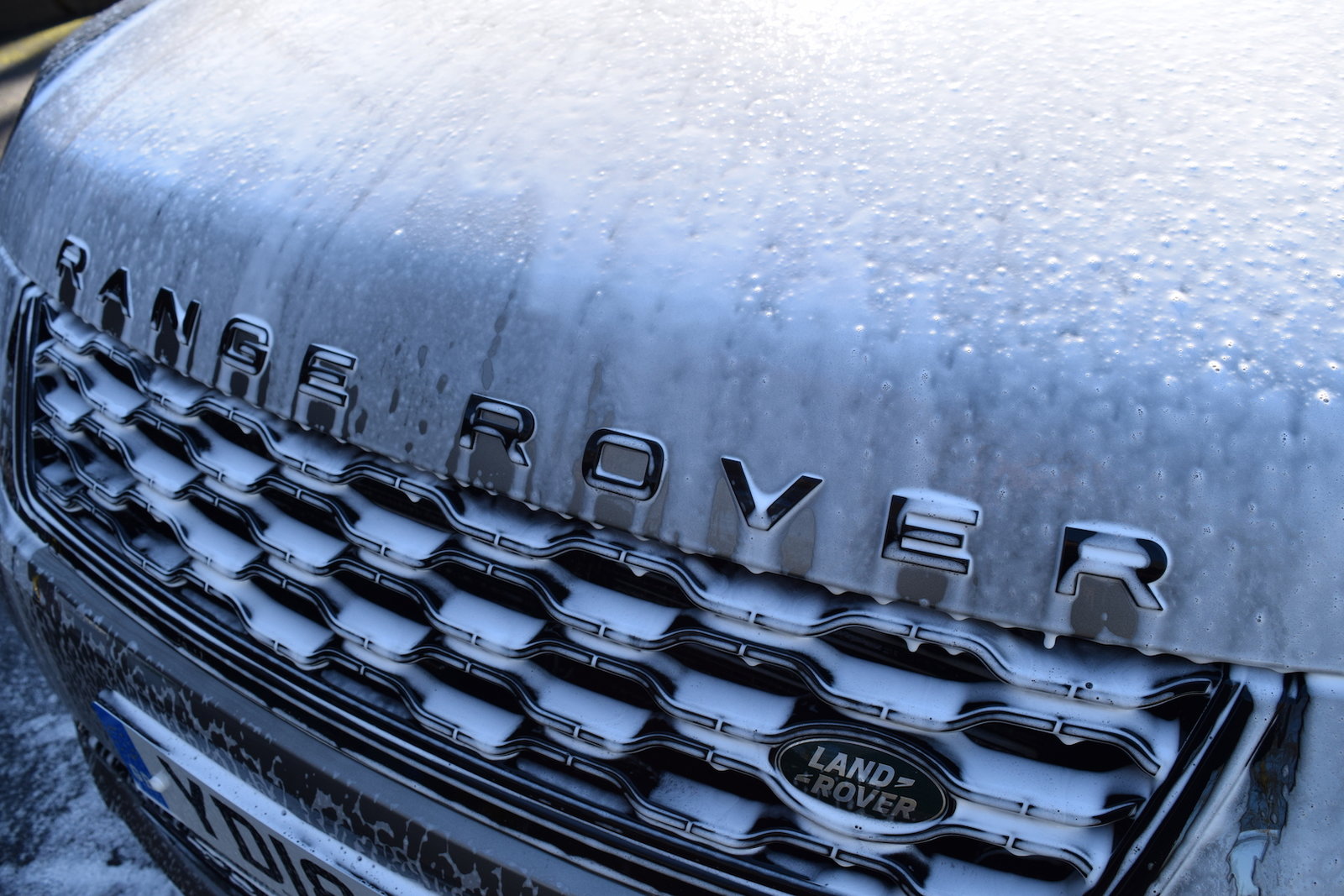

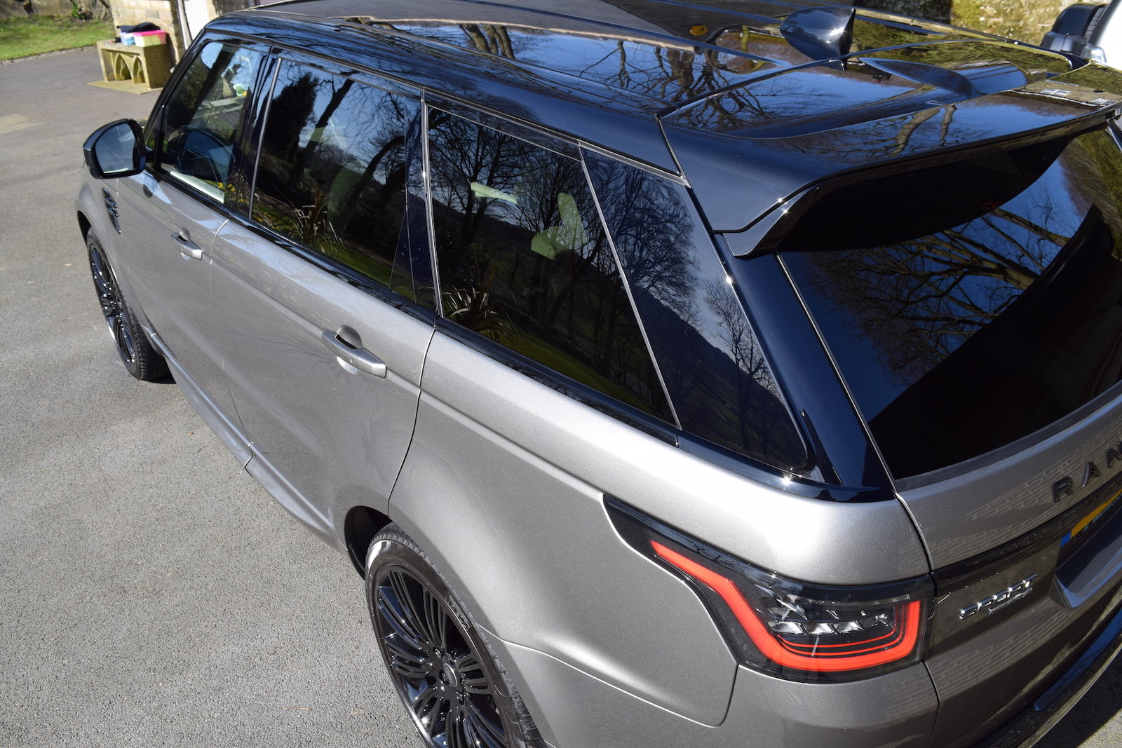

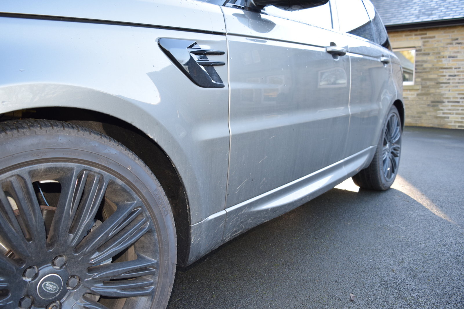

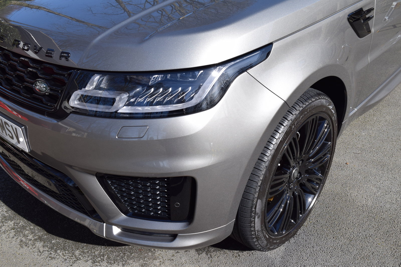

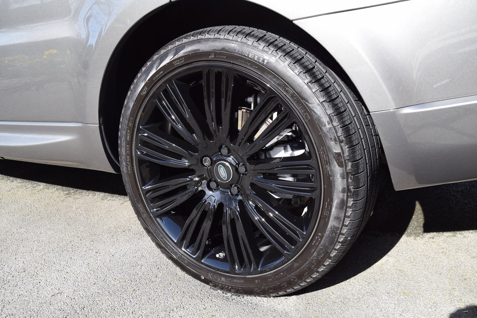

  1. A behemoth of a vehicle. My new car details are specifically for new vehicles with under 500 miles....anything more and they require a deeper clean....this vehicle had just over 1000 miles, and customer agreed to pay for the extra in depth cleaning. First off was wheels attending to with a through rinse of the wheel arches and alloys to remove as much debris as possible before any contact was made.....especially since these wheels were gloss black and I did not want to inflict any wash marring. Arches and tyres were throughly degreased with Britemax Grimeout at 4:1. Then the wheels were generously sprayed with Angelwax Billberry wheel cleaner at 4:1 then left to dwell for a few minutes before I started agitating the dirt with various Wheel Wollies brushes and EZ large detail Brush....they were then each pressure washed off. Wheels again were treated to Bilt Hamber Auto Wheels to dissolve embedded iron - left to dwell then pressure rinsed off. Vehicle was then covered in a blanket of Bilt Hamber Auto Foam prewash ( AMAZING cleaning power ), and all intricate areas, grills, badges, window rubbers etc agitated with a ultra soft detailing brush while the Autofoam was doing its thing.... left to dwell for 10 mins before being pressure washed off...this removes about 90% of the heavy dirt particles prior to contact washing and what only remains is road film. 3 bucket method all with dual grit guards ( 1 bucket dedicated for wheels ), method with Gyeon Essence pure shampoo and 100% pure lambswool Dooka wash pads.....washed with no pressure on the mitt and let the lubrication in the shampoo glide the mitt over the panels....All glass then clayed with claylube as lubrication for the clay to remove bonded contamination. Vehicle then treated to Carpro Tar X to remove bonded tar particles then pressure rinsed off. Next was Gtechinq W6 iron remover sprayed over whole vehicle and left to dwell - dissolving all embedded iron particulates present. It's astonishing how much rail dust is embedded on each and every new car ( liquid turns purple indicating that the iron is being dissolved ). Vehicle then treated to another Bilt Hamber Auto foam bath to ensure all chemicals were removed and again pressure washed off. Wheels finally get treated to Carpro Hydro2 Lite advanced coating and hi-pressure rinsed - this hi-pressure essentially ' shocks ' the Hydro2 molecules into bonding onto whatever material its sprayed on. RR Dried using filtered warm air vehicle dryer. Whole vehicle was then panel wiped down with Gtechniq panel wipe to get a true indication of the paint prior to machine work. Whole vehicle then Machine polished with various Rupes machines and Bilt Hamber Cleanser Polish - remaining film left to cure for 10 mins before being removed. This provides an superb base for the last step protection. This is an outstanding paint cleanser and all in one.....Finally an application of Wowo's amazing Liquid Wurtzite Boron Nitride *Nanocoat - this will provide outstanding durability for 12 months. Glass cleaned with Angelwax Vision and tyres dressed with Gtechniq T1 tyre and trim. Exhaust tips polished and protected. Time taken 9 hours....( 10 min break for a snack )

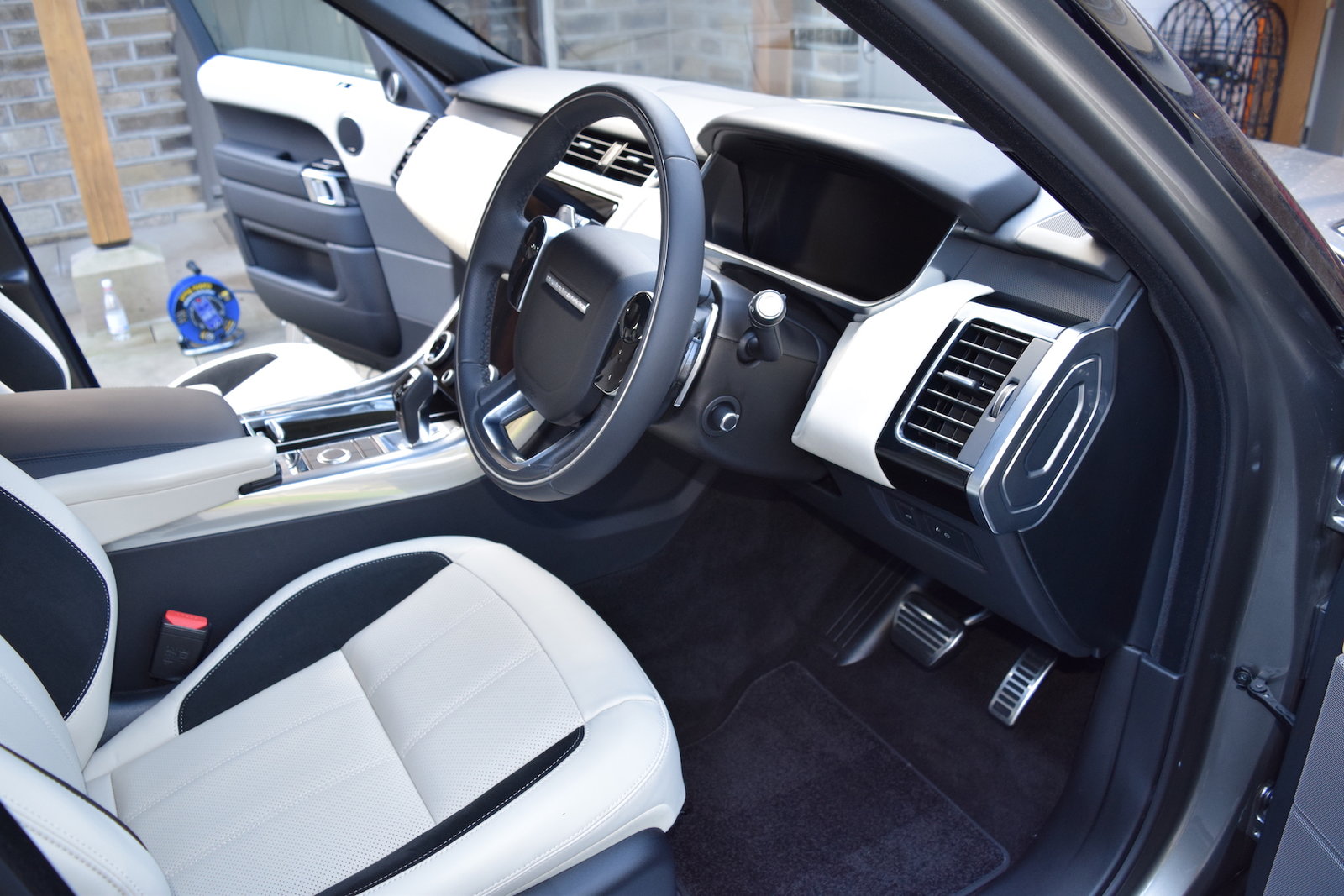

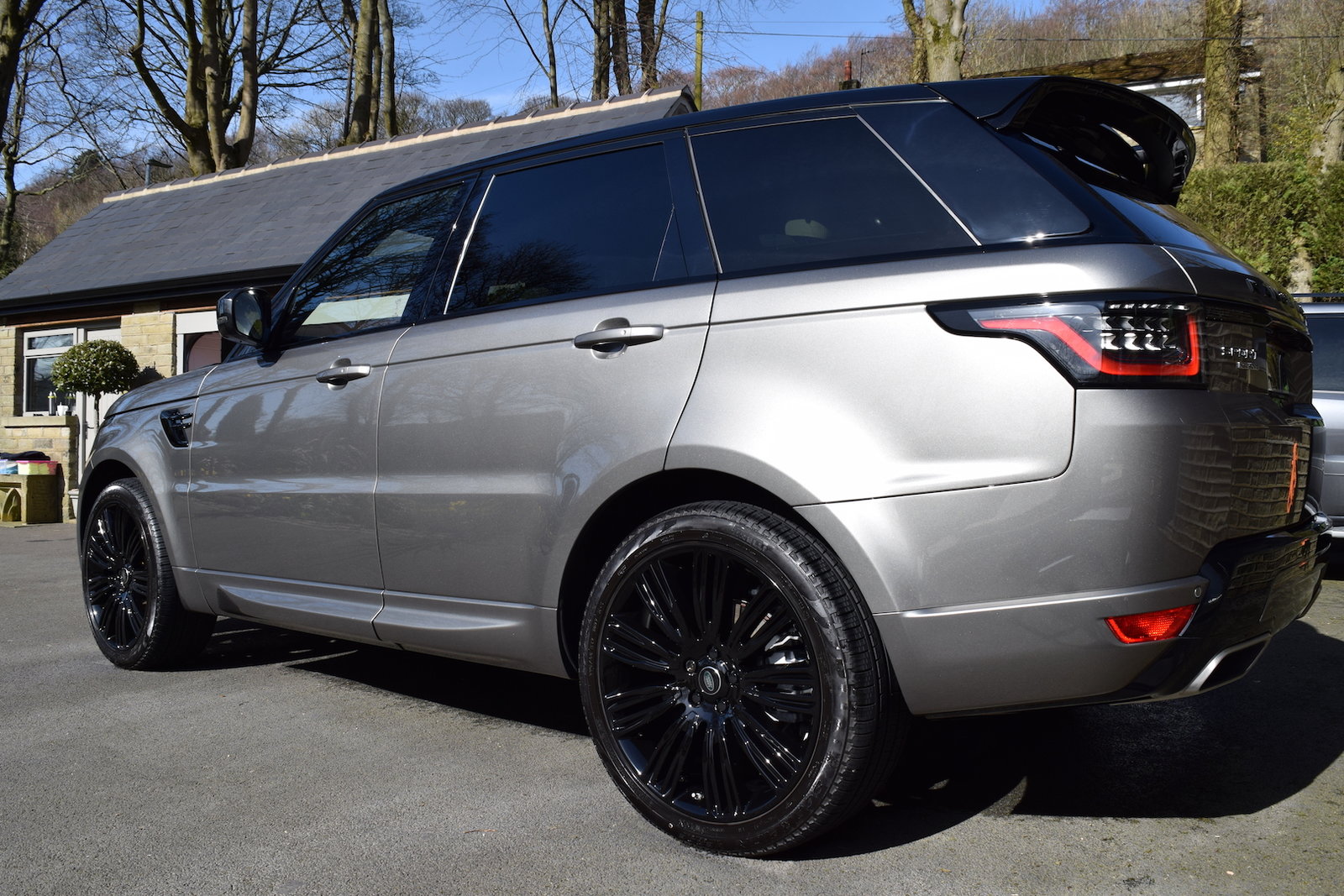

    Customer was very happy indeed....was a great day to be working out in the sun!!! Interior Received a full Gtechniq interior protection package the previous day which took 4.5 hours.

  15. Buddy....Bilt Hamber Auto Wash....SIMPLY NO EQUAL....I've trialed loads and NOTHING comes close to this stuff - Honestly!!!!.....this stuff cleans like nothing else....Don't expect lots of shaving type foam tho...its not formulated to do that BUT in order for it to work as designed you need to get the Panel Impact Ratio correct at 4-5%.....so you must do the following in order to get the dilution correct ( do not think you can put an inch of this stuff in your bottle and it will work...it won't )...so: You need to fill you detergent bottle full of plain water. Turn the detergent feed on full then discharge the lance into a container - keep going until the detergent bottle is empty of water. Measure the total amount of water collected in your bucket. Work out 4- 5% of that - this is the amount of auto-foam you need to use in your bottle.
    I use 440ml in my bottle using a Kranzle K10....also a little tip here....For Auto Foam to work you only need to ' wet ' the panel so don't go over it again and again as you are only wasting product. I can get 2 large vehicles done out of one bottle. Hope the above makes sense & be nice to know how you get on. Get the BH AF from Polished Bliss ( Free Delivery )...Cheers oh and before I forget the ONLY product I buy from Autosmart is Biobrisk which I use on heavy biological staining and its a great product for this....
