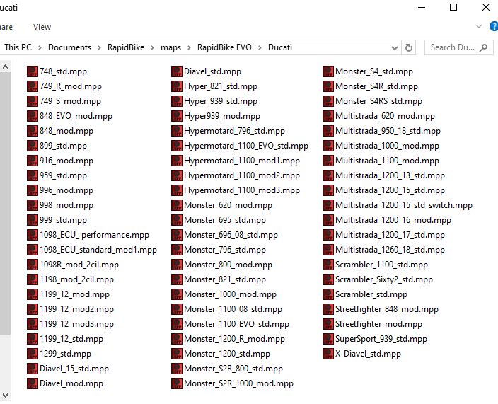

  5. The Rapidbike evo can be moved between bikes - but as you say you need the bike specific loom.
    The looms for the 899, 1199, 959, and 1299 are the same though so you can buy a used one that has the map for any of those bikes and swap it.
    The basic map can be loaded using the Rapidbike Master Free software - it comes with maps for all bikes.
    However, the dealers have Rapidbike Master Pro - and you need that to reprogram the module to your specific bike.
    You can send the module away to Performance Parts ltd and they will reprogram your unit for about £30.
    That being said - I have a Rapidbike Evo that is programmed for an 1199 on my 959 and haven’t bothered to send it away as I have simply uploaded the map file using the free version of the software.
    The Evo only adjusts fuelling which is what the map contains and the rest of the parameters are the same across all of the that series of bikes so as far as I can see I would be paying just to have the name changed.
    I wouldn’t do this with the race version as that has bike specific ignition timings but unless someone can tell me different I think you can swap an Evo between any of the 4 bikes and just upload the map yourself.
