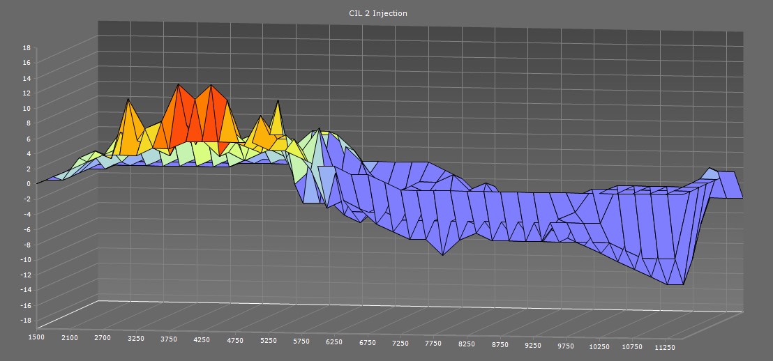

  1. Have done about 400 miles since fitted the RB module now. Bike has full Akra system. Comparing these to the standard map shows just how much the RB seems to be enriching the mixture around the 3.5 to 5k range. Bike certainly runs smoother with it.
    Anyhow, others might find it interesting for comparison.

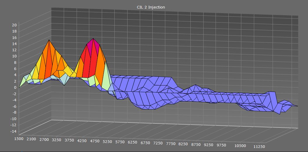

  3. Very similar on my 1199 as well, this was after a tour to Normandy with Termi slip on's and up map cyl 1.JPG cyl 2.JPG

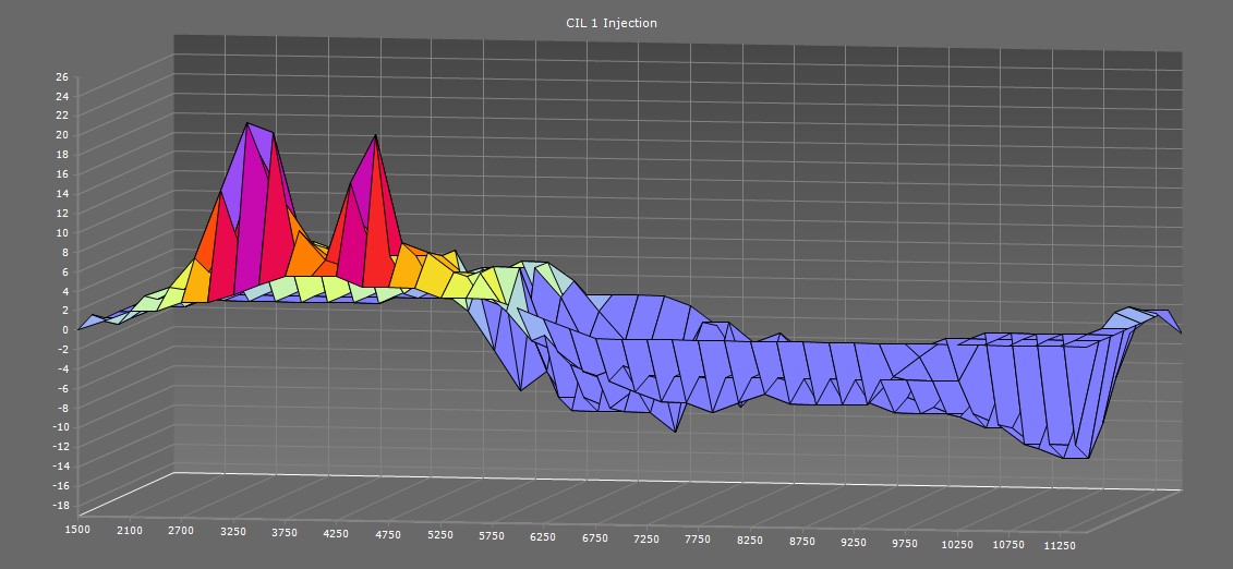

  6. Totally forgot to look. Here from the one that was on my 959, and the adjustments it was making.
    3F983855-E810-440D-BCE4-74EDA862B06D.jpeg D189CDC2-4AFD-4186-90BF-7C9D1013BF24.jpeg

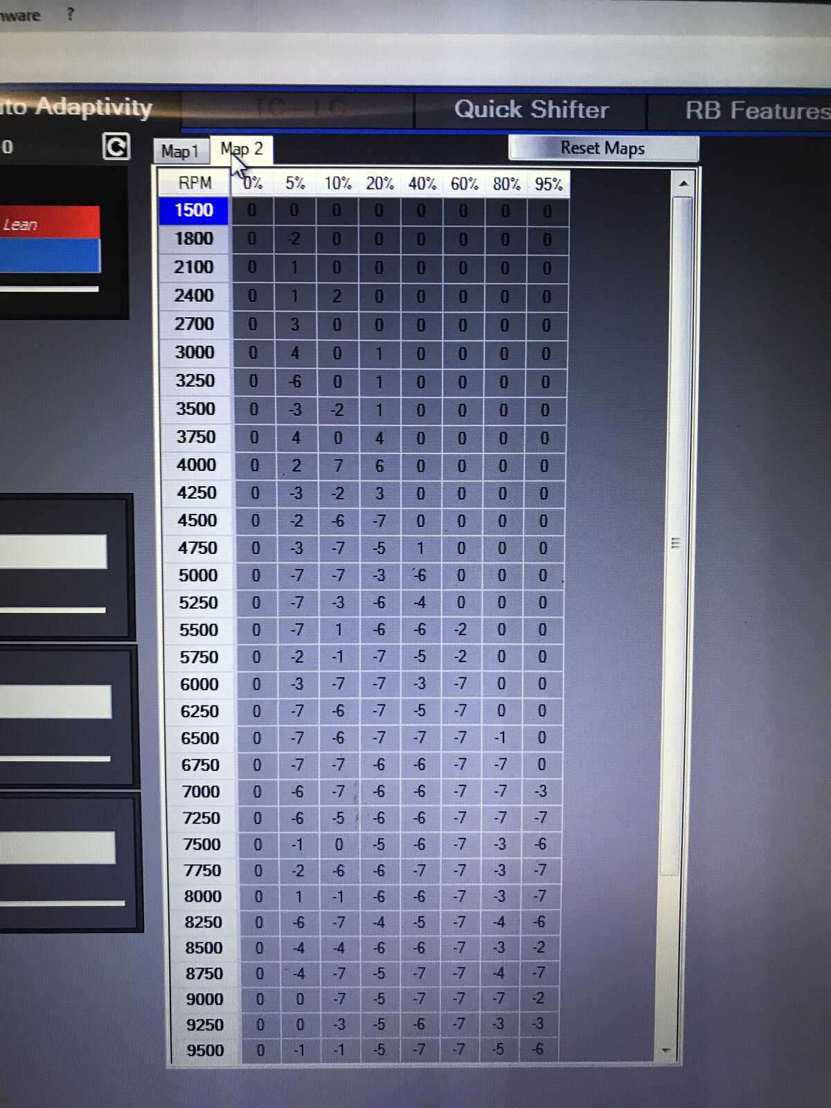

    Today I sent the adapted table to the main table so will see what changes it makes from here.
    69E55545-3B0D-40A6-9D9C-80C9BA9B9701.jpeg 71F7B43D-86B9-4832-9547-0D6AEC14524C.jpeg 896B6381-D33D-48A5-AECC-7AE2E0994BAF.jpeg A6EA5860-DE41-4529-B107-39912AEAEBD5.jpeg
  8. thats a big variation from 2 cylinders?
