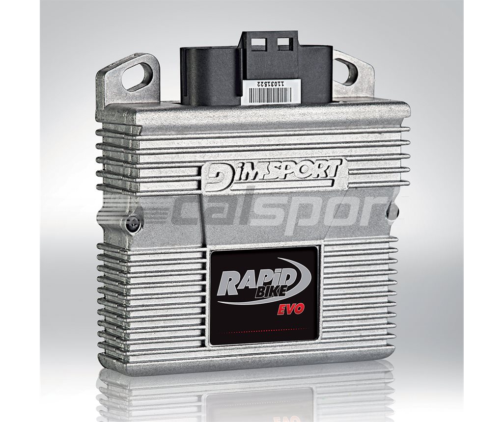

  1. There seem to be placement issues with the Rapidbike unit on the Multistrada 1260 to be clarified. As an option to the suggested placement location, 1200 owners were able to install the unit under the pillion seat. However, for whatever reasons, the 1260 Rapidbike harness does not seem to be long enough to permit this location. Please share your installation solutions, photos and correspondence with Rapidbike.

  6. I understand. The Rapidbike unit is a fuel controller for those that have modified their exhaust and/or intake.
    It re-balances the Air/Fuel Ratio to compensate for the extra airflow. It's also one, if not the best, unit available for Ducati.

  8. #8 DarR, Aug 19, 2019

  10. I have a 1200DVT and a Rapid Bike module installed in the small space under the pillion seat as I couldn't fit it inside the faring where they suggested. Surprised the loom would be much different for the 1260 model.

  12. It's shorter and not enough length to put the module under a pillion seat.
    I've sent all pictures to US distributor (Yaman) and he promised to notify the manufacturer. I hope, they'll come up with a revised harness.

  17. I have a Rapidbike unit pulled from my Panigale that's earmarked for my 1260. The unit is a brilliant piece of hardware with accompanied software. It learns and is customizable. Did wonders on a stock Panigale as It was previously difficult to keep a steady throttle at lower RPM's while in sport mode. The RB removes this lean surging. It's a must for those replacing the exhaust and especially those combining the said with liberating the intake with a high-flow air filter.
    I'm just waiting for the opportunity to have it re-programed, purchase the harness for the 1260 and install it once I disable the exhaust valve.
