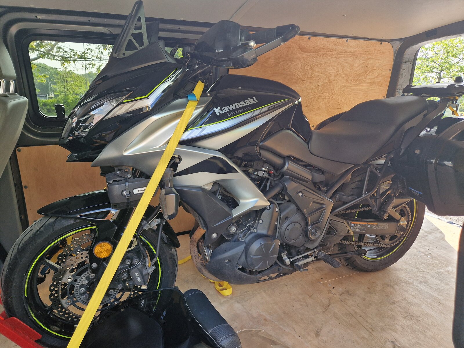

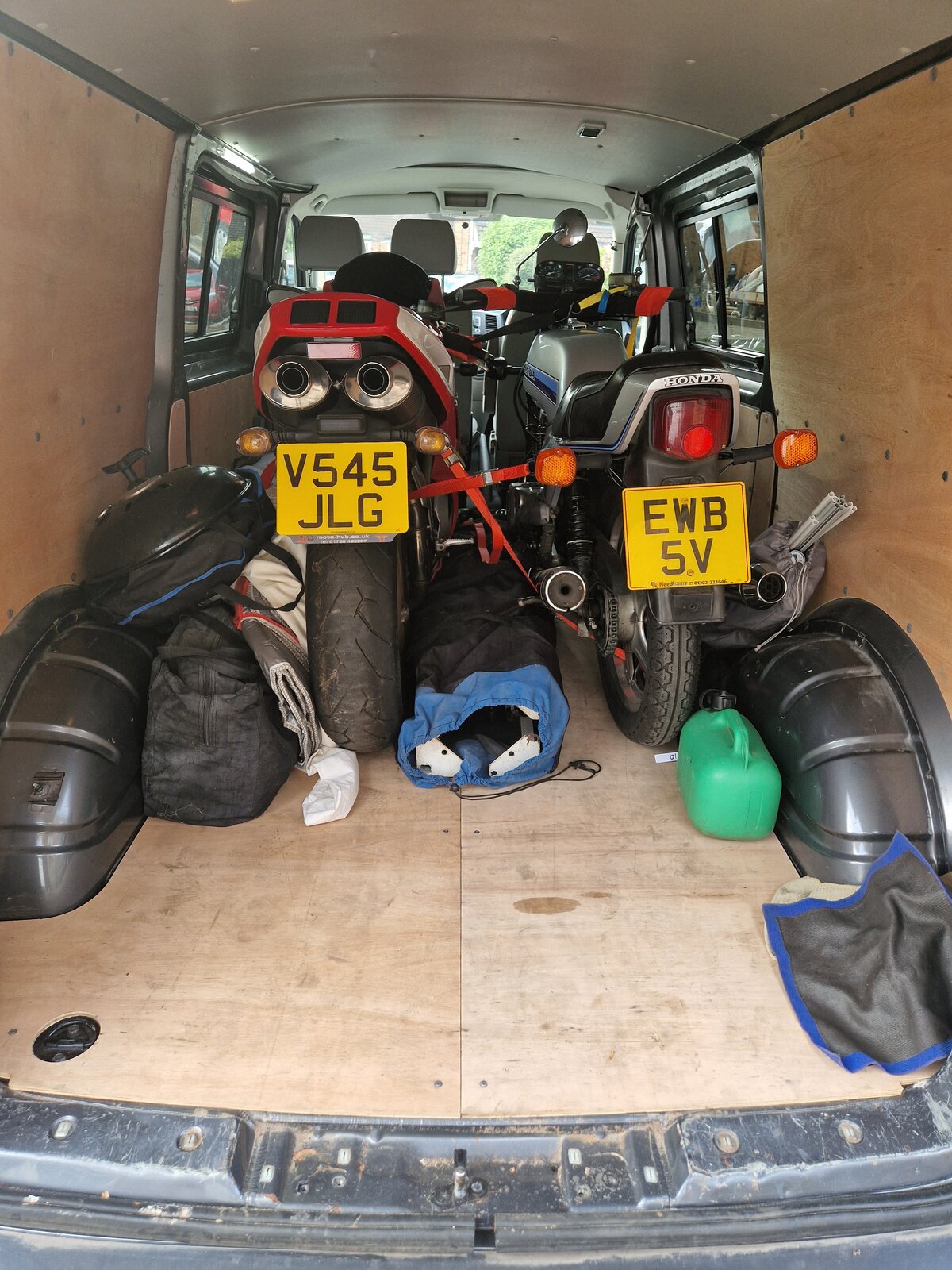

  1. Anyone got any recommendations for either. Early stages of getting stuff for my yet to be bought van. Dont mind paying more for stuff made in EU or UK
  2. Get a chock that will hold the bike up while you strap it down
  3. Oxford ratchet straps, which have a full “S” hook rather than a more open hook…. if that makes any sort of sense?
    The Oxford ones also have a loop on the ratchet end so that you can use that to go around the frame, rather than having to use the open end and having the ratchet at the bottom. Not particularly cheap but feel nicely made

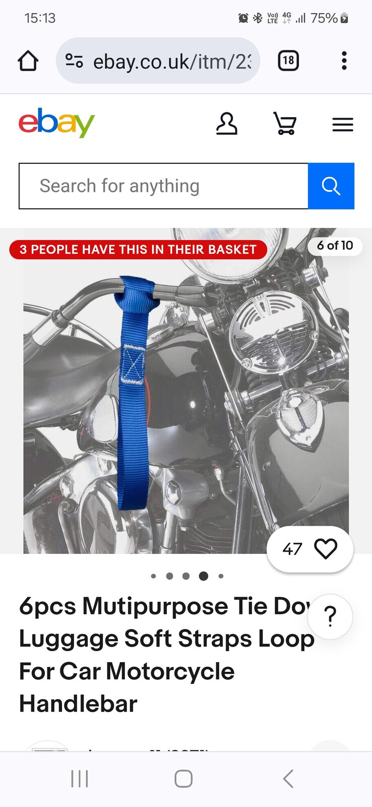

  4. https://www.ducatiforum.co.uk/threads/lift-bench-wheel-chocks.86028/#post-1840779, the link at #3. IME, ratchet lashings can be excessive, I use cam buckle straps, this is just an example of what’s out there, https://slingsandstraps.co.uk/product/cam-buckle-tie-down-straps/. I dislike the handle bar straps, you can over compress the forks, potentially causing seal failure. Andy

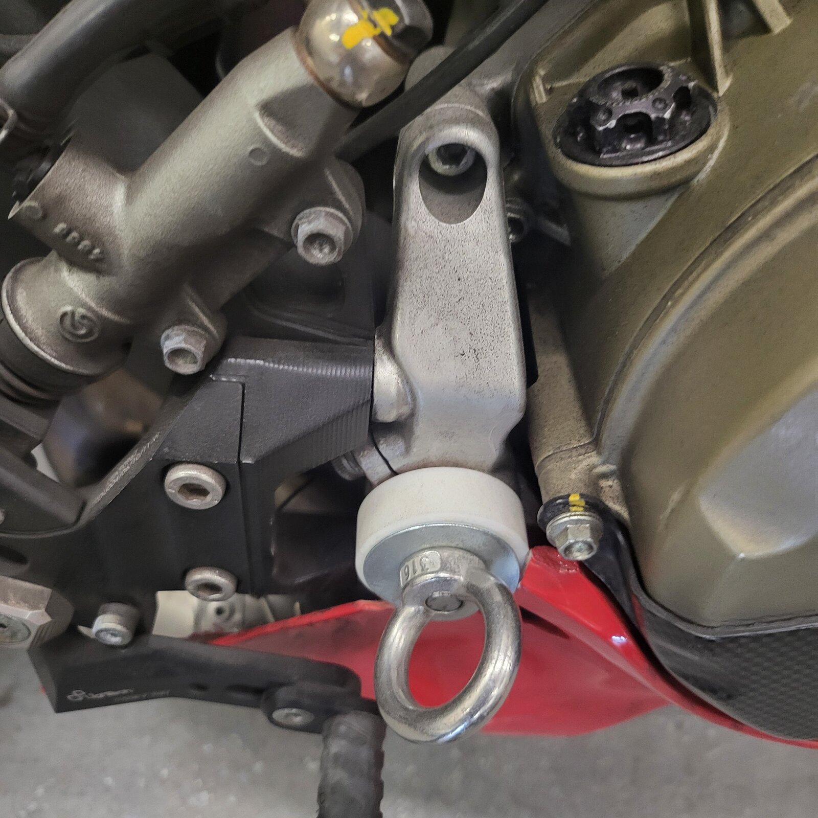

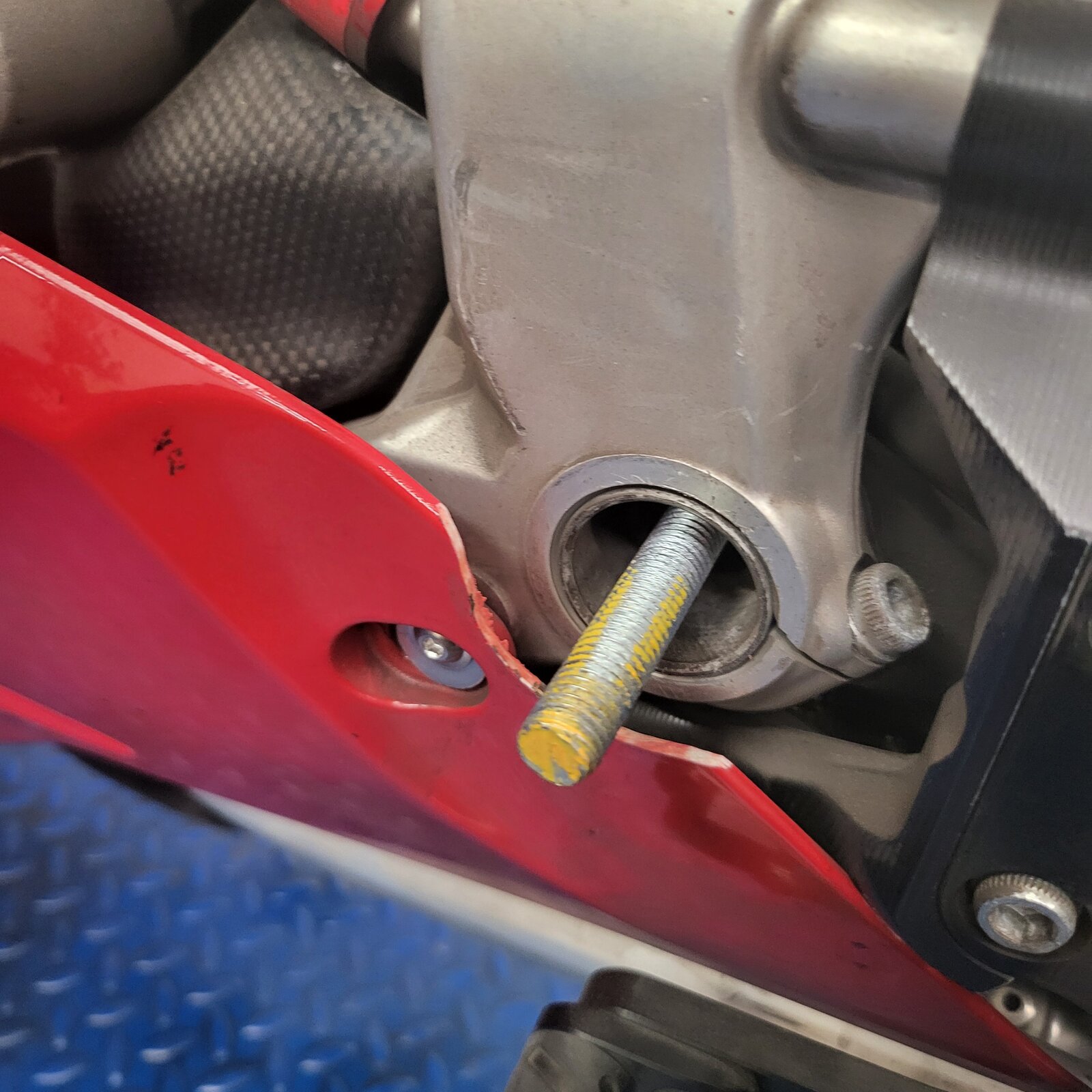

  5. For securing have you thought of the rod through the swingarm pivot with eye bolts either side? I made my own but there is a guy on Facebook who makes them for all sorts of models

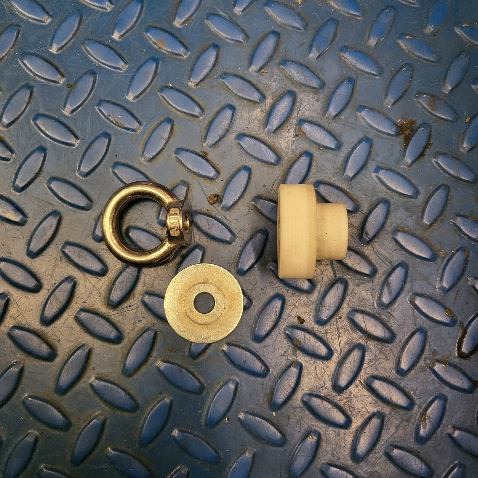

  7. What parts did you use to make that mate.
  8. M10 stud bar, 2 stainless eye bolts to suit and some PTFE bar I machined to fit into the pivot holes
  9. Might give that a try thank you.

  16. Got most of the bits now, ordered from Mid Fix for a site i am working on ha-ha. just need the sleeve bit now.
