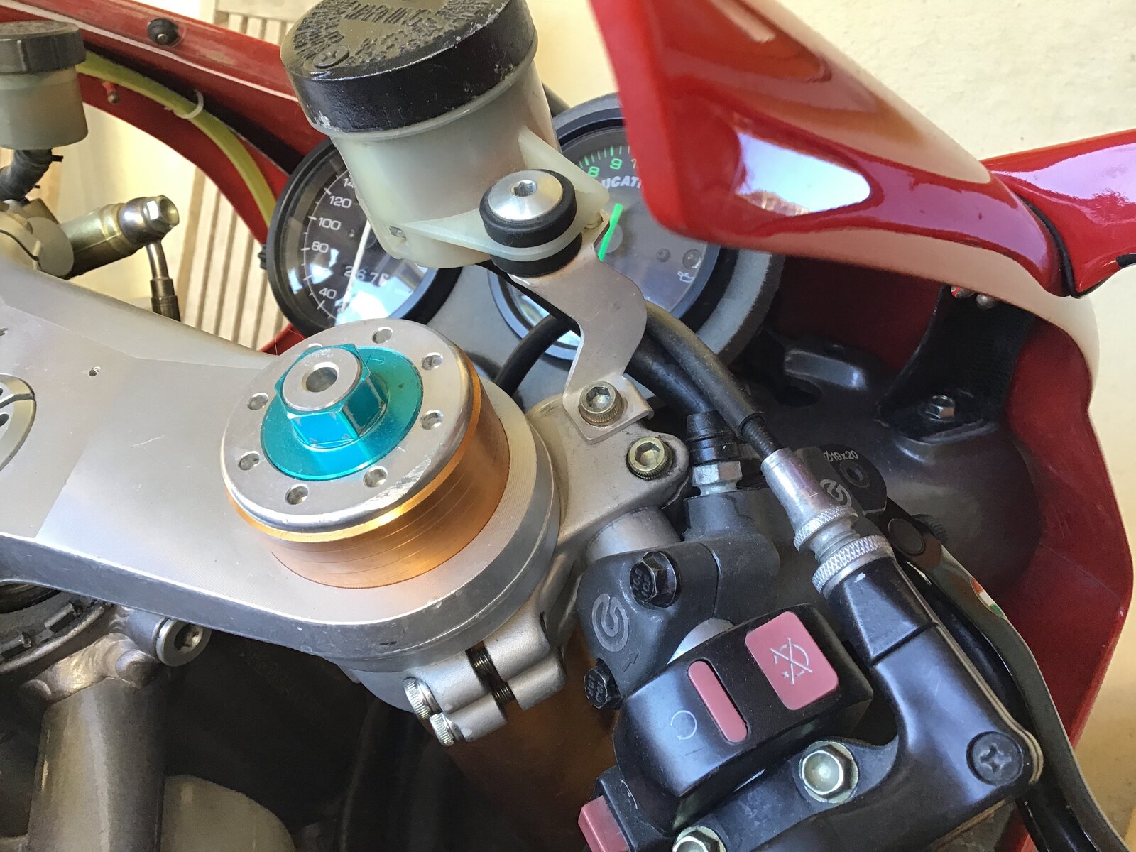

    I have bought the brembo RC19 brake and clutch. But i have made something to mount the brake and clutch fluid cilinder what i think it is not very nice. Do you have other nicer Solutions maybe??

  2. We'll done. Looks good! :upyeah:

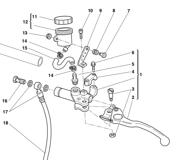

  3. you need a rubber grommet to dampen the vibrations.... i copied the previous ducatis 998 999 etc
  4. Thanks☺️ But i think it is not very nice haha. Was looking for something in Carbon or so
  5. Sorry what do you mean?
  6. copy how it was done on the standard ducatis...No 8 is a rubber grommet
    you could also put a line of decorative holes like the standard part has...

  7. You could use the ends of the clip on bars if they were capped or drill into the front face of the top yoke?
  8. Sorry for the late respons! But sorry wat do you mean?
  9. I think i should use that indeed! It is hard to find a nice solution, i thought there was a standard product for it but there isn’t

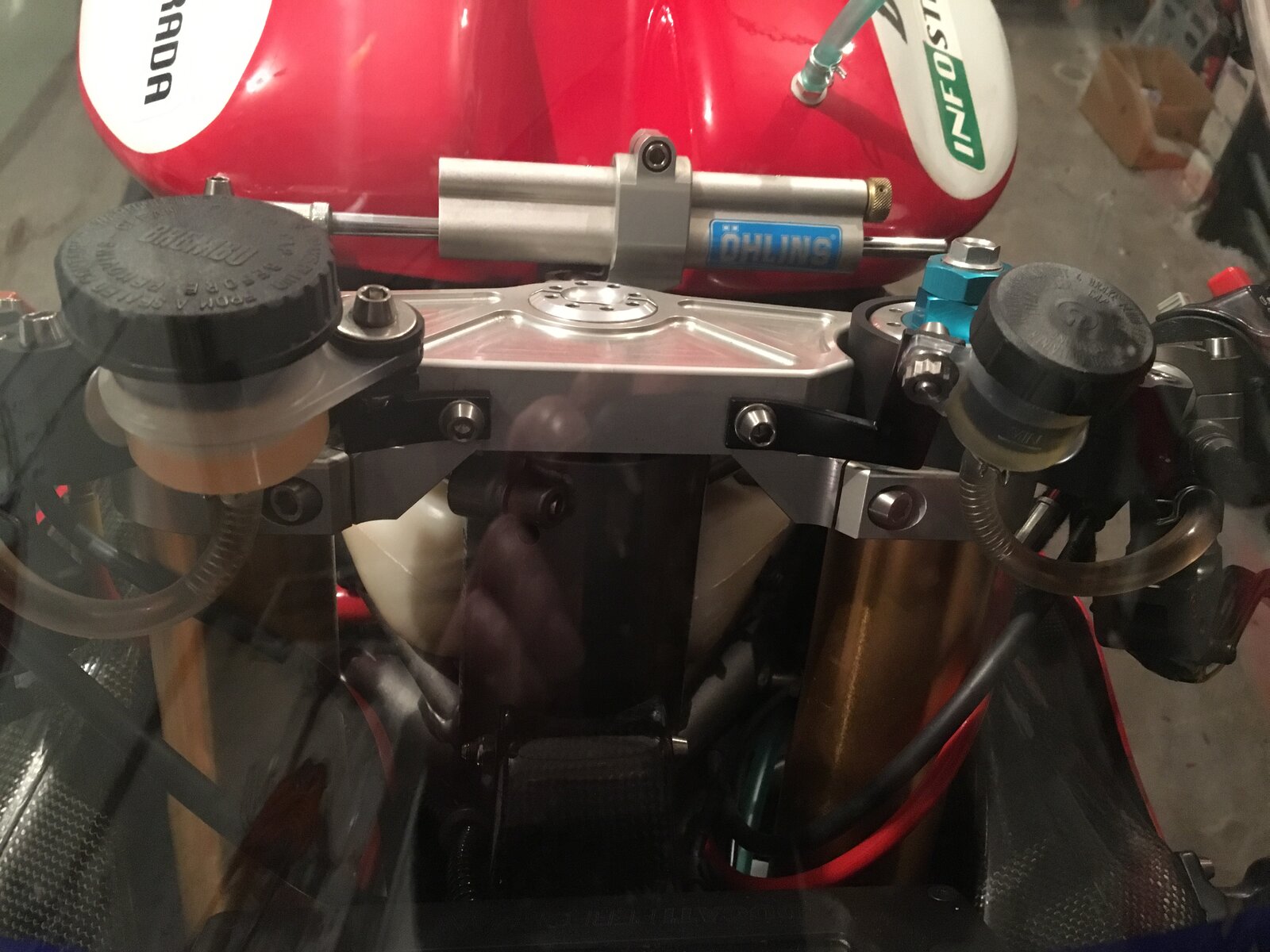

    Here (with the factory parts)?
