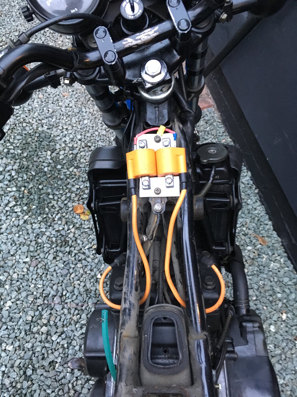

  1. 7C19942F-81F0-4ED4-B046-89F9352593C4.jpeg Purchased a Swiss RD250LC a few weeks ago.
    I was going to turn it into a hybrid but had a change of plan, now it’s going to be a wipe over and replace just to get it road worthy.
    So far I’ve added a front tyre, the rear awaits fitting. I’ve taken the front calliper off seized piston awaiting repair I’m hoping it’s just crud underneath the seal holding hard on the piston my Son’s trials bike brake did the same.
    The carbs have been cleaned by my local indie mechanic, renewed the fuel lines and balancing pipe. After this it started 3rd kick, I just injected pre-mix into the float bowls as the tank is off the bike it ran until the bowls emptied. Next is to check the oil pump works.
    Also handlebar grips have been taken off they were ghastly foam grips.
    I’ve also today replaced the original coil with twin Banshee coils as pictured
