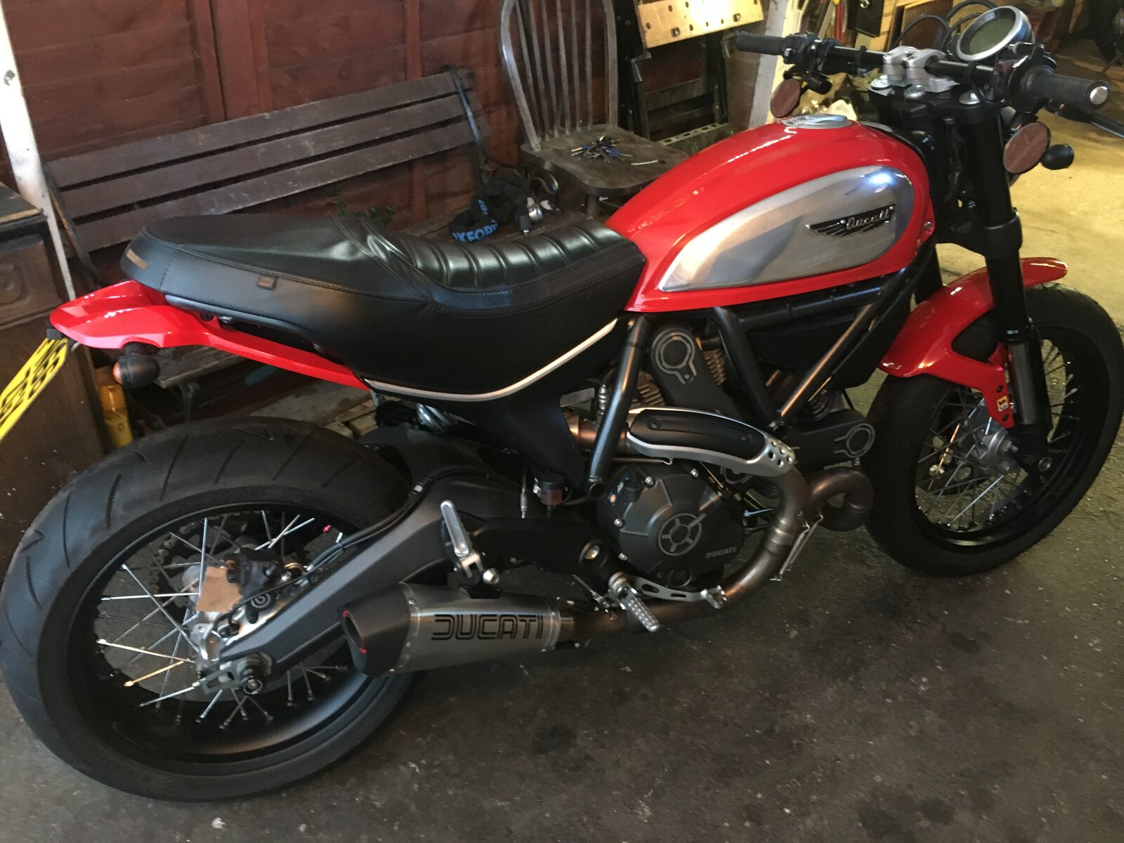

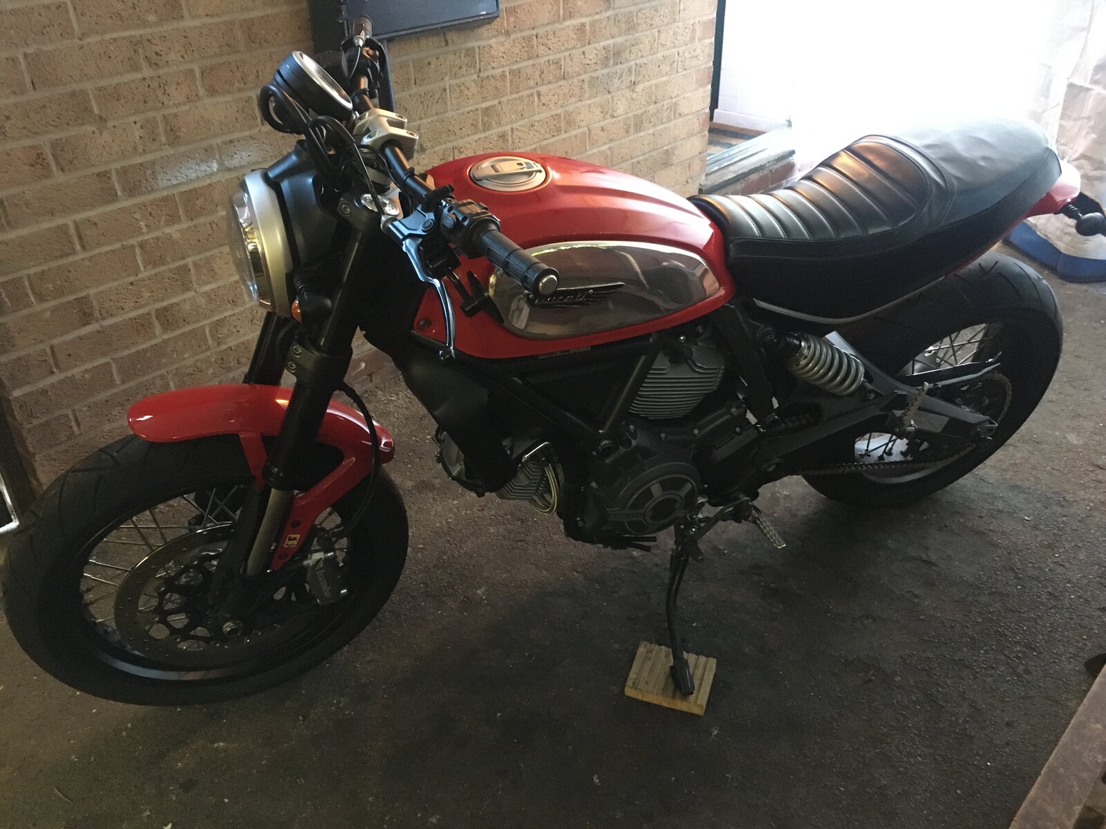

    Hi Derek, yes I agree, it’s just not worth the hassle trying to get this one off as much as anything, in fact I just got hold of a phonic wheel for £15 so I just need a disc and bolts now, on a brighter note I am liking the look of the spoked wheels on the bike, probably look even better with scrambler tyres but I want to try it on these road tyres first 5B134ED9-3A9A-43E4-9784-E728E42CDE7E.jpeg

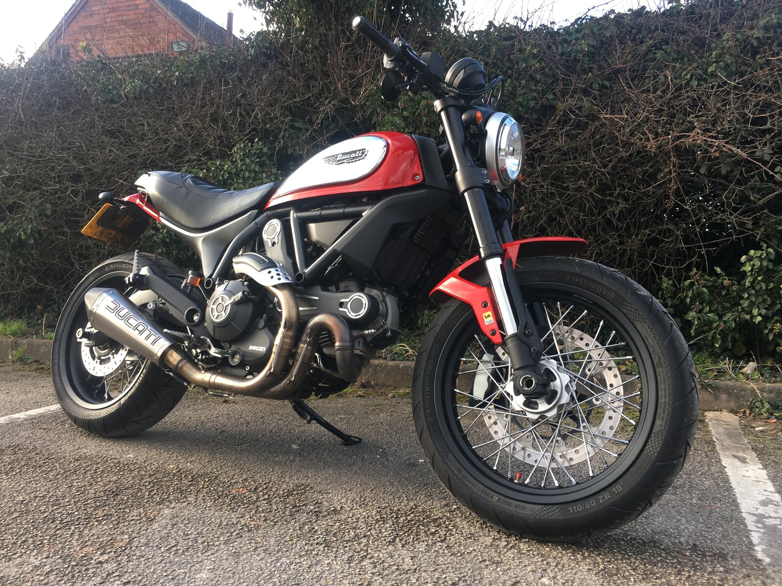

  14. All back together now and went for a spin, I can feel the extra weight in the front wheel above 60mph, the bike feels more stable in a straight line, which is a good thing, I can feel more resistance (centrifugal, or is it centripetal!) when banking the bike at that speed also, not massively but it’s there, what I can’t figure out is the front of the bike feels higher!, I didn’t have time to take any measurements but it definitely feels higher , the continental is a 110/80 same as the MT60 so that’s surprising but I guess the profile could be different, I’ll check it out properly tomorrow, might have to drop the forks through the yokes a few mil to get the old riding position back, all in all though I’m pleased with the swap :)
  15. It's the gyroscopic 'resistance' (to steering-axis rotation) that you're feeling because of the greater front-wheel rotating mass.
  16. Yes, that.
  17. I’ve got my old riding position back, raised the back approx 5mm, would’ve raise it more but only had 1 click left on the adjuster and lifted the forks through the yokes about 4mm, just nice now:)
