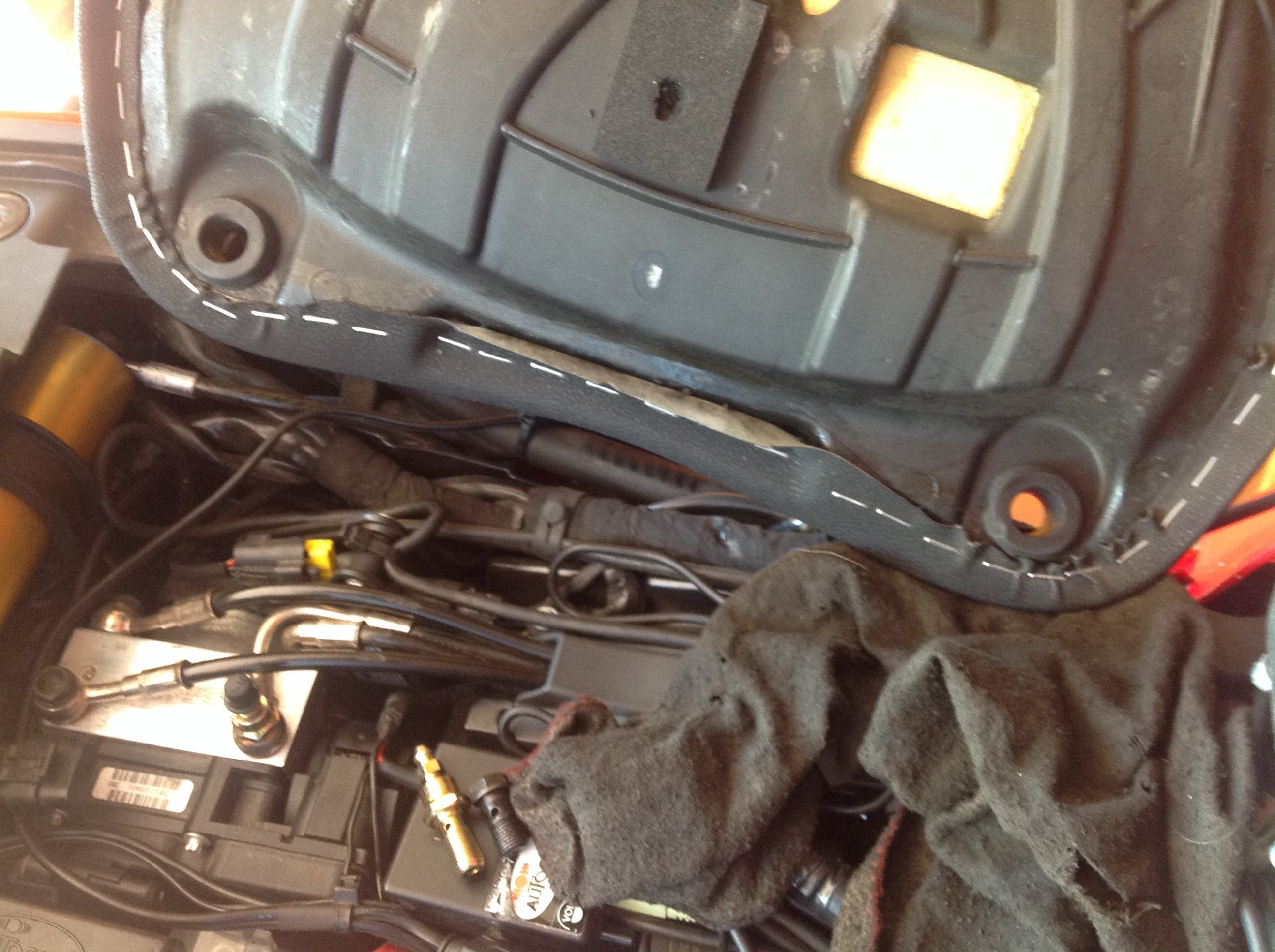

  15. Well, I have done the mod to the rear brake, but without going for a proper 1/2 day ride out, I can't tell if the mod will keep the pedal firm "forever", but fingers crossed?
    I did manage to activate the ABS (pedal banging, but no warning lights?) and the bike will slow/hill hold, but it still doesn't feel as if it has any "bite", must be down to pads/disc/dirt?
    A couple of points to note for anyone having a go;
    The bolts & nipple assembly from the eBay link in the original thread (Powerhouse) are a bit longer than the ones ACT has and stick about 38/39mm above the ABS unit face. So, they do dig into the seat. I cut out a bit of the foam pad, but the new dust cap is showing slight damage (you can just see it) so a hole through the seat base is required (I think Derek pointed this out before?) so as not to load up the bolt assembly?
    Also, those £25 Chinese "Sealey-a-like" vac pump kits are rubbish! Not so much the pump itself, but the hoses and adapters don't get near to providing a seal on the nipple, so you just spend ages sucking air and fluid, but not knowing if it is system air or bleed nipple/hose connection bypass? I ended up putting some fuel hose clips on and reverting to the old pedal pump option (need a hand to do the caliper, unless you are double jointed!) - at least then you can see the fluid pumping out with or without air in it!
    Be interesting to see how long it takes for it to "go off" again, before requiring another bleed and also what affect not cycling the ABS has?
