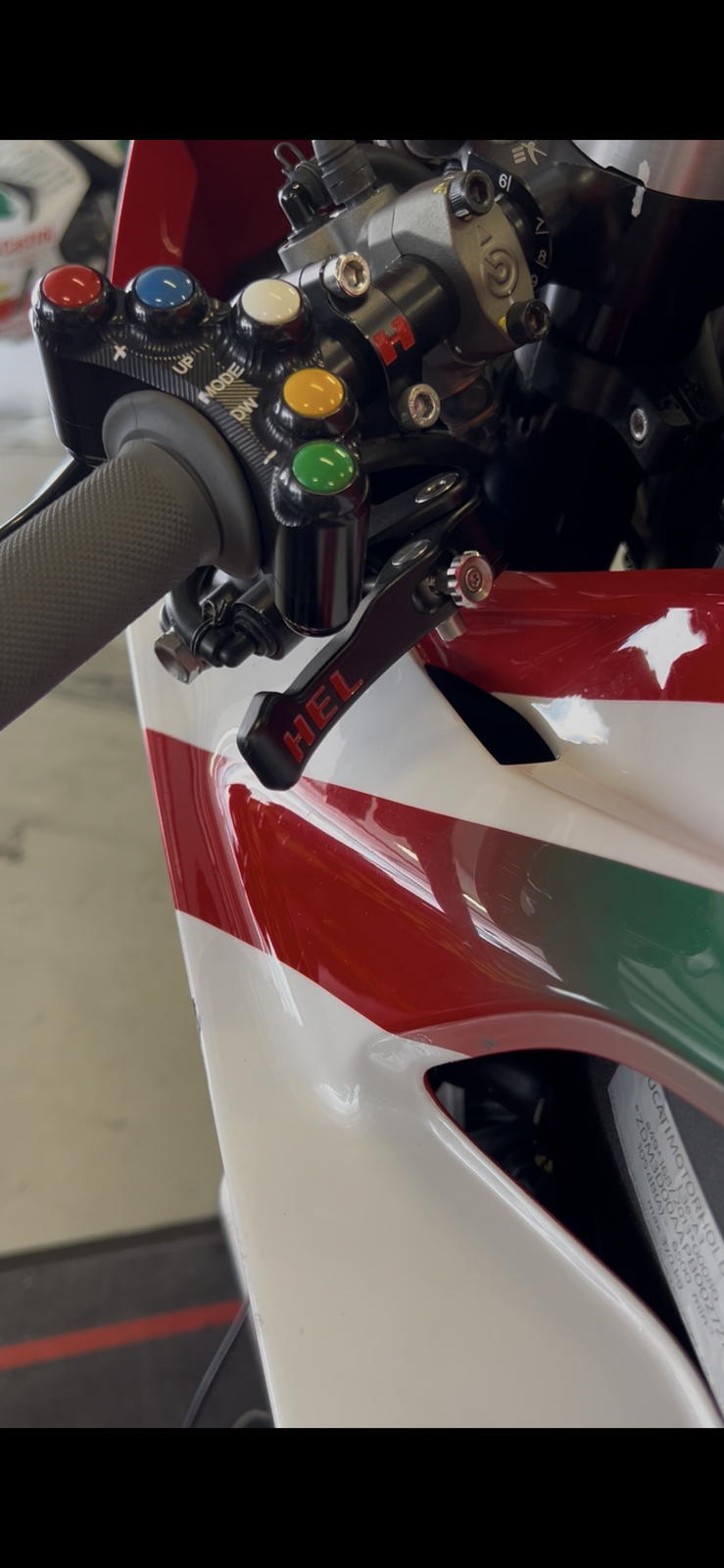

  1. Just got back from Portimao on the V4S with a thumb brake set up.
    I have done a bit of Supermoto training so understand the impact of hitting the rear brake when down-shifting into turns.
    It stops the rear wheel lifting when the weight shifts forwards, stabilises the bike and if on past the apex can better point the bike round the corner so gas can be applied earlier.
    Treble the power and the corner speed and things are remarkably similar. Take Turn 1 at Portimao. Crest the rise under the gantry 250 meter board, head up, thumb on hard and down three gears, rear end dips, hit front brakes hard to lose 100 mph for T1 apex.
    The key benefit I noticed was because the rear had dipped, the front hardly felt like it was diving at all, meaning the tip in was far faster and later and apex speed went up dramatically from 80 to 100 mph.
    In the sharp, downhill, positive camber Turn 5 keeping the rear brake on past the apex with the gas on as well felt so solid Turn 6 became my favourite passing place. That never happened before.
    So, yeah, I now recommend rear braking.
