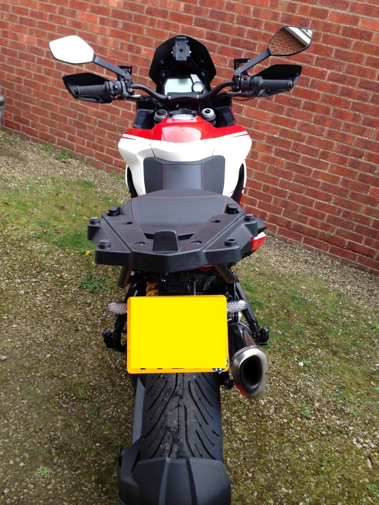

  1. Went for a spin with mates over the weekend and one of them wanted a go on my Multi. So we swapped bikes, it was the first time for me to see my bike from behind and I must say I wasn't impressed, the rear light assembly including indicators was bouncing all over the place it looked as though it might snap off at any minute. My question is do they all do it or is it just mine and is there a fix for it to make it more rigid.
  2. Yeah they all do it, the fix is to add in a washer to each bolt to make the bolts tighten up on the tail unit. AndyW has it shown at his motorcycle info site
  3. Fitted these myself and they do work a treat!
  4. +1 :upyeah:
  5. I took the rear tray out and moved the indicators right in, so they don't poke out very much at all, they also don't wobble all over the place now! It was the same for me following my bike and thought it looked shit! Looks so much better now
  6. [​IMG]
  7. Kirky had some of the bolts fall out on a run - the tail wobbled around even more then.
  8. My god! Your bike is spotless!
  9. Bit dusty now after 200 miles round North Devon back roads at the weekend :D
  10. Cheers lads thanks for the info and thanks AndyW.
