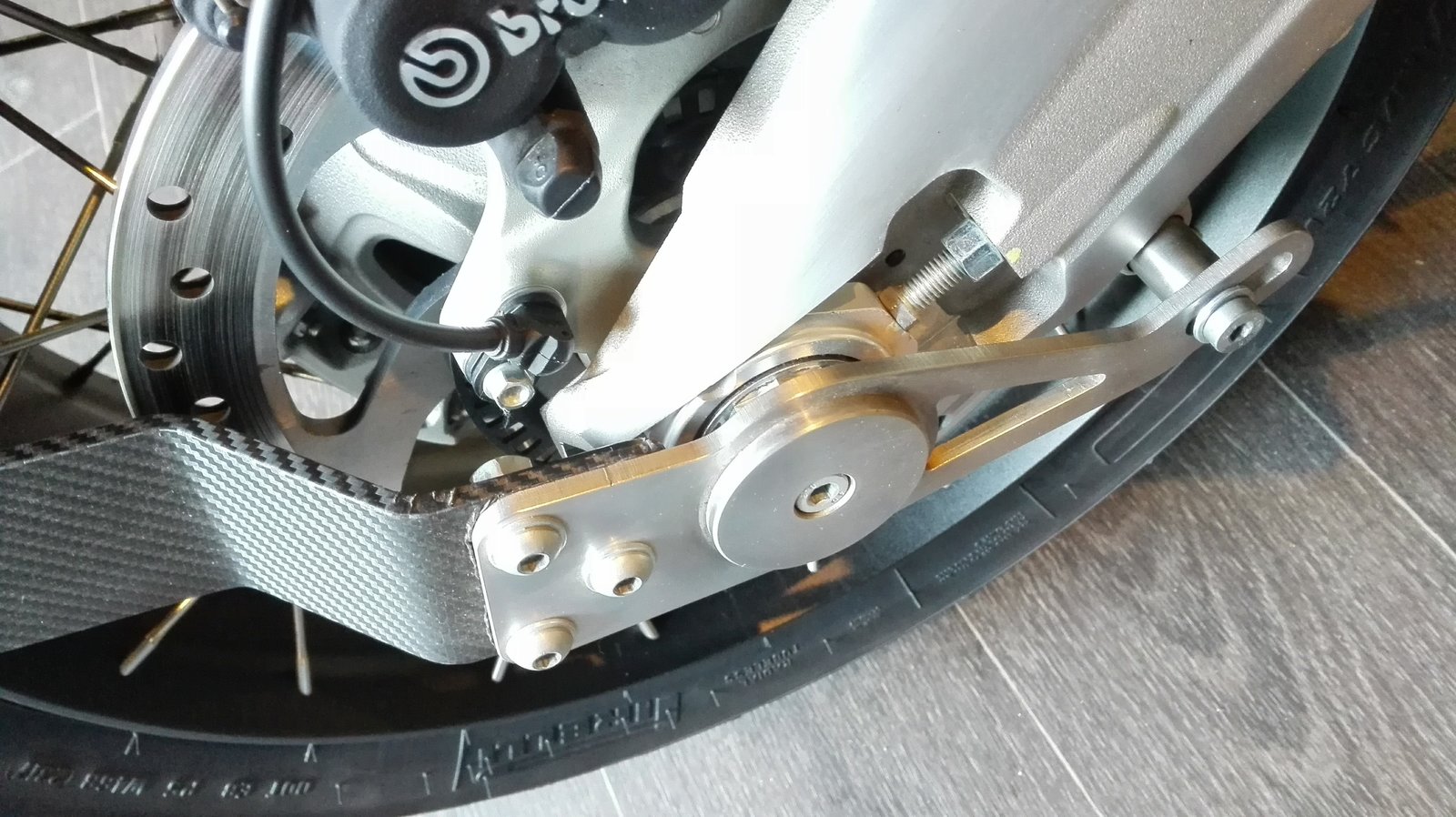

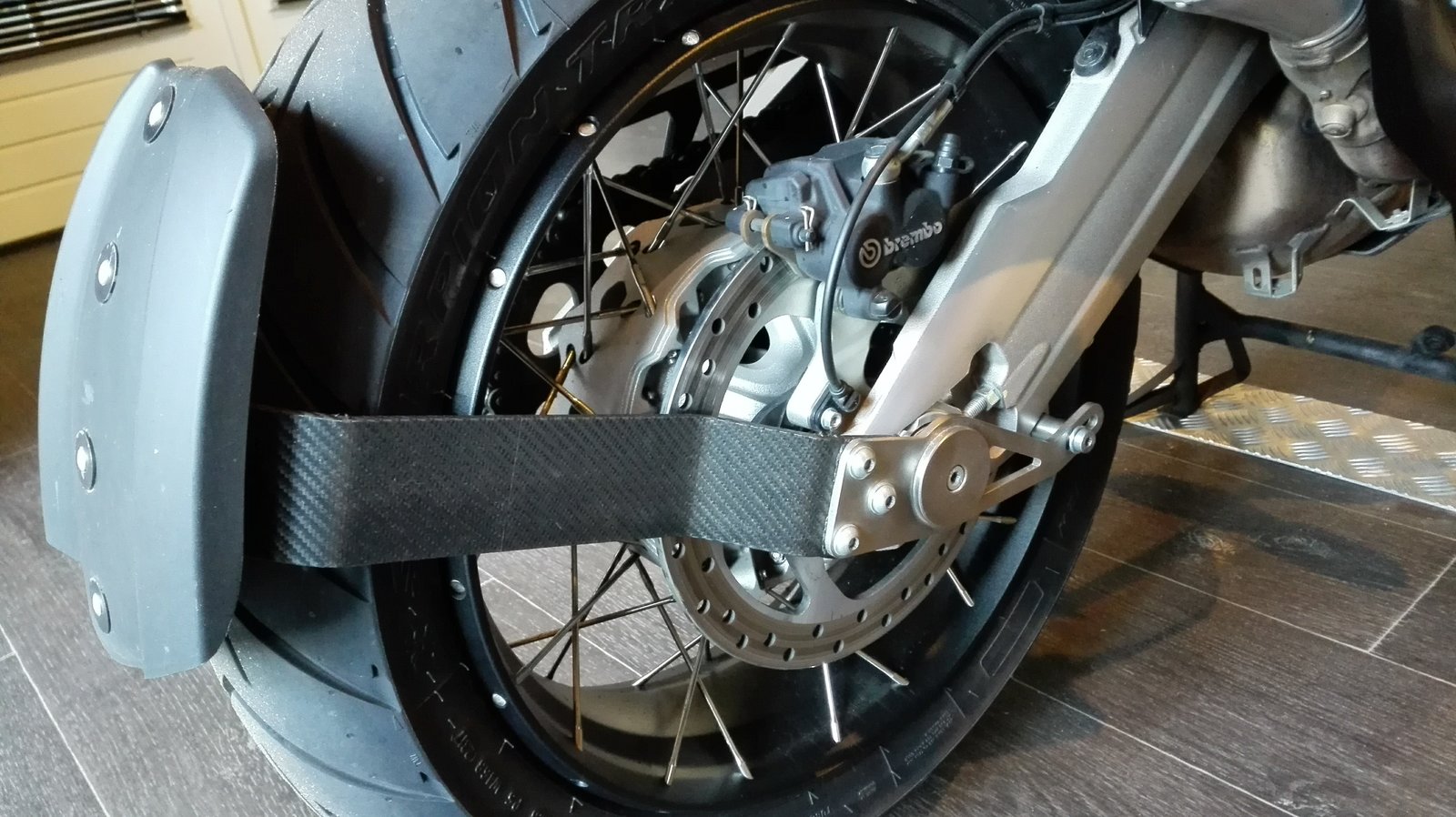

I have made my own mudguard prototyp and it works. But I am not satisfied complete. This winter I am going to make a upgrade, to make the looks a bit more sporty, Also looking for carbon mudguard part
Gert, thank you for sharing. That is it and is the first time I see it on an Enduro. I also want one. Will try to get someone who can build one when I get back in December as I am currently far from home. It looks very nice in my opinion congrats.
