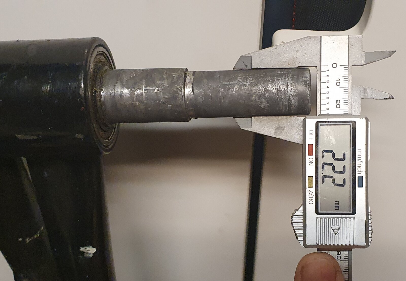

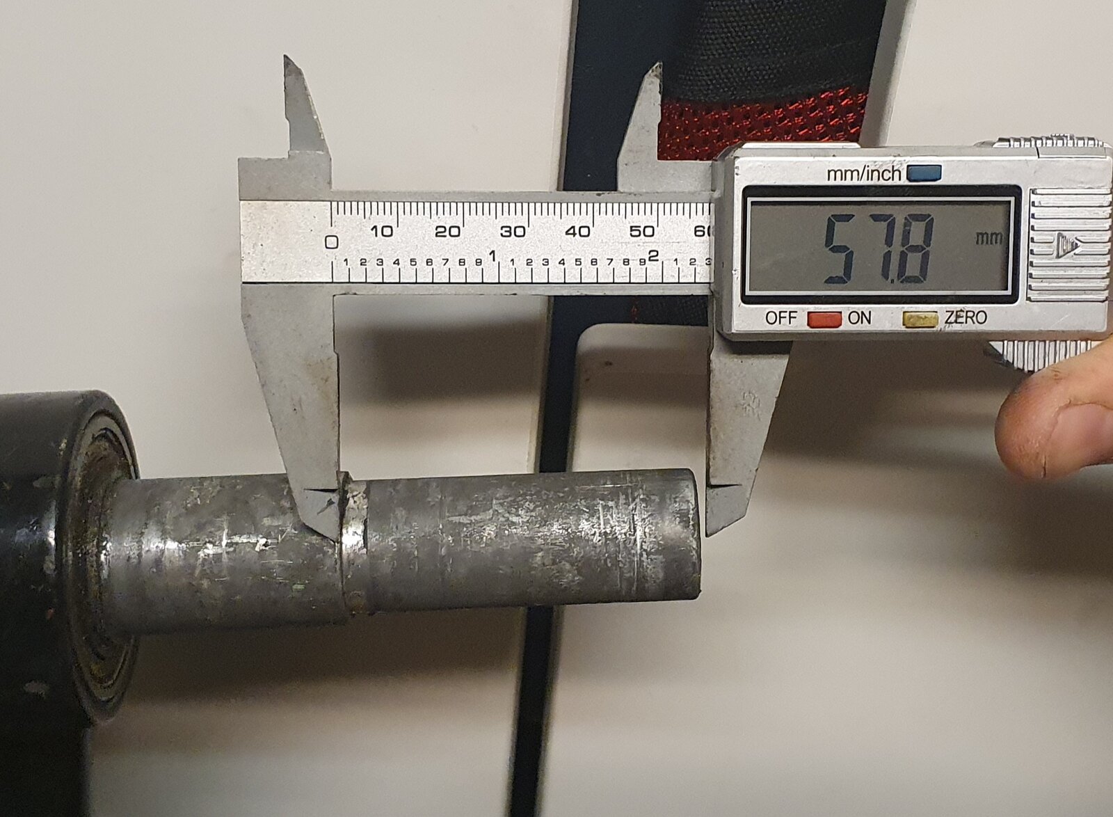

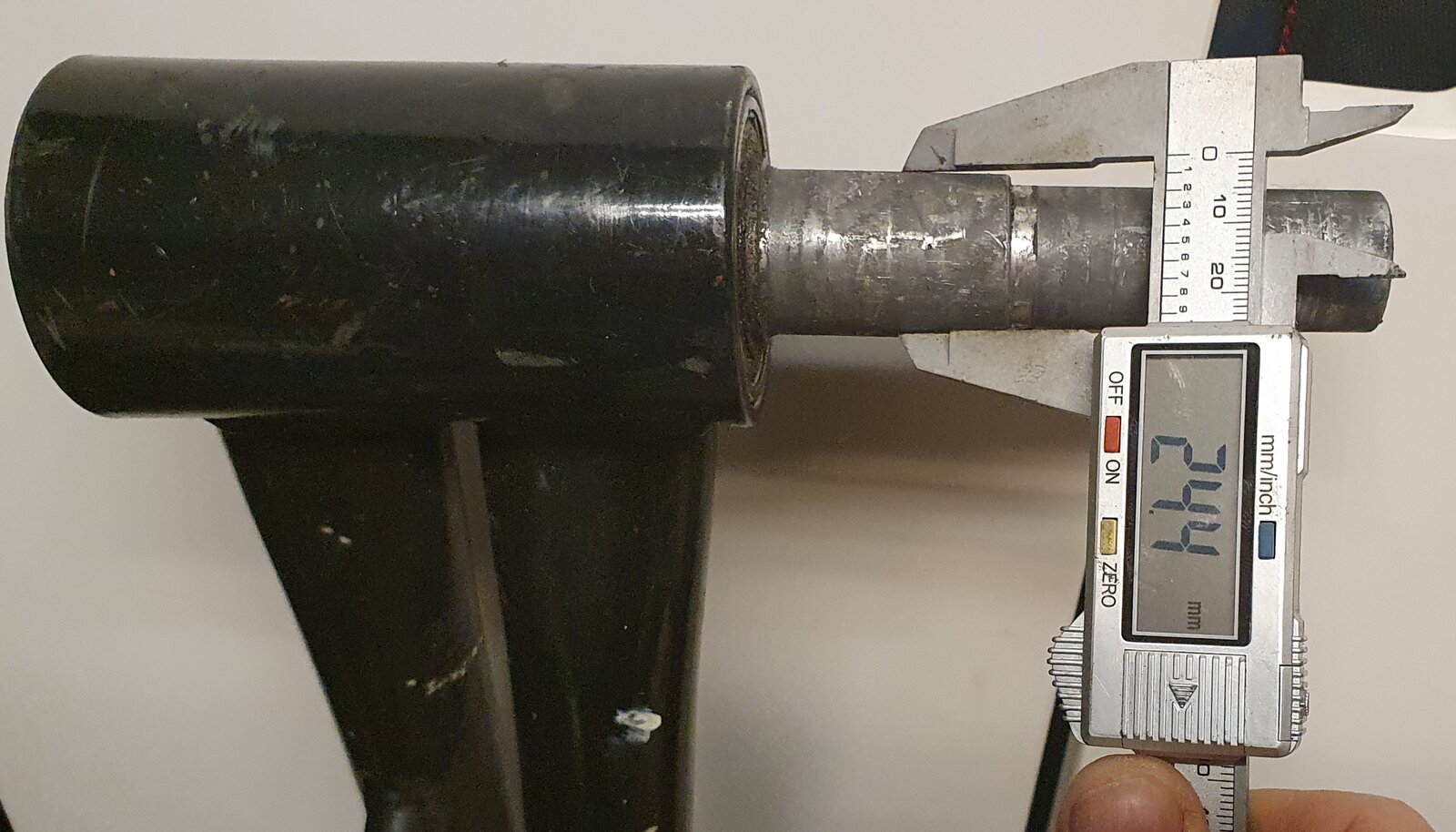

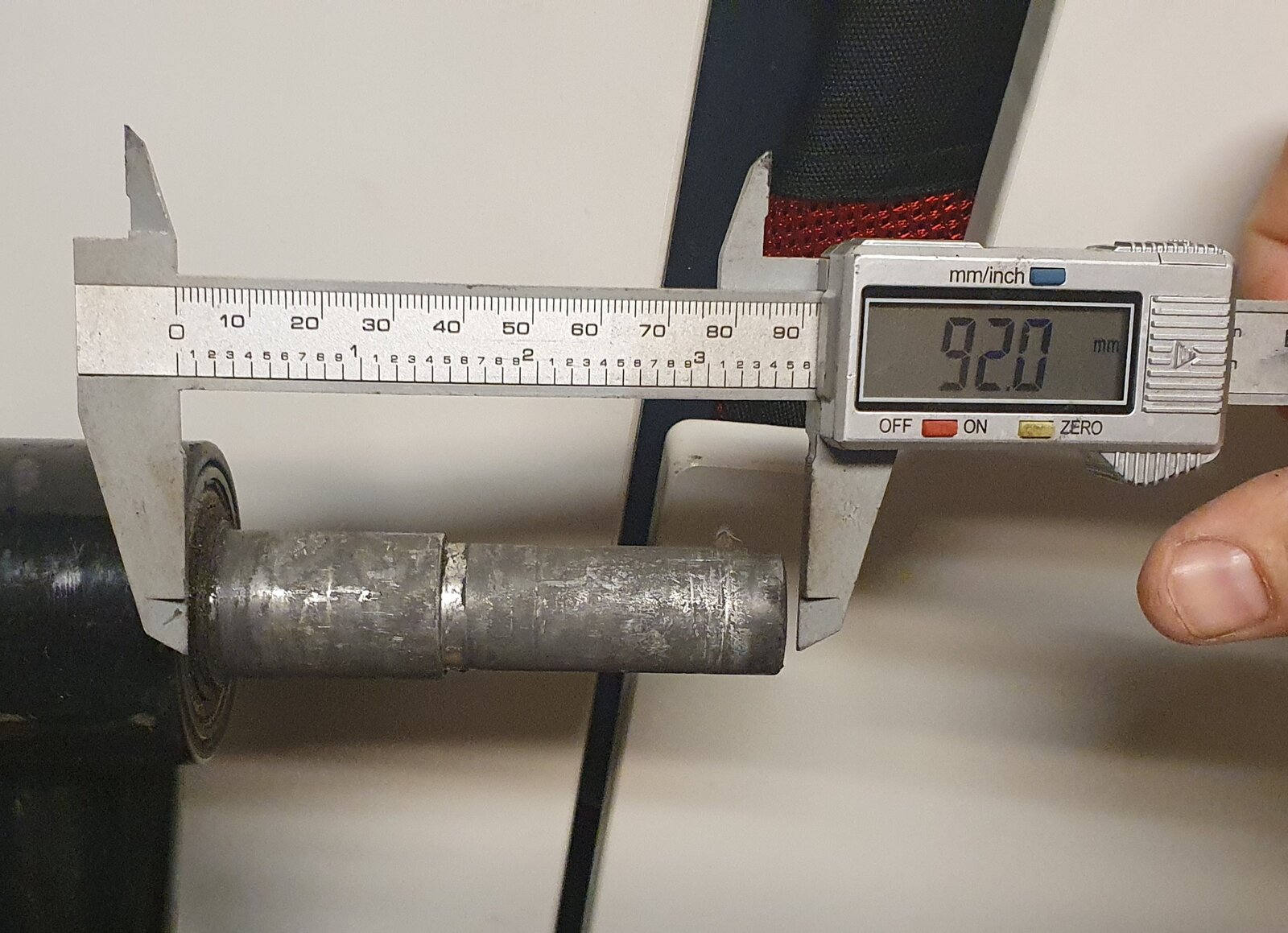

  2. 20200730_181123.jpg 20200730_181109.jpg 20200730_181053.jpg 20200730_181037.jpg
  3. No problems at all. My bike also runs the 5 spoke Marchesini
