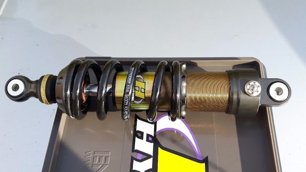

    Anyway, one of the things I'm taking off the M900 is this lovely 2K miles Hyperpro Shock:
    Being for a hoop suspension Monster it's 330mm eye to eye, so no good for the M1000, which needs to be the more standard Ducati 305mm eye to eye.
    At £430 retail new it's still worth quite a bit with only @2K miles on it, and what I'd ideally like to do is finance a similar shock for the M1000 by swapping or selling this one.
