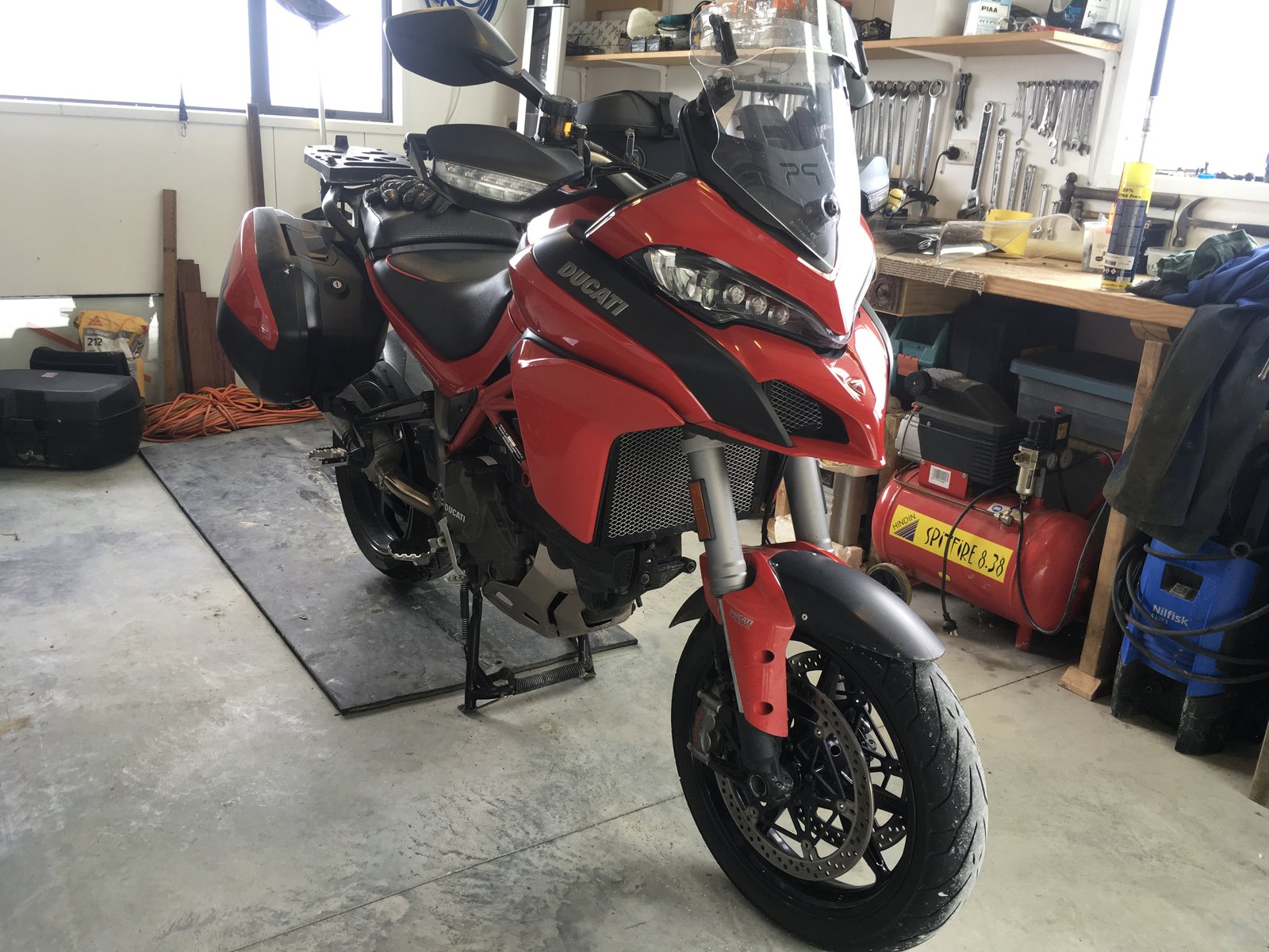

  1. As above, has anyone replaced the bushing or tightened the rear shock swingarm mounting? Just noticed a bit of play in mine while doing a chain adjust and it seems excessive, to the point it would likely fail a roadworthy insp...still heading off for a wet weekend of shennanigans tho! IMG_1062.JPG
    Thanks, Al
  2. They are designed to move as they are a swivel bearing in the Multi, they can indeed wear but only after some 20,000 miles or so or depending on use of bike also. As long as you don't feel a clunk in your backside when riding it is ok, only if you feel this or hear a knocking sound then replace. You cannot tighten it up, they cost £39 plus fitting .
