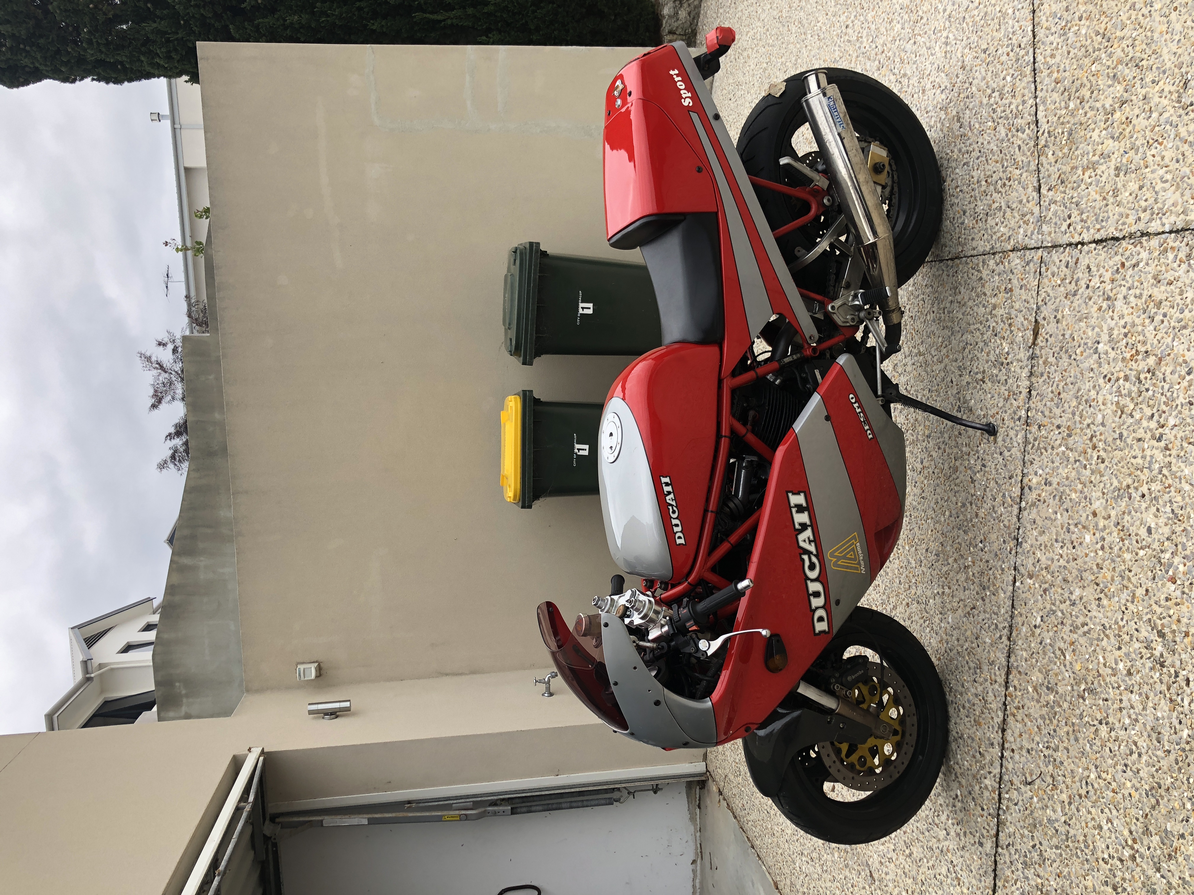

    I’m gradually fixing up my 750 Sport which I bought a couple of months ago. It’s a Japanese bike imported to Australia and I know a fair bit about its provenance but working through tidying it up.
    It has 17” wheel conversion with 900SL forks and Kehlin carbs and has had a major service so runs and handles well - did a track day with it and was able to show some much newer and bigger bikes the way home.
    The rear shock is proving harder to replace than I imagined. We are going to rebuild the existing shock but I hear that a 900ss from the 90s bike works well and lifts the rear a little to speed up handling.
    I’d love to hear more on that front from anyone that’s replaced the stock unit, with what and what did you have to do to get it to fit (if anything). I’m resisting buying a new ohlins unit (seems you can still buy one new) but what else people have done.
    Thanks in advance.
