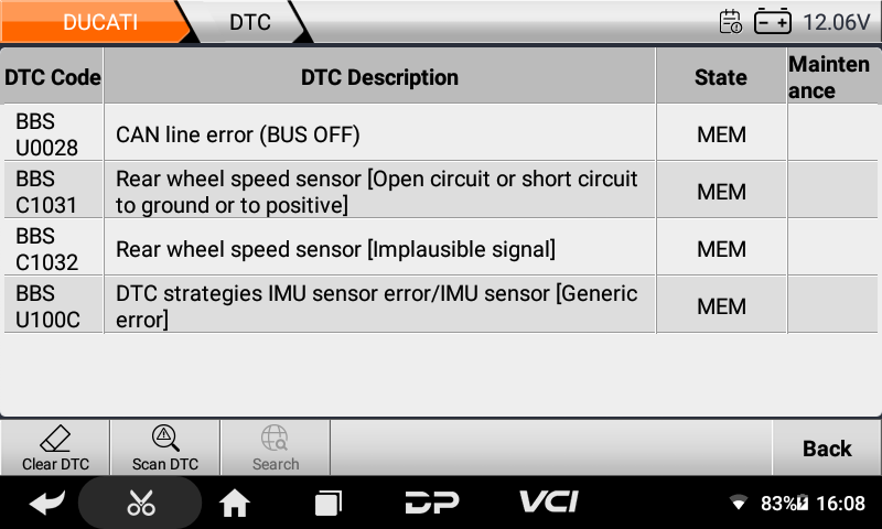

    Fast forward to yesterday and a ride with some mates; riding shortly after lunch and the dash lit up in the same manner but this time the error seems to be more persistent. It went way for a short while on an ignition cycle but came back about 5 minutes later. Quite a few of the electronic aids seemed disabled (DQS, DTC, ABS and DWC all said ERR), the speedo failed to work, the quick shifter (DQS) no longer functions and the yellow DSS indicator along with the ABS fault, engine management light and alert triangle all illuminated. Manged to ride the 50 miles home.
    Plugged in the OBDStar and ran the diagnostics which came up with the following:
    Looks like a more permanent version of the previous issue and down to me not replacing the sensor last time around. Removing the sensor confirmed this as what was the scored face previously is now in a far worse condition. Cleaned it up, reinstalled and cleared the error codes. Will try riding it in the next day or two and see but if it works again, I accept that, if it does, it'll be only a brief respite and replacement is necessary.

  3. Not sure if it means anything, but your battery reading is a little low. Reckon it could be influencing the issue, causing what's reading as sensor fault when it could just be patchy juice? Doubtful, but it's all I can add.
    Fingers crossed it's a simple one
  4. Thanks, the OBDStar tends to post a low reading compared to my tracker which is showing 13.3v. However, battery is over 5 years old now. Planning to replace it ahead of next tour.
