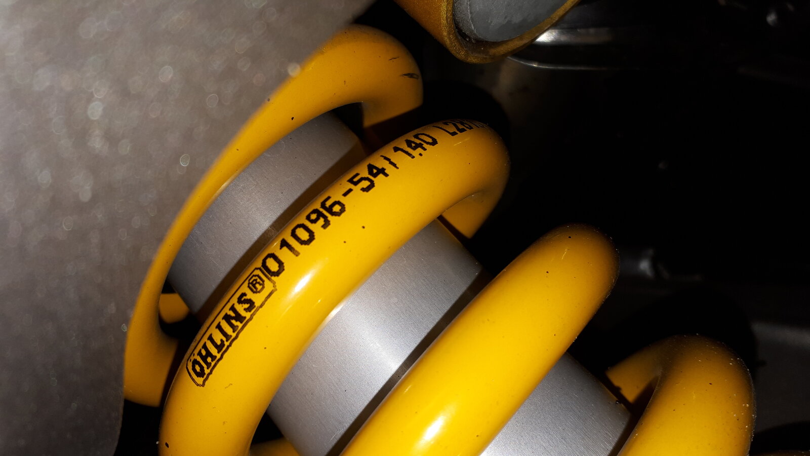

  7. 85 nm, I have changed it into 115nm.
  10. gert, is that on an enduro ?
    OP is specifically asking about an enduro, and I didnt think Ohlins made a spring for it (for a start I think the damper /spring might be a different diameter - read it somewhere)
  11. Yes it is for the enduro. Very satisfied with it, 2 up, full loaded. Its massieve

  13. hi all new here, I have a 1200 enduro and I also suffering from a soft rear spring two up with gear
    I see gert has a ohlins replacement spring but can not see the full product number from the photo would there be any chance Gert you could provide this for me and I could order the same for my multi
    thanks all
  14. The 100nm spring part number is given in the link near the top (21729-34/100). The 100 on the end is the spring rate.
    Maybe asking an ohlins dealer might get the 115nm part number if Gert doesnt have it.
  15. Yes it's for the enduro
