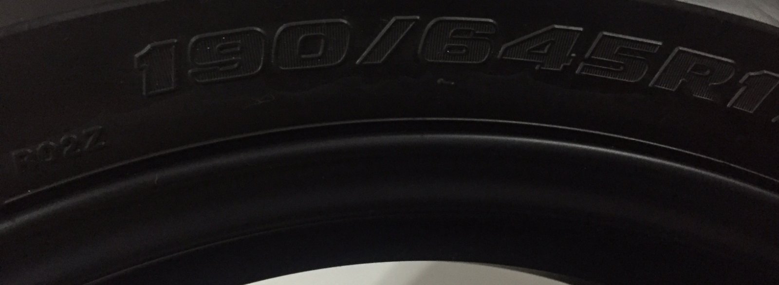

  2. 190/645 on my prototype :)
  3. Is that a prototype tyre too? Seriously rare!

  6. Yes :)
