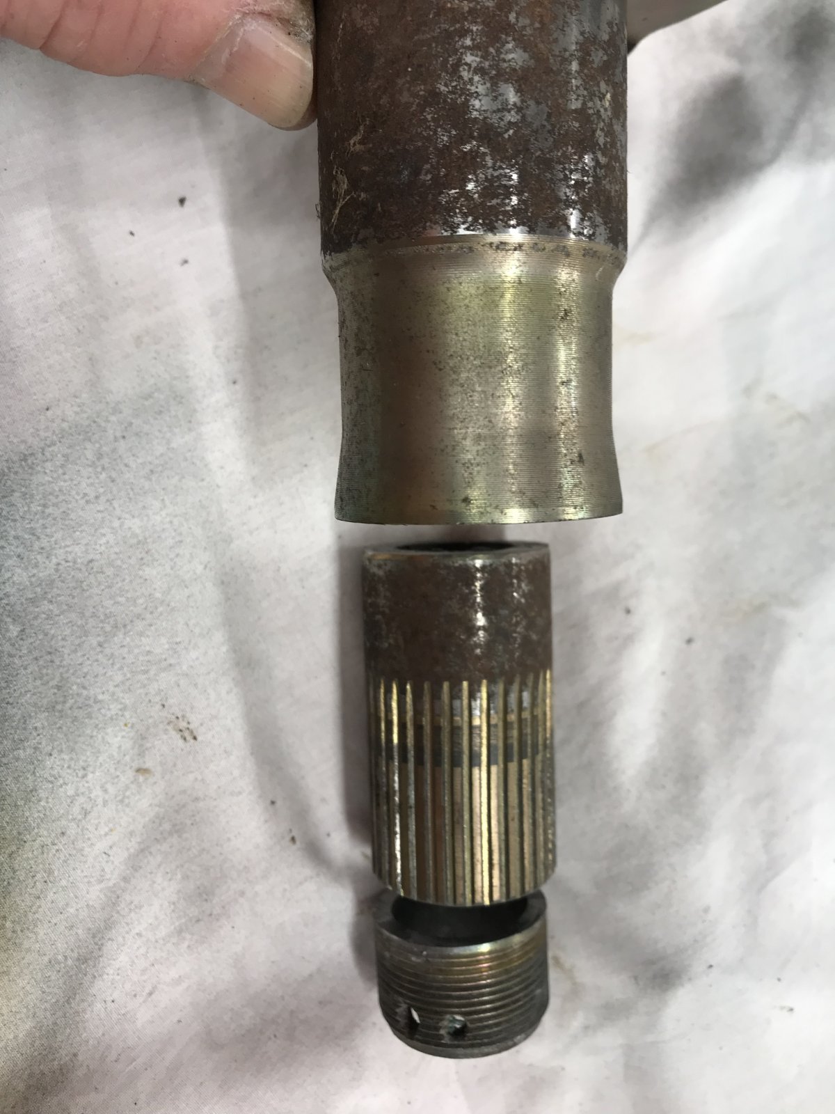

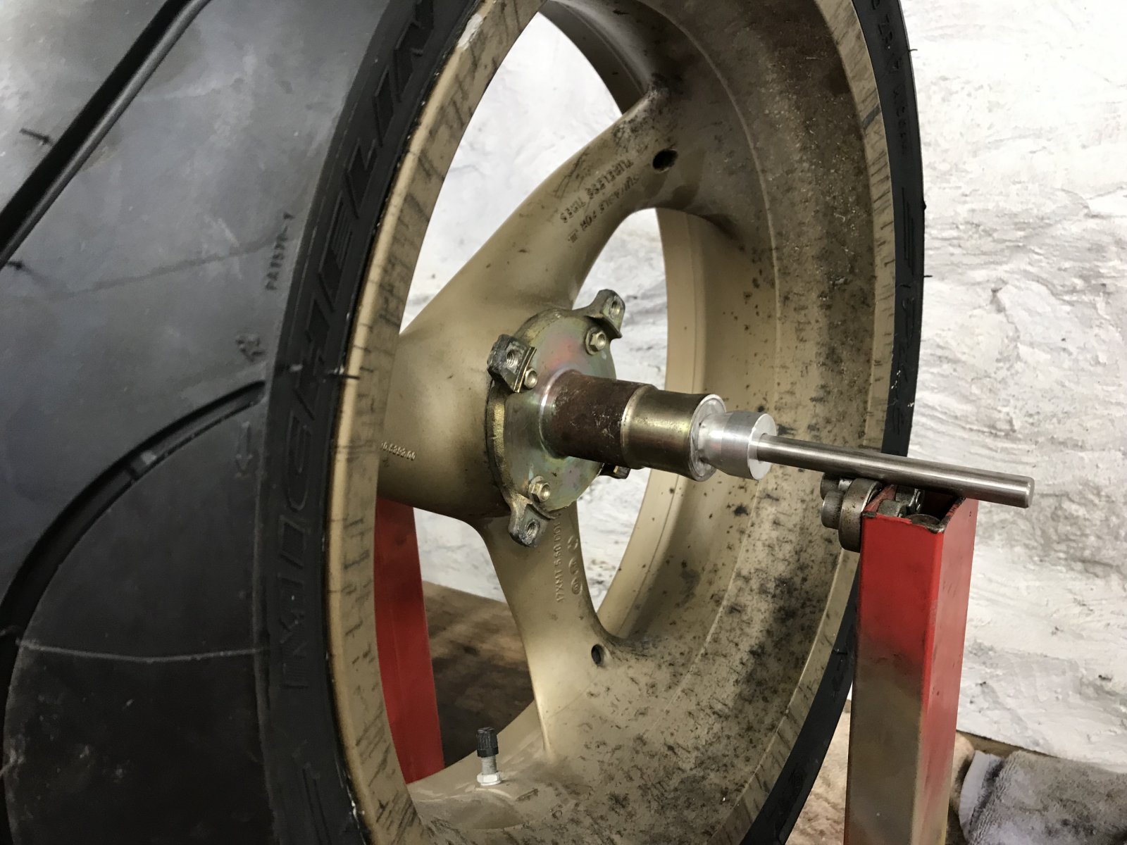

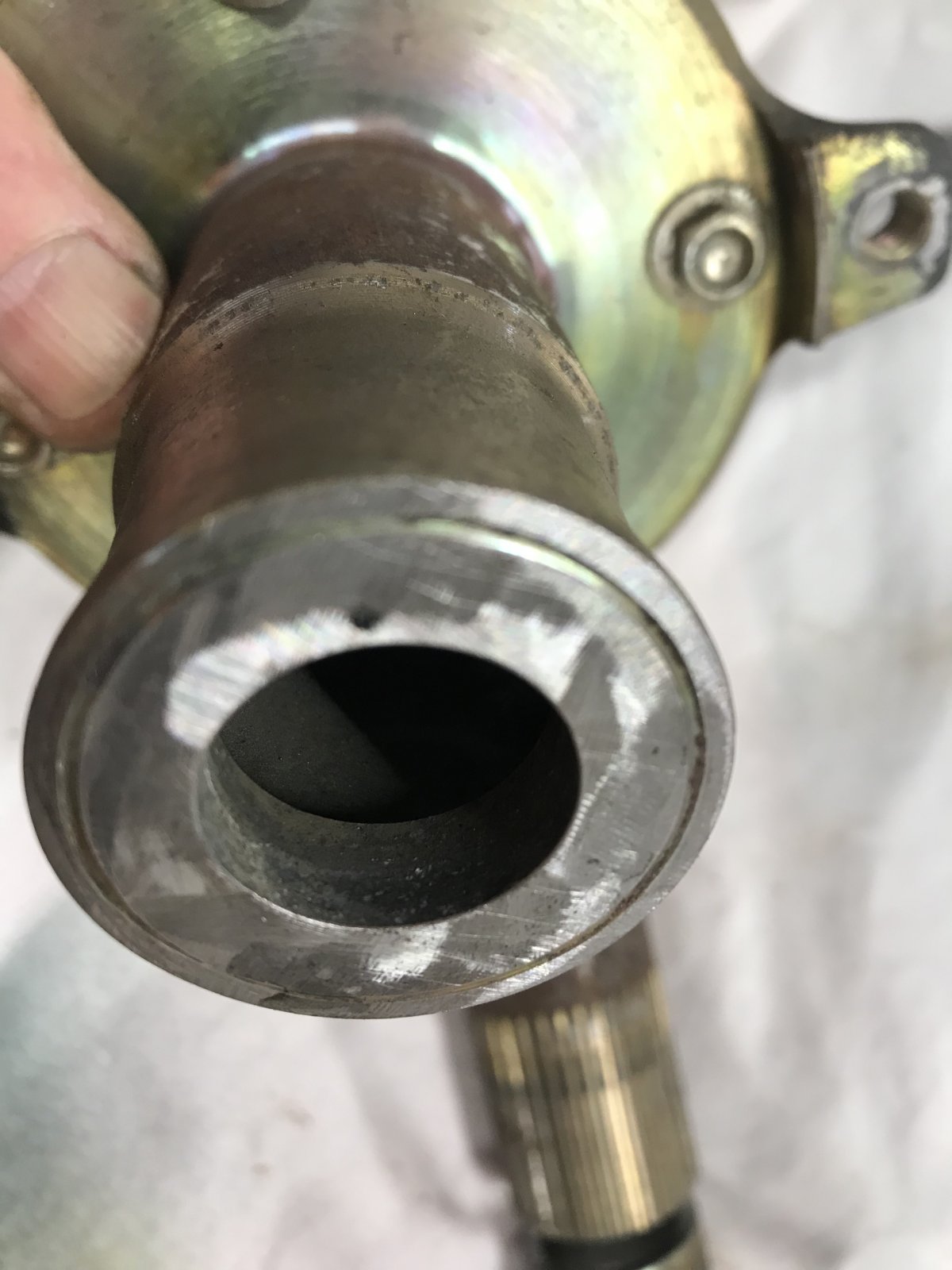

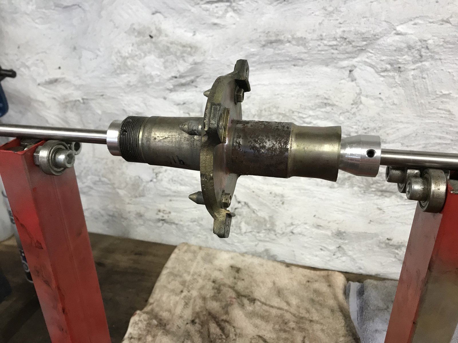

Decided to make up an adapter to balance the rear wheel today using a scrap rear axle. I was surprised to find that the axle spindle section seems to be manufactured from two parts being pressed together. Some pics of its construction.
