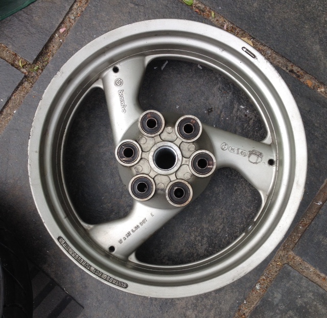

    Looks like I've got a job on my hands with these cush drive rubbers. Are these that difficult to remove? I've seen some home made tools used for extracting, but I don't have the facility to make one of these.
    I've also read that heat needs to be applied around the area, and a slide hammer can be used (another tool I don't have).
    Any advice on best method for doing this?
    Also, can these parts be re-used, or is it always best to replace the whole set with new?

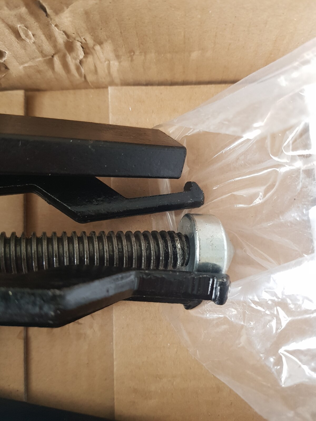

  11. Just arrived, looks small enough to fit 155679415441730897967637285225.jpg

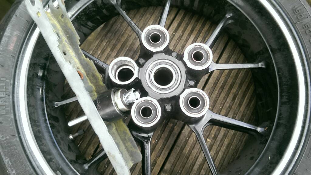

  12. I recently had my front and rear wheels powdercoated when I swapped the 4.5inch rear on my 1995 ss/cr to a 5.5inch wheel. I tried a couple pullers including the style you show above and the issue was they weren't deep enough to grab the edge of the inner sleeve of the bushing. Even an inner bearing puller with a 3lb slide hammer didn't budge them because of course, they are rubber damped.
    What eventually worked well was $1.50 worth of long lag bolt/nuts/washers and a piece of pipe (actually a heater element removal tool for an RV hot water heater :) that I had lying around but any piece of scrap pipe of the right ID would work).
    [​IMG] [​IMG]
    This setup popped them out easily and they were all reusable if you see fit. I replaced them after powder coating with new using an old bushing as a driver, honestly I would never reinstall 25 year old rubber bushings, but that's up to you.
    And of course here's freshly powdercoated wheels with new bearings, cleaned up rotors, new bushings, new tires, ready to go back on the bike.
