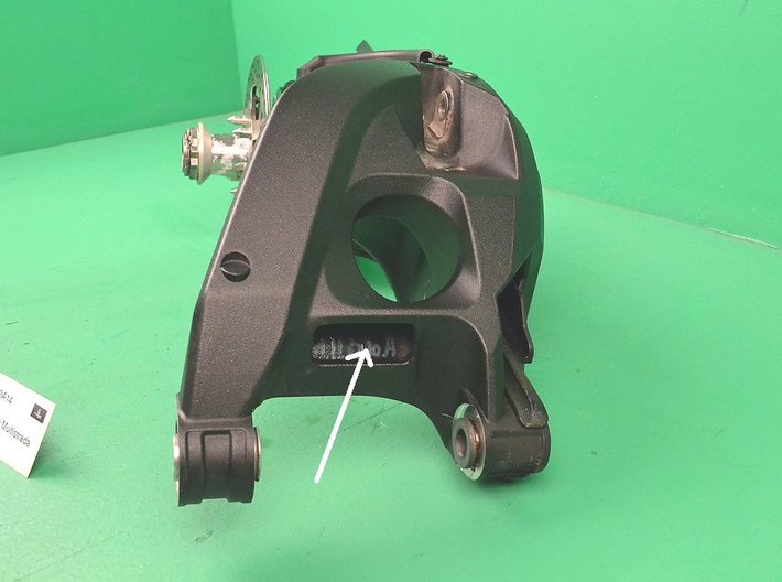

  1. I’ve always been annoyed at the way water sits around the rear shock (drain hole gets blocked easily) but was unaware of the large opening around the exhaust side. Thanks for the advice from Nelly who has seen a few others seized. I understand that cleaning and greasing the rear hub has been added to the 15k service.
    The bad news is that these 2010 to 2015 bikes with this hole in the single sided swingarm, let in all the road crap and this will lead to your bike requiring a new hub/bearings (at 28k for mine). The Ducati part (Hub assembly) is £500+ but thankfully Baines Racing managed to find equivalent bearings at a much better price for me. Apparently there is no hole on later bikes.

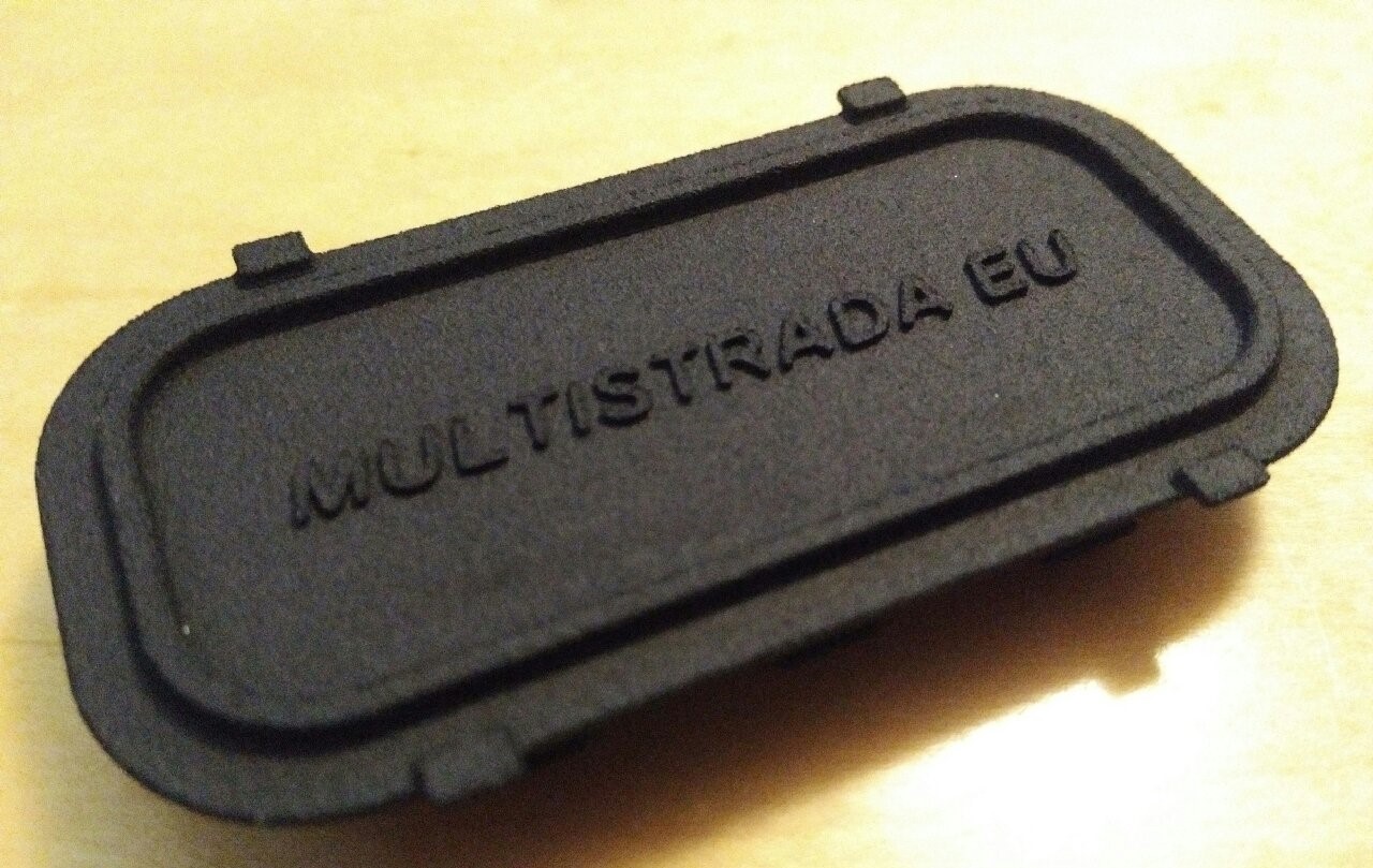

    After research I found a plug to seal off this gap to avoid it failing early again. I ordered mine on www.shapeways.com. Just fitted mine and hope it stays in place.

  2. On my enduro swing arm there are two on the inside that allow loads of shit into mine. Ian.
  3. I don’t seem able to find pictures for the DVT swingarm, I take it that its not like Swiss cheese?
  4. That's not good, better do a search for plugs.
    I have read that the DVT doesn't have this hole but worth checking in case there are others!

  6. Cannot find that plug on the site, can you post link please

  7. After discovering a load of crap in my rear hub during a recent major service, Ive fitted the Shapeways plug on my 2012.
    It's expensive and a bit brittle but fits the hole nicely. Needs glueing in place though as the lugs don't hold it securely.
  8. I was wondering how well those lugs would hold it. Hopefully it'll still be in place after yesterday's ride to the Excel bike show.
    What glue did you use; 2 pack Epoxy?

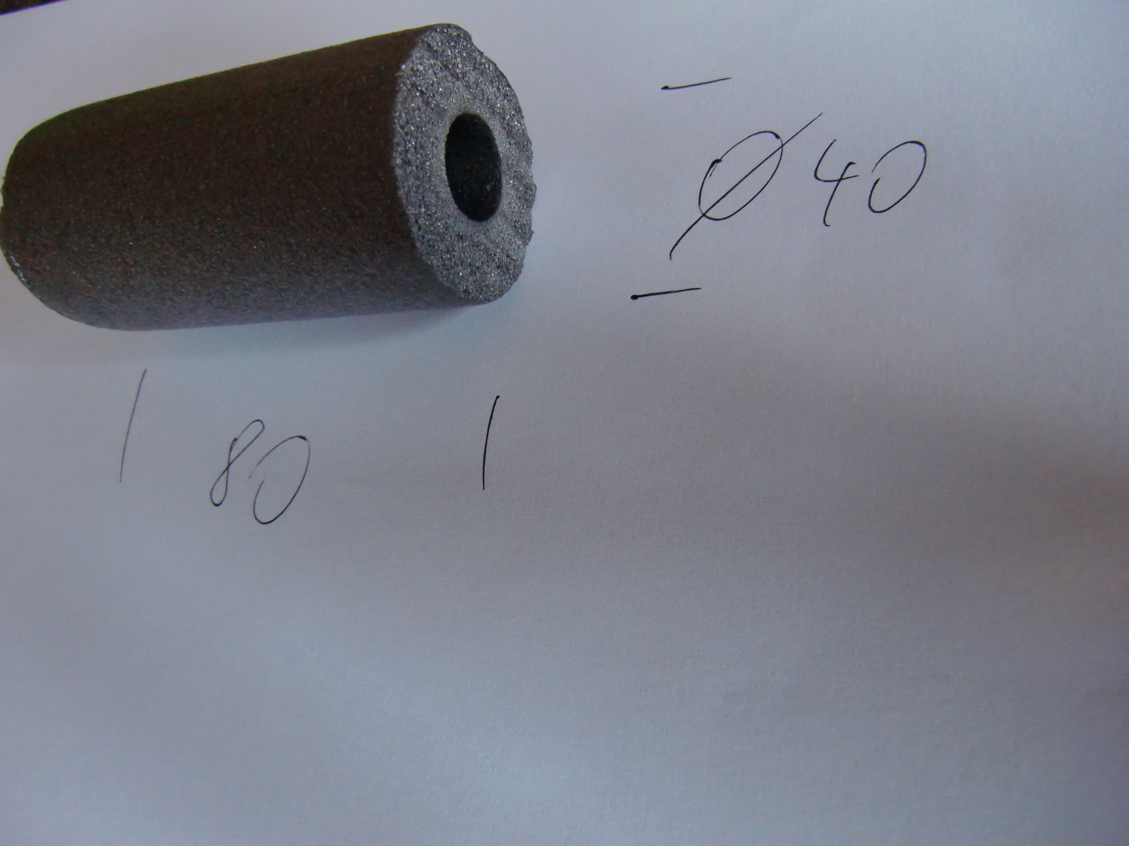

  9. heating pipe insulation made it for me

  11. Naw, just some Super Strong glue from B&Q. Works okay, survived the horrors of last weekends Dragon Rally anyway.

  13. I managed to fit the plug to my 2010 without any great problem and certainly no need to disemble anything. Just had to be careful to not snap any lugs when pushing into place. So far it's stayed in.

  17. I had success from the sprocket side coming from the top.
