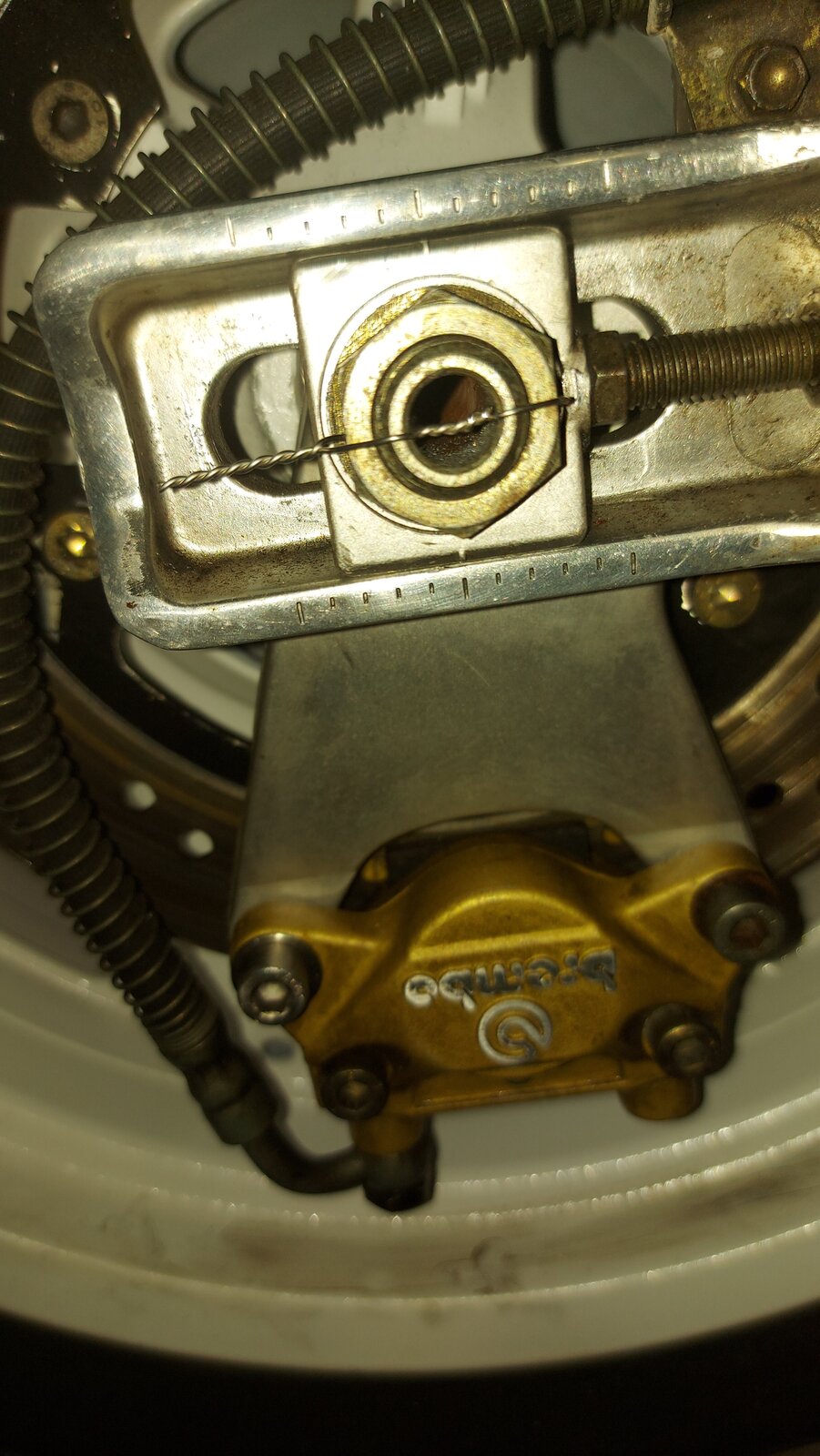

  5. This is where I drilled, its tricky starting it cause if the angle and I broke a few drill bits iirc it was a 2mm drill bit

  8. Hmmm, I'm going to sound a bit damning... That's not how lockwire is meant to be used. You've done a one-time thing (most unlikely to tighten again to the same orientation) with the wire potentially in shear. Lockwiring is done to prevent rotation (wire in tension) by anchoring it to something else solid.
    It's better than nothing;)

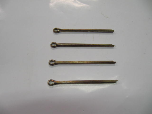

  10. you could now use a suitable split pin in it's place. :upyeah:

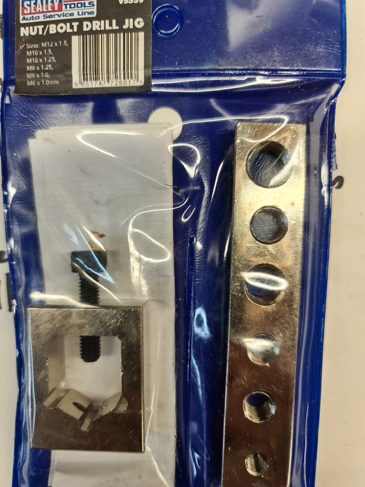

  11. Ive got this kit for drilling nuts and bolts, may be of interest. 20210320_145329.jpg
