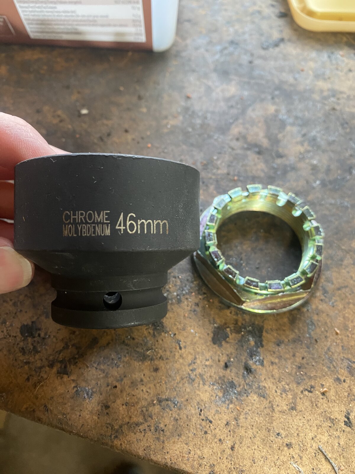

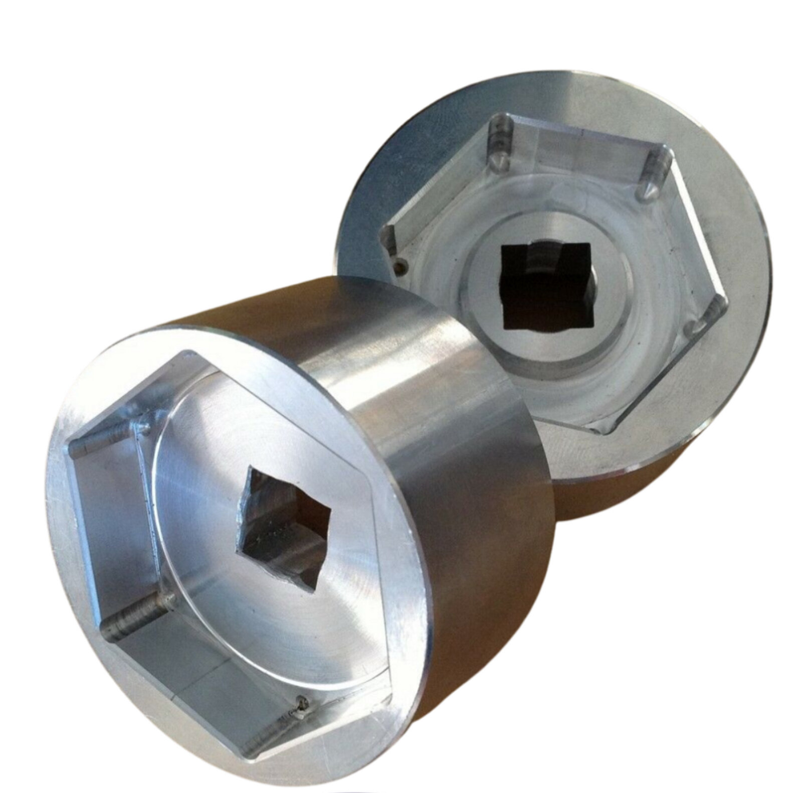

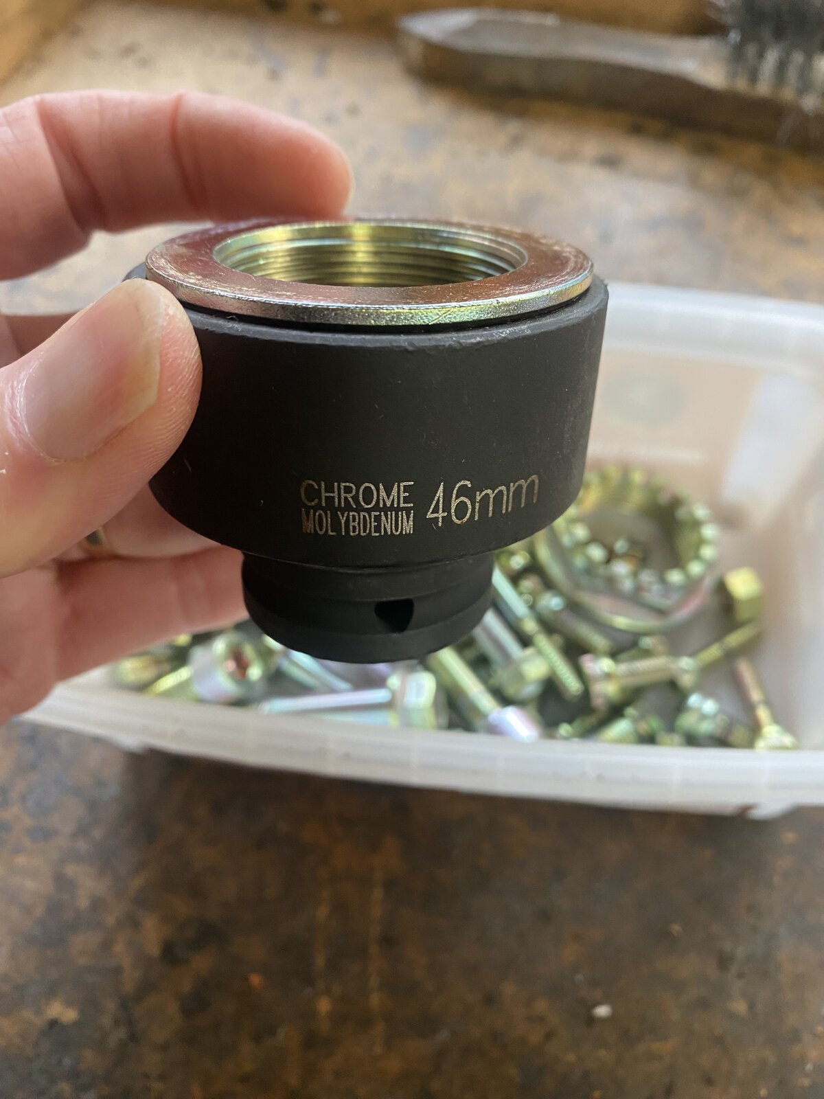

    Need help,can anyone please recommend what socket is best to remove my rear wheel from my 916 there are about 3 different types just don’t want to buy the wrong one . A photo of the best one would be helpful thanks !!!
    Gary
  2. What i use.
