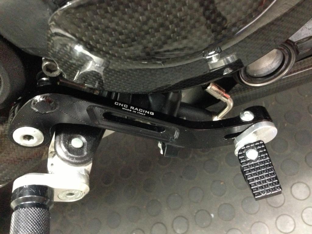

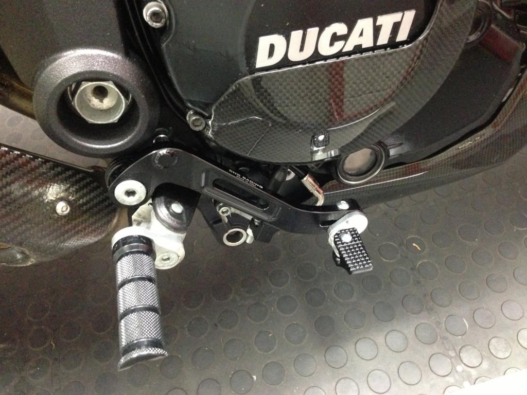

  9. Just fitted the CNC racing levers
    Very pleased with the quality and look, and much better feel than the standard levers

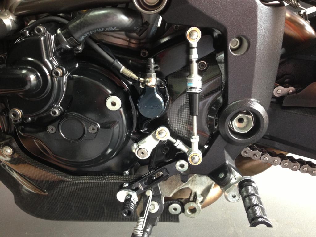

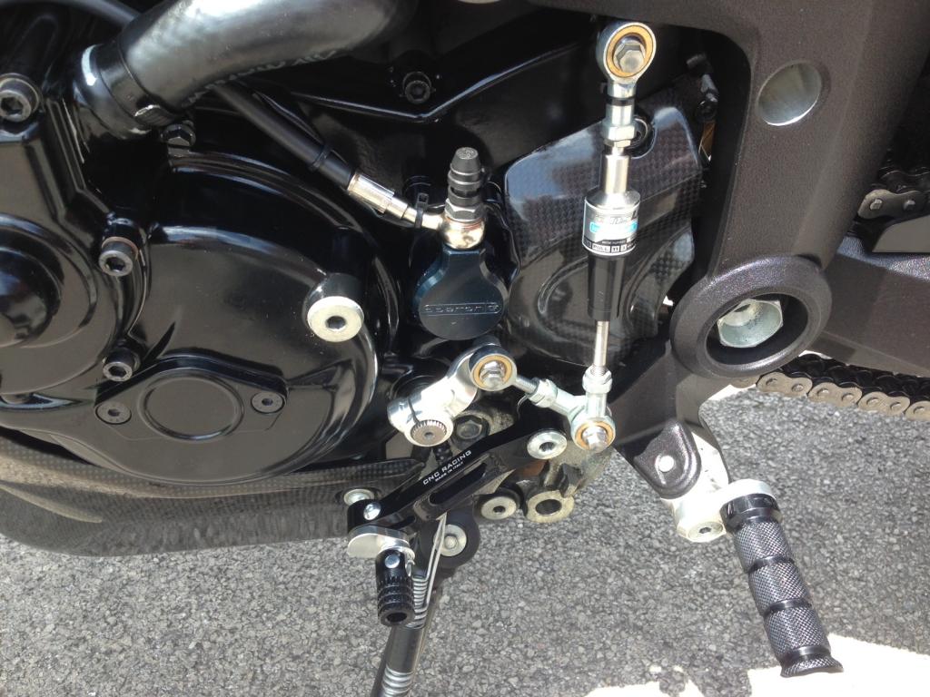

  10. Boomer. Did you have any trouble with the gear lever striking the side stand pivot on down shift. If so how did you get around it.
  11. Yes I did !
    I have e-mailed Steve at Carbon Conquest, he said someone had had an issue with fitment, I guess that is you..?
    I got round the problem by repositioning the lever that is attached to the gearbox splined shaft by one spline, (you can see this on the picture if you look at the dots on the spline shaft) then re-adjusting using the rose joint adjuster to get the lever in the correct position. It was a bit of trial and error to get it right because I have a quick shifter connected as well and had to also adjust that.
    Hope this helps

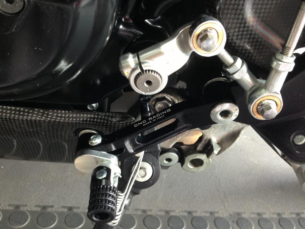

  18. Here you go
    Made a sleeve behind the top pivot point to bolt to the crankcase using a longer than standard bolt
    Also had to cut and shorten the quick shifter shaft slightly to get it into the correct adjust range
    Works a treat, and looks ok I think, someone actually commented that it looks like it was meant to be there..? :upyeah:
