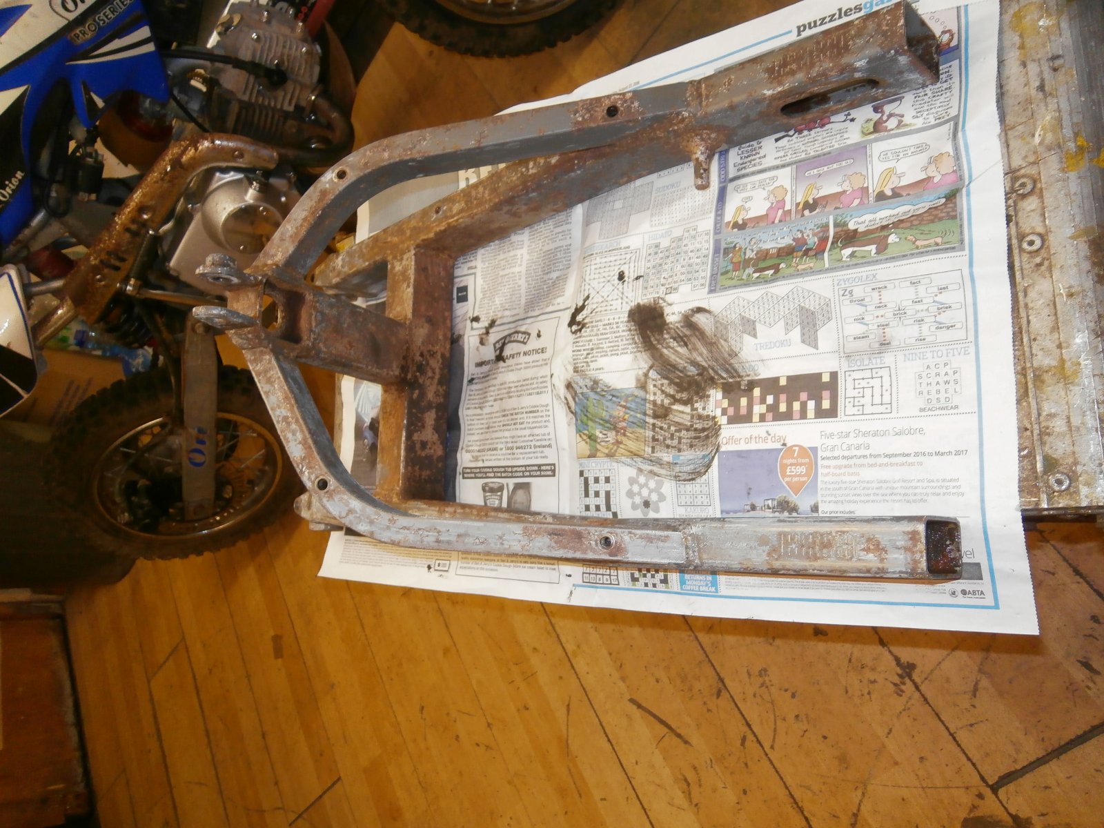

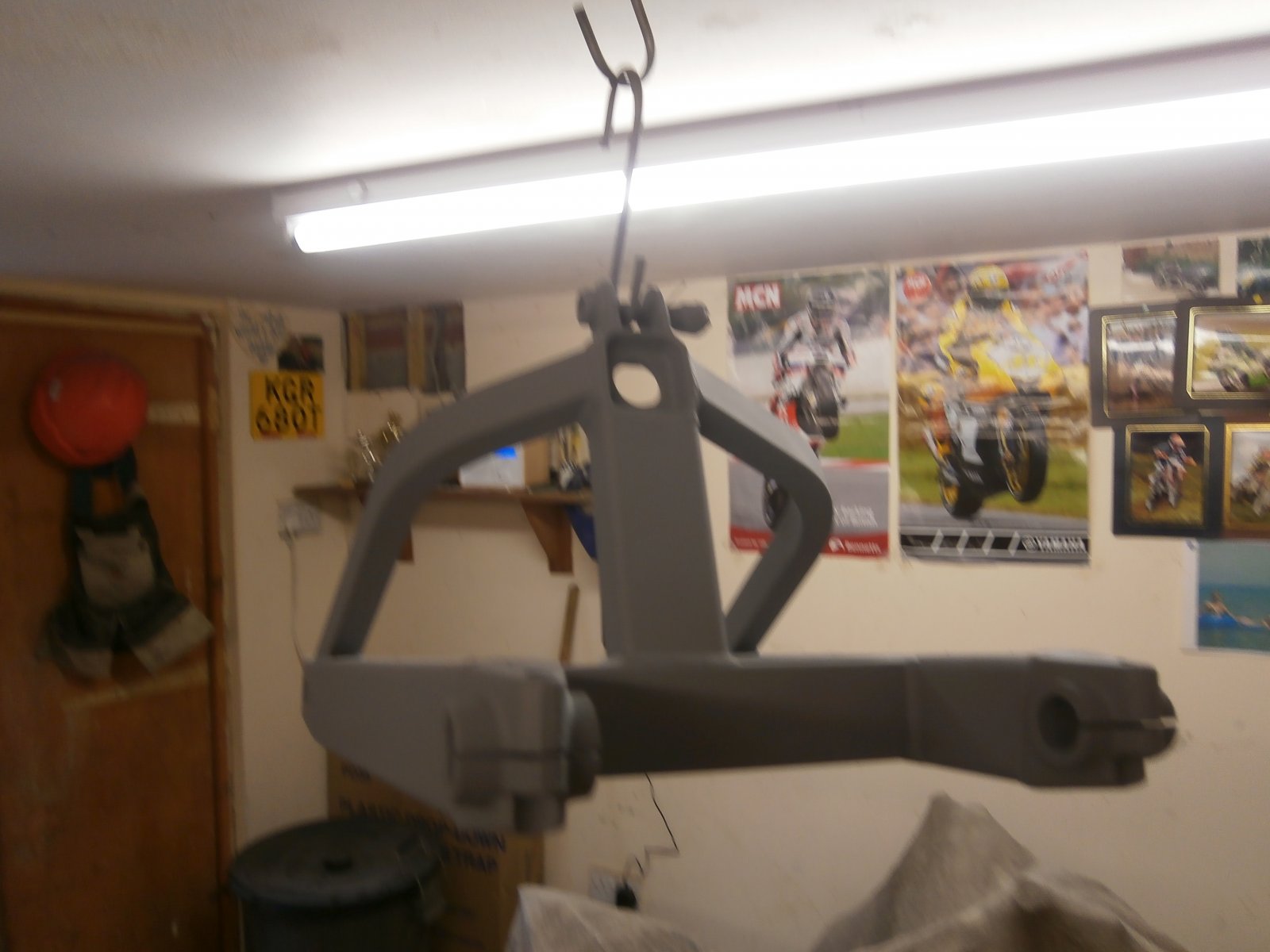

    My swingarm is steel, well both are bought it as a box of bits with one arm,which is marked as 750ss, then bought a load of parts from a bloke on this forum who was braking a 600ss, basically cleared his garage out what he had left and amongst the parts was a tatty 600ss swingarm, which i have stripped clean and primed. Once again thanks for info.
