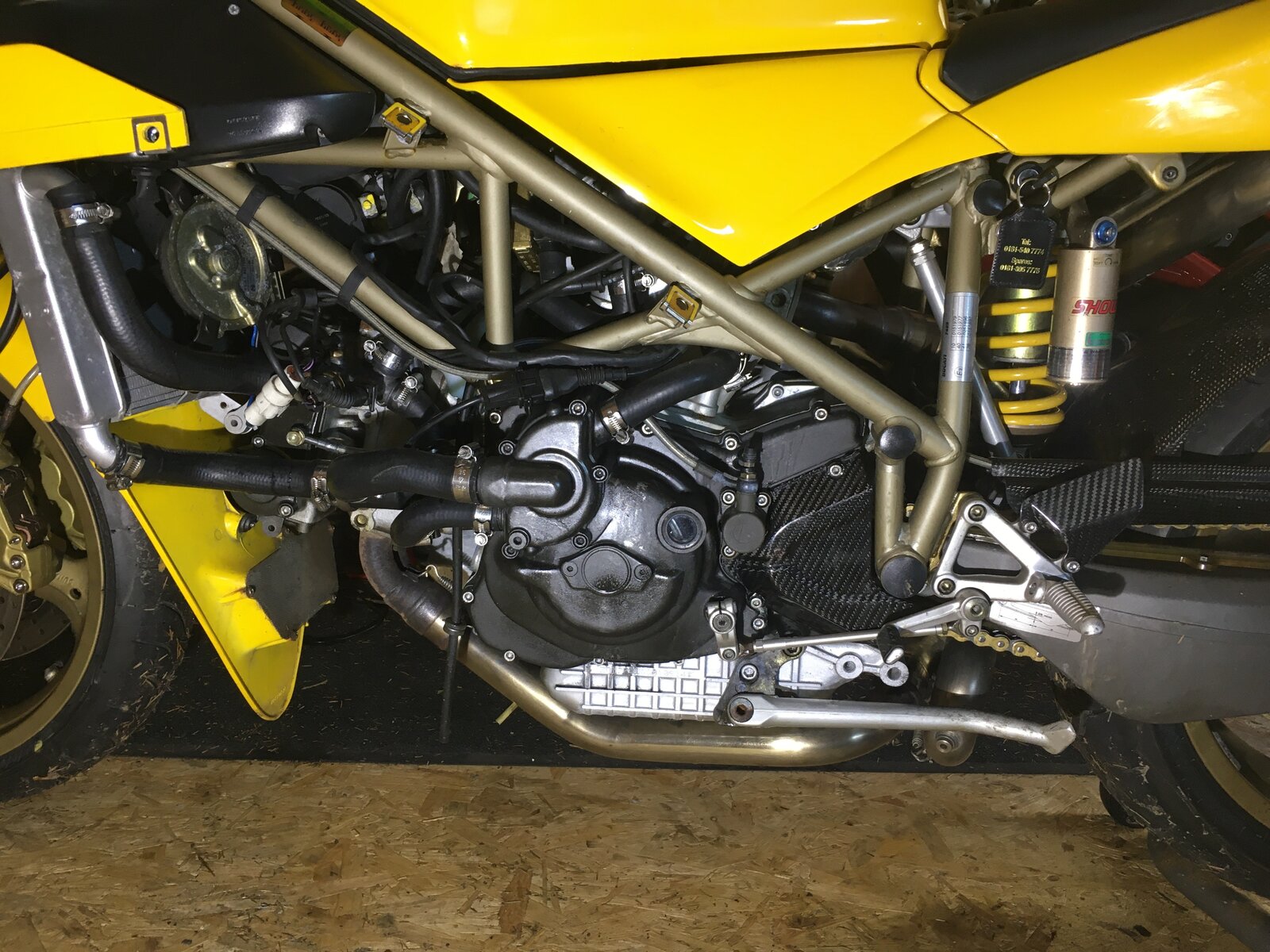

  1. I am re doing my flaky engine cases and sump. What have you guys and gals used? Blocks and cylinders appear ok ish so I shall leave those. 2002 ST4S mat mid grey in colour
  2. I used Simoniz Engine Enamel on my 748 sump & crankcases (but not the crankcase covers). I used an ‘aluminium’ colour one, it may come in other colours, so far, so good. :upyeah:
  3. Xylan coating is my preferred choice. Lots of colours available, quite cheap and it doesn't flake..
  4. Xylan coating is my preferred choice. Lots of colours available, quite cheap and it doesn't flake..
  5. Thanks guys, I looked at Pauls's photo and thought thats black !...OK Sump looks a good match
  6. Hi Johnny, I meant the sump.
    The crankcase covers on my 99 748 were a dark grey (looks more like black in the photo but it’s not) I matched it by using Zinc Phospate and lacquer.
