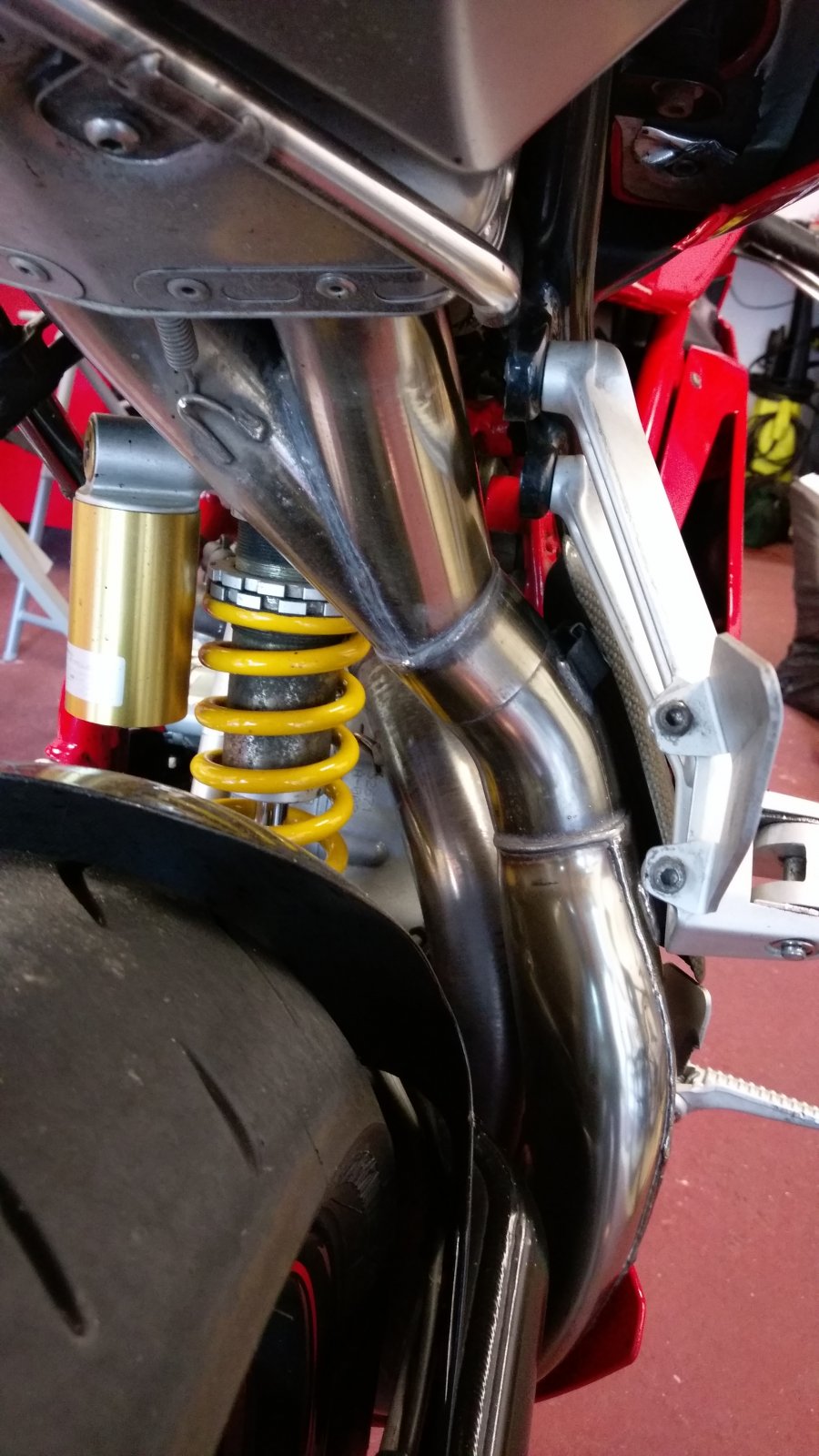

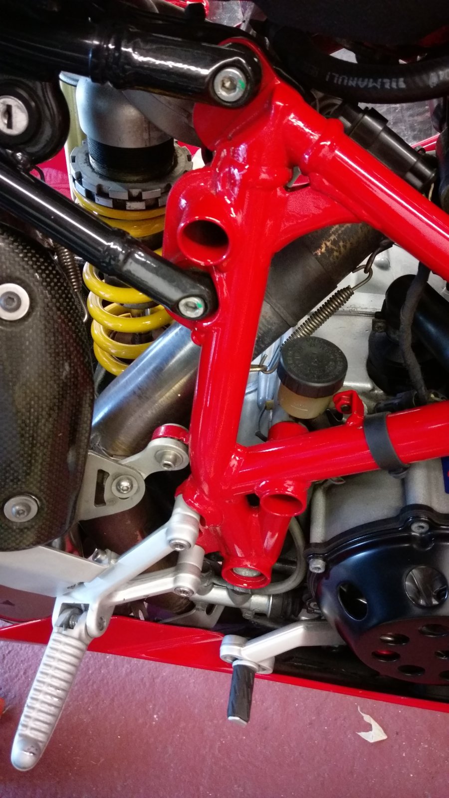

    It's the full system from the head's I think it's 54mm , both pipes go underneath then it returns up around the outside of the swingarm ( like a big banana lol ) , up and under to the silencer .
    Any ideas or advice on sorting it out would be great .

  7. Ecu info and pics of pipe work
    ECU modelnumber : 28640851H
    Hardware Version : IAW5AMHW610
    Hardware Revision : 00
    Software Version : 2218DS29
    Software Revision : 0000
    Homologation n# : 5AMBQ
    ISO Code : B0 0C 00 02 BF
    Tester Code : DUC
    MFD : 20 04 11 23
    Serial n# : 4KMCT44BE
