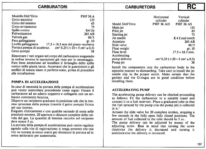

    A previous owner replaced the original 500 barrels and pistons with a 650 set from a Cagiva Alazzura. In rebuilding the carbs I found I have a 140 main jet in one carb and a 135 main jet in the other.
    I would like to check that the PHF 36's have the right jetting for the Cagiva Alazzura barrels; can anyone tell me what the standard Cagiva Alazzura carb jetting/set up should be?

  2. Many thanks Rick, this is exactly the information I was looking for.
    It seems that my carbs are jetted to Alazzura spec's. I greatly appreciate the prompt reply.
  3. Strangely the settings for the 500/600/650 are almost the same . any variation will be down to fuel quality. the tables were most written in the days of 4 star leaded fuel and the modern ethanol fuels run a bit rich so you may need to go down a step on main and possibly pilots but see how you go.
  4. Thanks Paddy. Interesting that the jetting appears identical over a range of displacements. The engine last ran about ten years ago and the plugs looked to be on the slightly rich side when I pulled them. I don't know if the last owner just ran the bike for a few minutes on the choke, or took it for a decent run on the road. I will have to see what the plugs will look like after a proper ride.

  5. I have never found a need to run difference jets front to back TBH. on Bevels or Pantahs and i dont think Ducati did.
    this is 500/600 Pantah 107.jpg .
  6. Thanks Paddy. I must admit I was a bit mystified regarding the different main jets that are currently installed. I think I will drop the 140 back to a 135 and see what happens. Thanks for the advice, much appreciated.
  7. BITD my old 500 Pantah ran different sized mains. Can't remember the specific sizes but both were bigger than standard (it was breathing through K&N pods and a 2-1 exhaust) and the one the rear pot was also a size up from the front. I believe the thinking was that it helped the rear pot run a little cooler, matching the front which is more hung out in the breeze.
    IIRC it was the same on my 900ss (also on K&Ns). Might make more sense on bikes that aren't half faired...
    Whatever the reasoning, both bikes ran fine and my thinking was "If it ain't broke..."

  9. I ran different jets sizes in my 600 pantah, this was set doing an old school plug chop at the end of Longniddry dual carriageway so would leave as is. Sam
