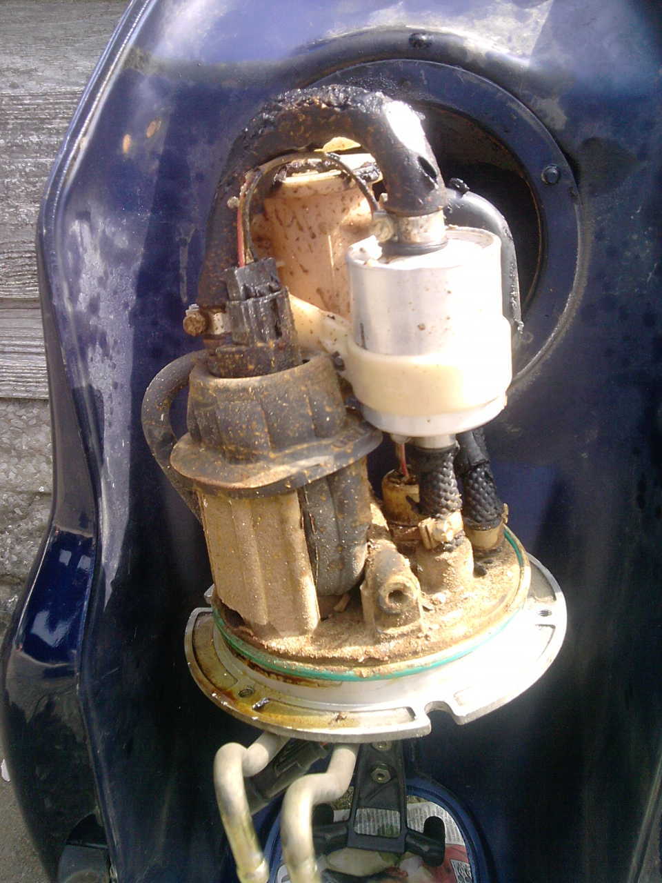

  5. Thanks for the replies folks , and also the welcomes !
    Update
    ( I'm not very good at taking and uploading pics , but I'll have a go )
    After connecting a battery there was no fuel pump priming sound
    but there was power to the tank , the fuel gauge worked ,
    and all of the other electrics looked good .
    Took it apart and found that the outer covers of the 2 big rubber tubes had
    completely melted and they looked like graphite grease !
    Not surprising that once removed , the pump wouldn't run
    in either direction .
    I tested with a meter before powering it , and it's about 2.4 ohms ,
    so it's not burnt out and it's not a dead short , but it ain't spinning either !
    I'd renovated the tank at about 50k , maybe eight years back ,
    when it started to leak at the bracket near the seat ,
    and that seems to be a known problem on some models
    ( I'm not scared of a bit of fire .... but not in that area thanks ! ) .
    I used a fuel resistant liquid sealant inside and put in a new O ring and fuel filter .
    Then made some small rubber blocks to take the load off the rear end
    of the tank , and it had been fine ever since .
    I've been looking up some pump prices ,
    starting with silly pounds and 99 pence for " original " .
    Thanks to plenty of reading on this forum , I see there is a quality replacement
    for a 100 squid or so .... from Exactuk.com
    The cost of those pieces of tube soon mounts up though , and the pre-shaped small ones
    would be hard to make from stock fuel-line off a roll , without getting kinks .... or not ?
    Has anybody ever tried it ?
    How about trying to free up a seized pump ?
    I'm thinking of soaking it in a jar of clean petrol for a few days .... can't make it any worse !
    Like yourself Harry , I have faith ...
    .... but I had no luck on this occasion .
    #5 oldtech, May 27, 2019
  6. Looks a bit worse than ideal :eek:
    I believe you can bend fuel hose tight enough without kinking it (I'm sure this is what the factory would have done)
    I assume you tried 12V direct to pump to confirm it is not well - if you get all dash lights up and no fuel pump prime the first thing to check (link out) is the side stand safety relay - the yellow top one under LH fairing. These are known to go dodgy and unless you are really worried about riding off with the side stand down it's best to link it out and chuck it away
