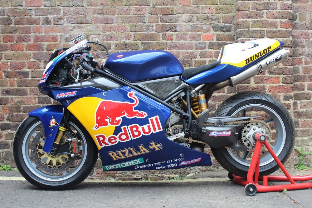

Not sure if DUC UK or Reve Racing did the replica's - deffo not factory. This is an original RS996 from 2001 so I would think the reps would have used Micron Exhausts too - someone must know about these
there’s a discussion here, which meantions the Reve racing redbull bikes http://www.ducatisportingclub.com/archive/index.php/t-14194.html Considering they are, by the look of it, 996BP base with a few trick bits what is one worth now low miles and good condition?
Too rare to price by previous sales - but not much more than standard as they are not official bikes. Same as the Airwaves 999 bikes - they are worth no more than a standard (but the graphics / paint design isn't liked by many) the Red Bull may be a little more popular I guess though.
