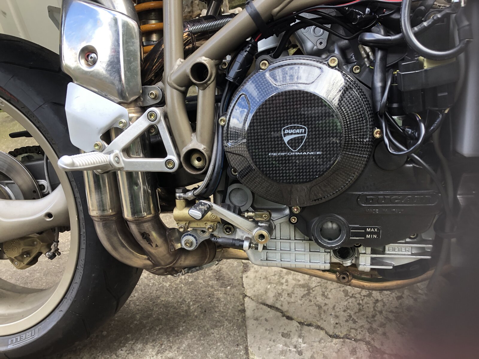

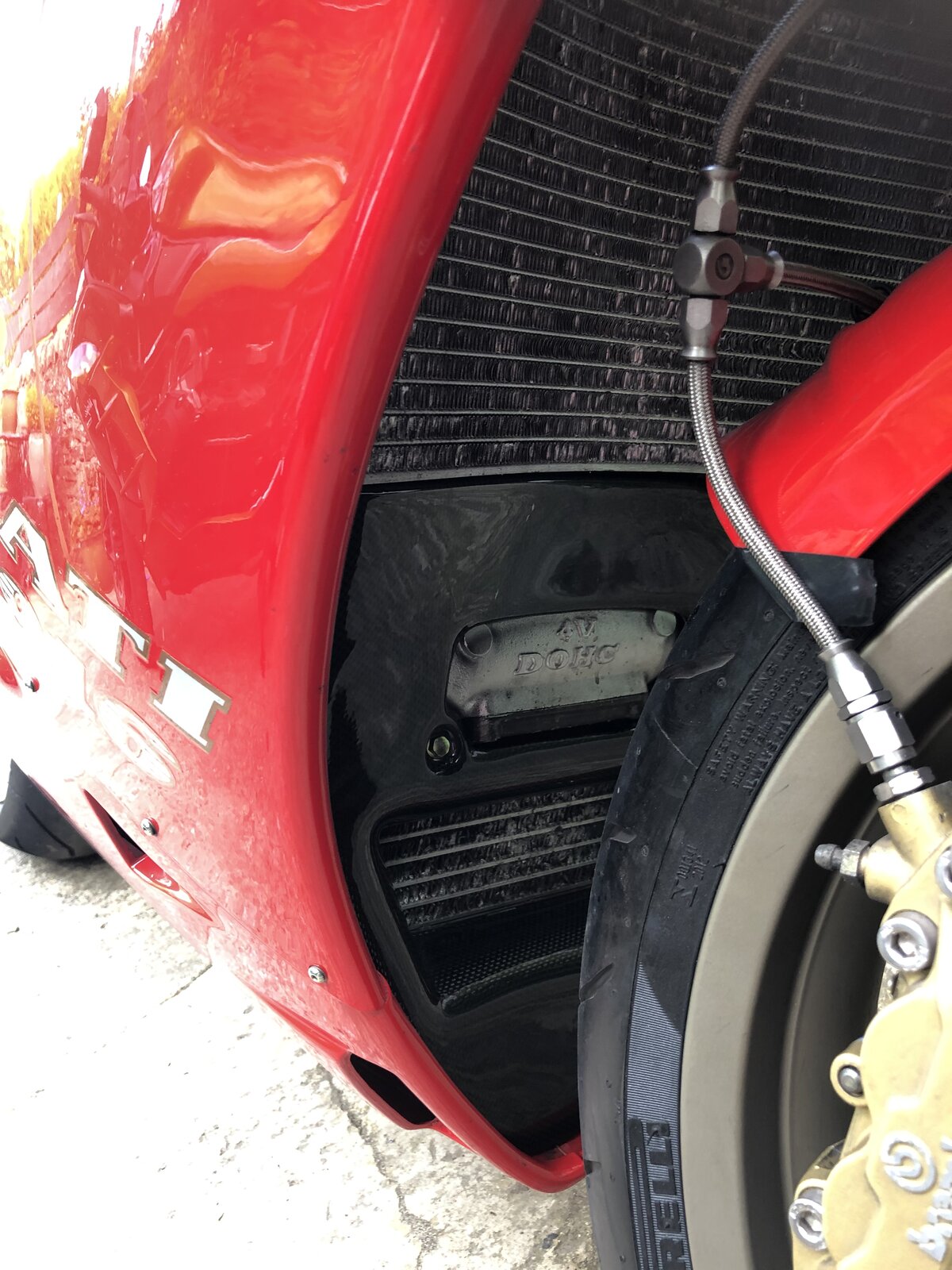

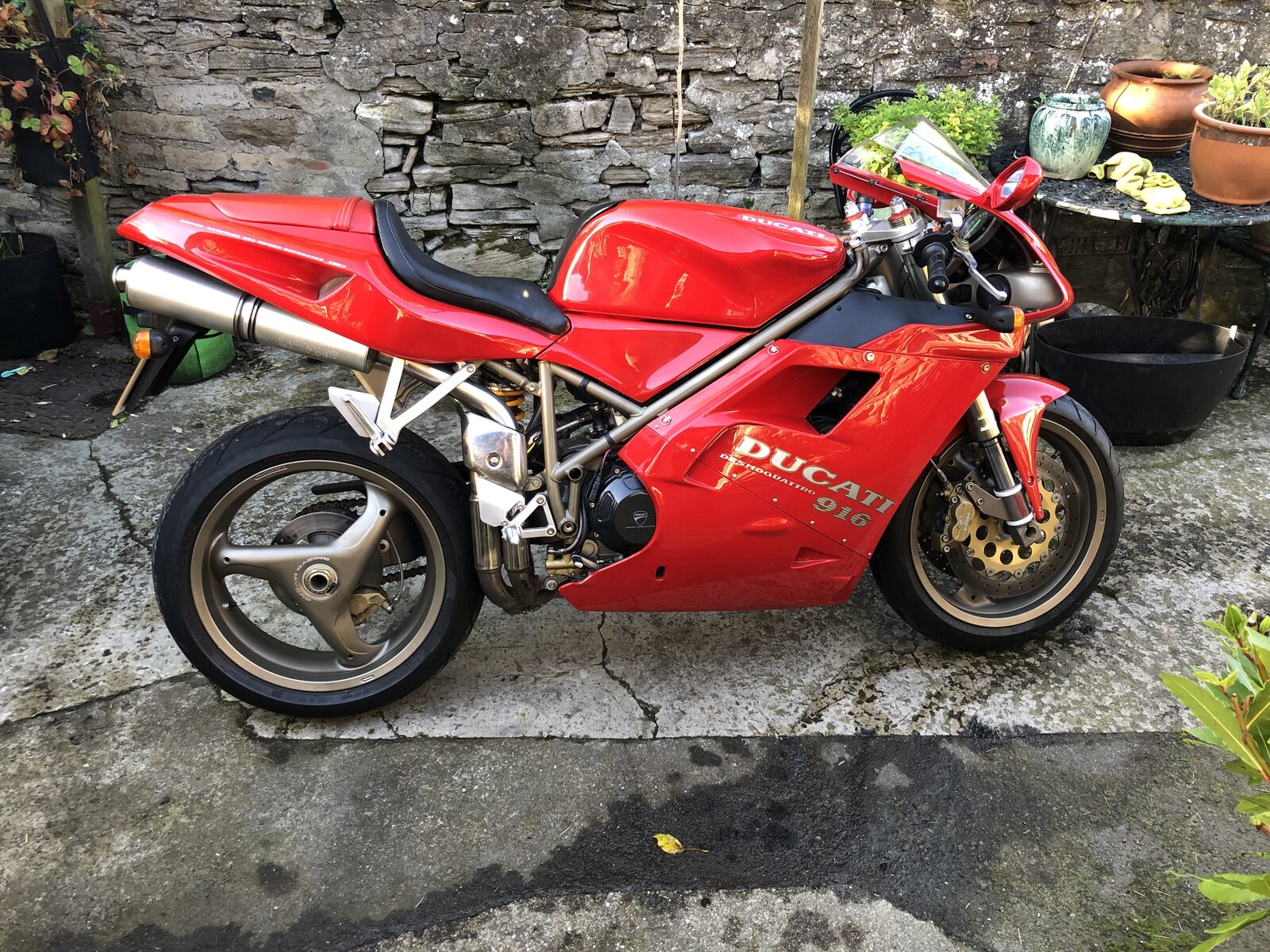

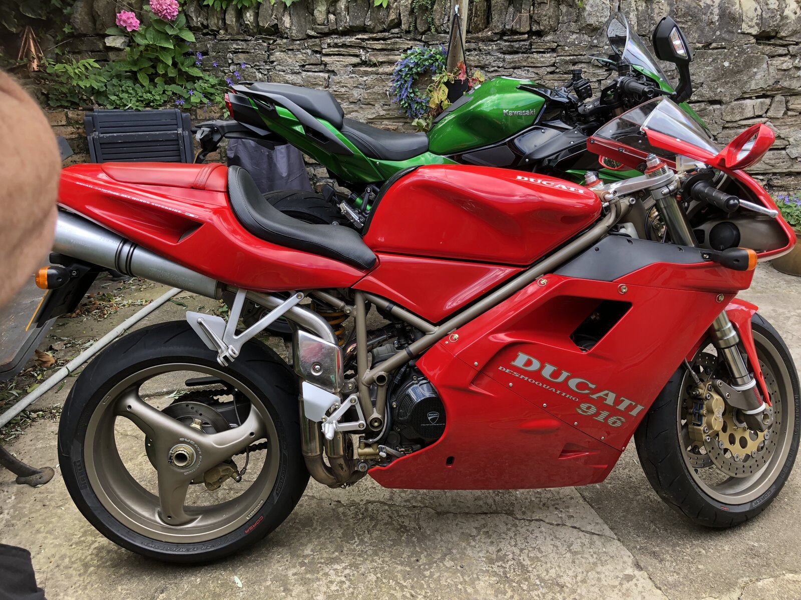

  1. D44ED4A2-CFCD-4AD5-B469-DA26EAD60236.jpeg 7BFFF1FC-D0DF-4C05-8ACA-A3799929BBFB.jpeg 9504EFA3-6E19-46E5-B5BA-98638F1B94DD.jpeg 867249AA-473E-40E5-84D5-AE785875B2FC.jpeg I’ve had my rose tinted specs 916 for a few months now & it’s done it’s very best to dissuade me from wanting to try to ride it any distance as every time I’ve tried something broke etc :/ whereas my old 916 only had a reg/rec failure on the day I sold after 5 yrs ownership. Anyways I’ve treat it to some bling:tartup bits in the hope she starts to behave a bit better (fingers crossed). Bling bits added
    Red mirrors (not sure ? Too much red ?)

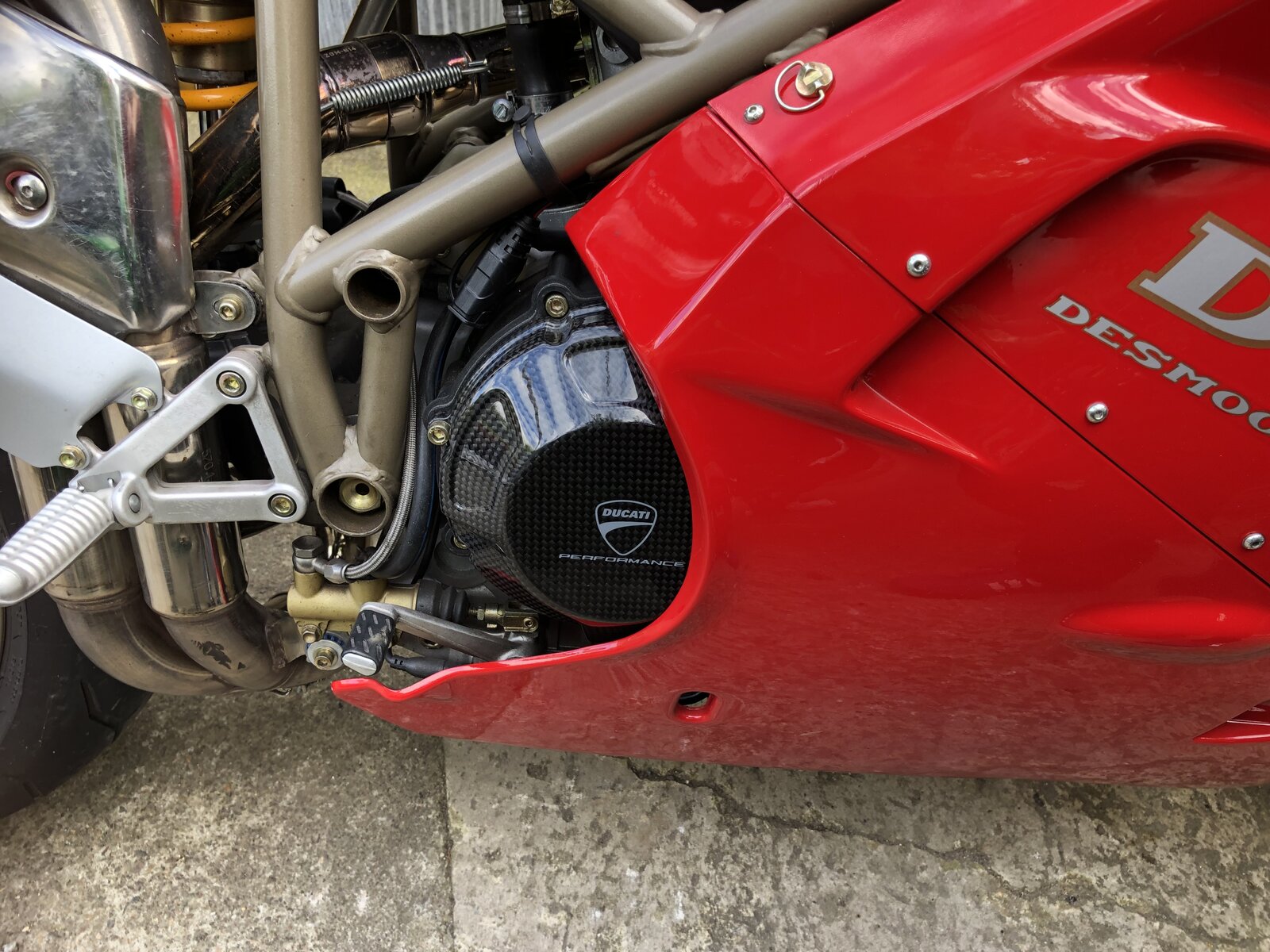

    Duc performance carbon clutch cover. ( wrong era logo font buts its my fave clutch cover shape - duc street fighter style)
    Carbon front v panel to save the nice red one it has from road rash.
    Corbin saddle, it’s a monoposto one but it still fits and at some point I’ll fit a monoposto tail to match plus its more comfy than stock saddle .
    Red duc pressure plate (can’t see it as cover not vented)

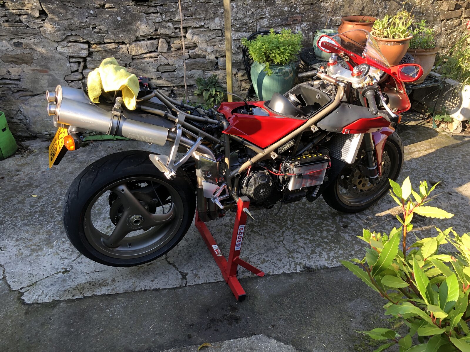

    Gear shift fell off as bolt came out on a ride, fixed at roadside by stealing a bolt out of front fairing mount until i could sort properly at home. PO failed to tighten?

    Clutch lever went v-soft then solid on a ride leaving me with a locked clutch I couldn’t disengage! I managed to get it home without stopping and stalled it on the drive. Issue was clutch hub nut had come undone letting the outer clutch plates jam the basket!!! Pressure plate spring washers had scored inside of original cover amazing it got me home! I suspect PO failed to torque up hub nut properly during their strip / refresh. I refitted clutch and torqued to upper spec from manual as well as going over as many fixings as I figured could kill me if undone on a ride with the torque wrench.

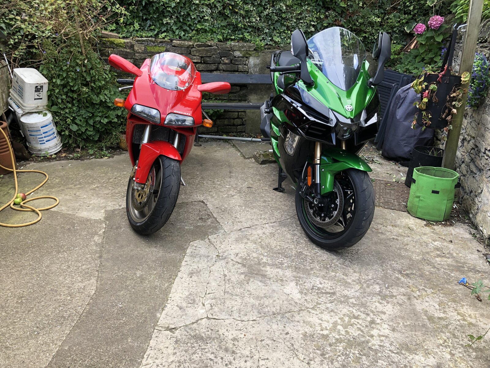

  3. Just took it for a short spin out and nothing fell off so that's a plus and it felt fekking lovely after riding the big bus that the H2SX is .

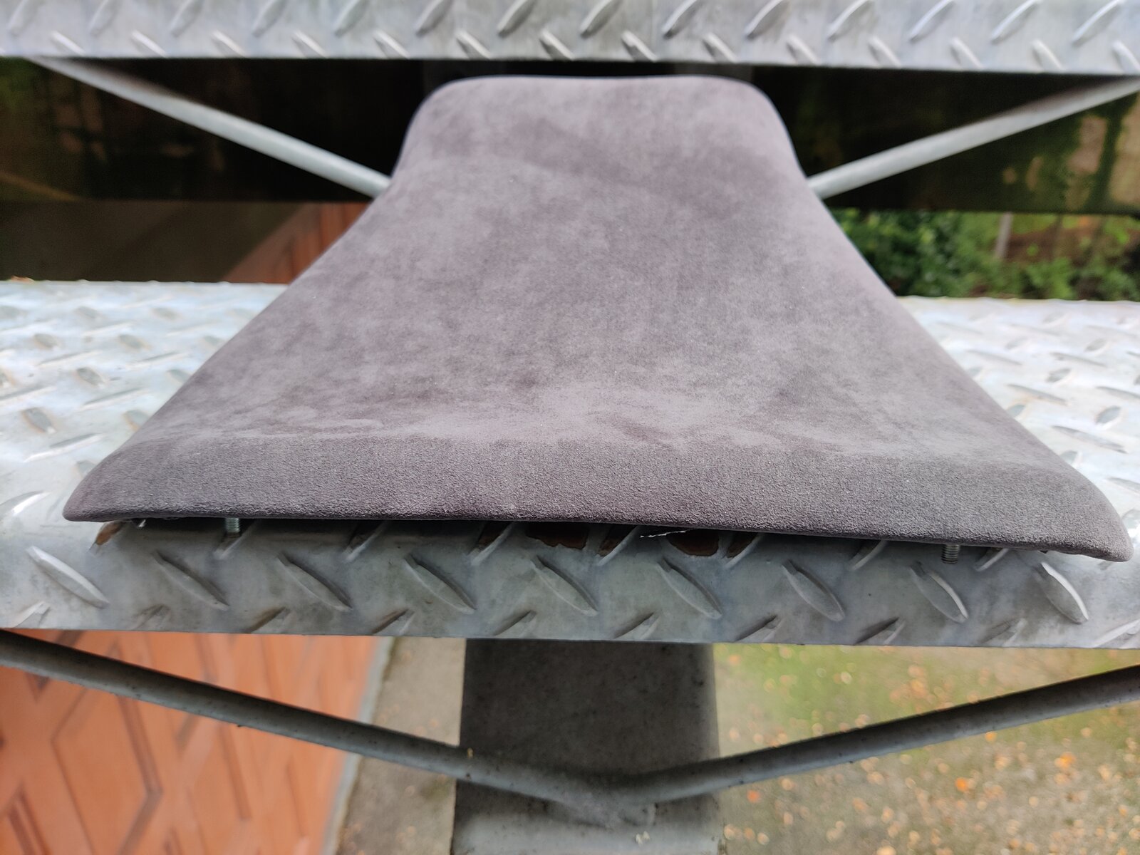

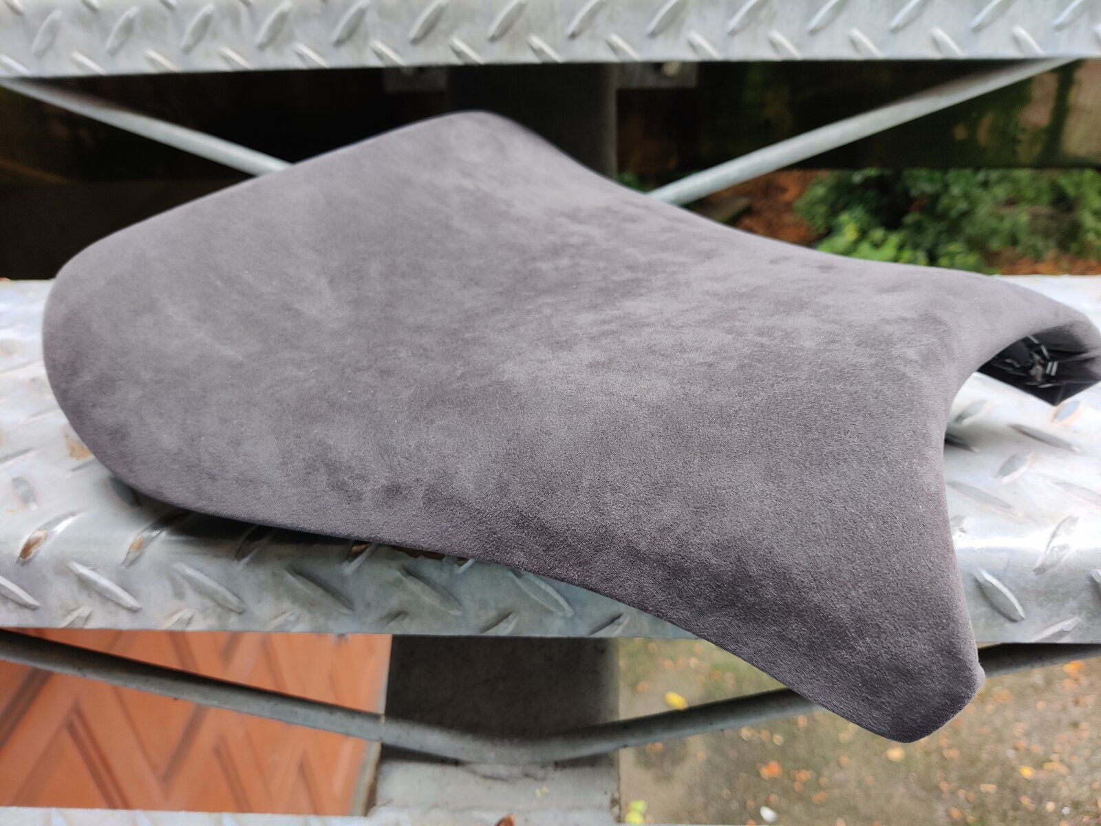

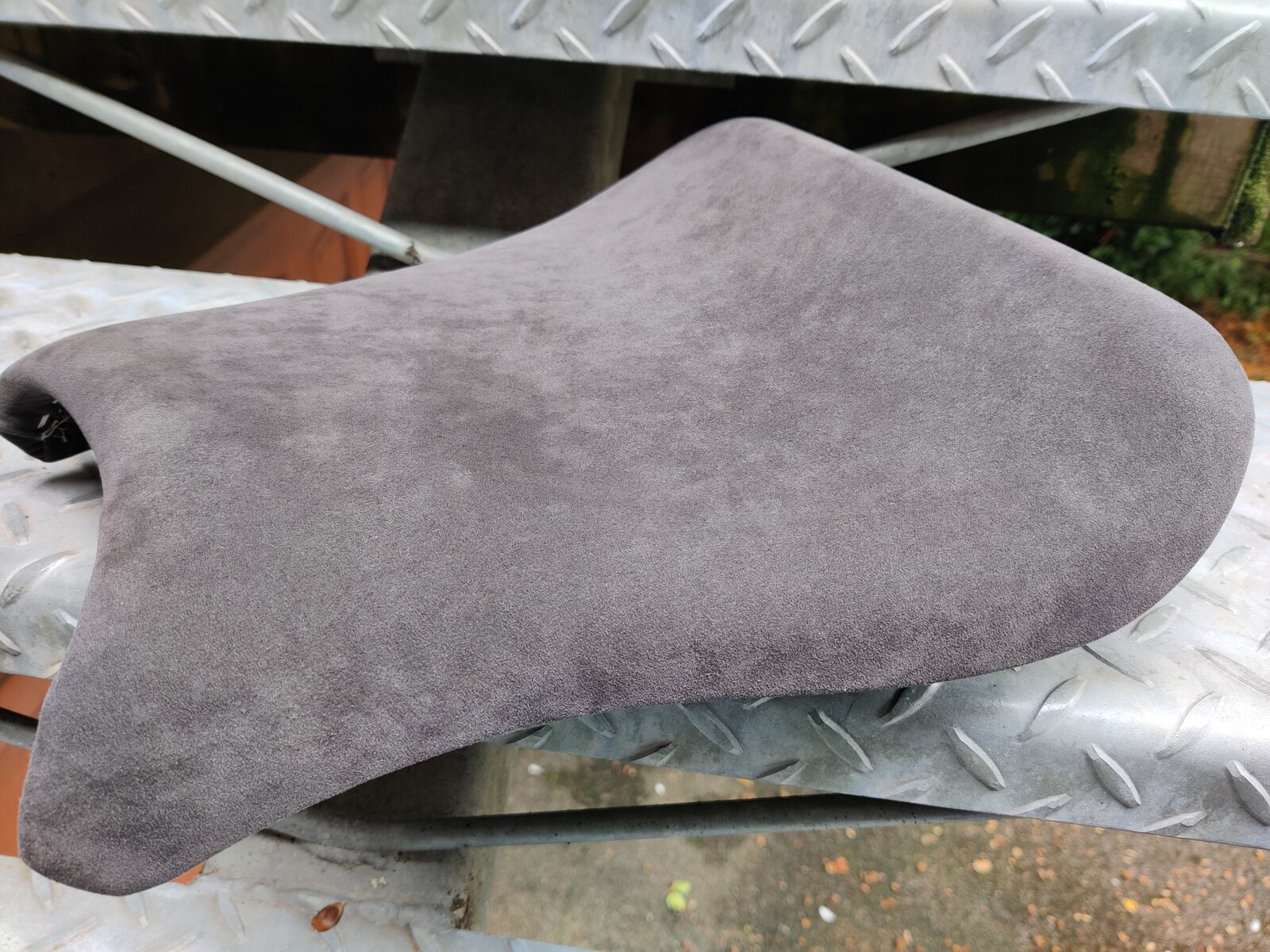

  4. Looks good, Macca. I've got an OEM Biposto pilot's seat re-covered with grey Alcantara if you'd like - never been sat on. It would go very well with your red pillion seat. IMG_20210930_125958.jpg IMG_20210930_125946.jpg IMG_20210930_130011.jpg Make me an offer?
