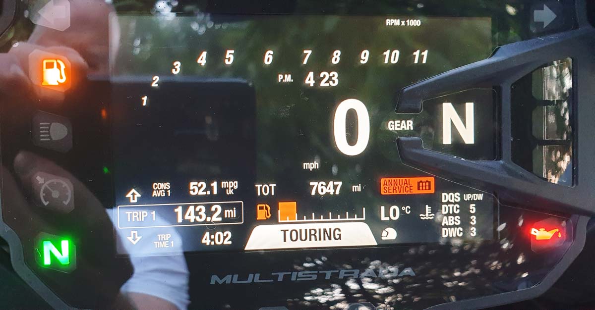

  5. Like this
  6. Think it's supposed to be a calendar, indicating that the service is due , time related (ie, annual) rather than mileage related.
  7. That’s a different display to mine but yes, I also have a smaller red thing next to the service one, presume it tells me how many days I am over, but only having done just 3.2k miles this year it can wait.
  8. As I can't ride as much as I would like, the annual service came up with only 4,500 miles and I did myself, engine oil, filters, brake fluids, pads checks, general inspection all over after a good clean, reset the light by changing the date on the dash back 1 year and worked fine.

  10. Back to the original post re the Red calendar on the dash, I read somewhere (might even be on here) but changing the YEAR in the time date settings gets rid of it...tried it on mine the other day and success, no more red blobs all over the dash, cheap and easy to do and should get properly re set when it has its mileage related service :)
