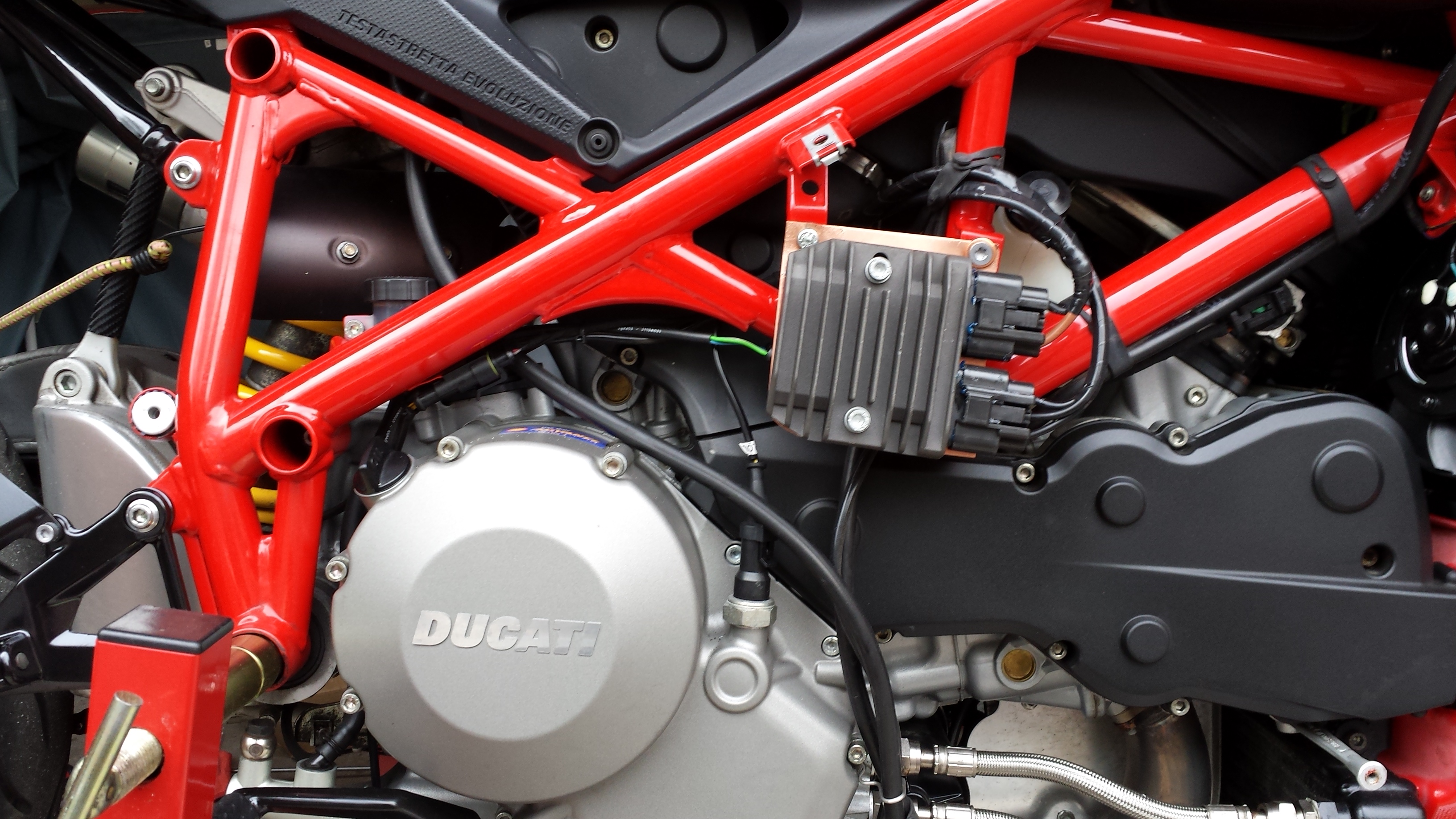

  1. Thought I'd share what I've done to the bike today.... Original Ducati reg rec died last season & I went with the R1 mosfet / Triumph loom modification... Installed it where the original rec lived but its a concern that even though the Mosfet runs a LOT cooler its still not an inspired choice by Bologna to put it next to the downpipe... So... Where to put it? I've seen a few idea's but I've chosen somewhere I've not seen before (I think)... Anyway, ChrisW has already flashed my ECU to DP & in doing so disabled the exup motor... & thats where the rec has gone...
    Copper plate from Ebay.. Go for 100mm / 100mm
    1.2 mm 18 SWG Copper Sheet / Plate See Size Variations Precision Guillotine Cut | eBay
    Screwed into the exup motor holes & the Triumph loom needed extending by a foot.. Remember to use the same gauge wire & pass it through the frame past the expansion tank..
    It all fits nice (proof below) & I'm happier knowing the reg is cooler

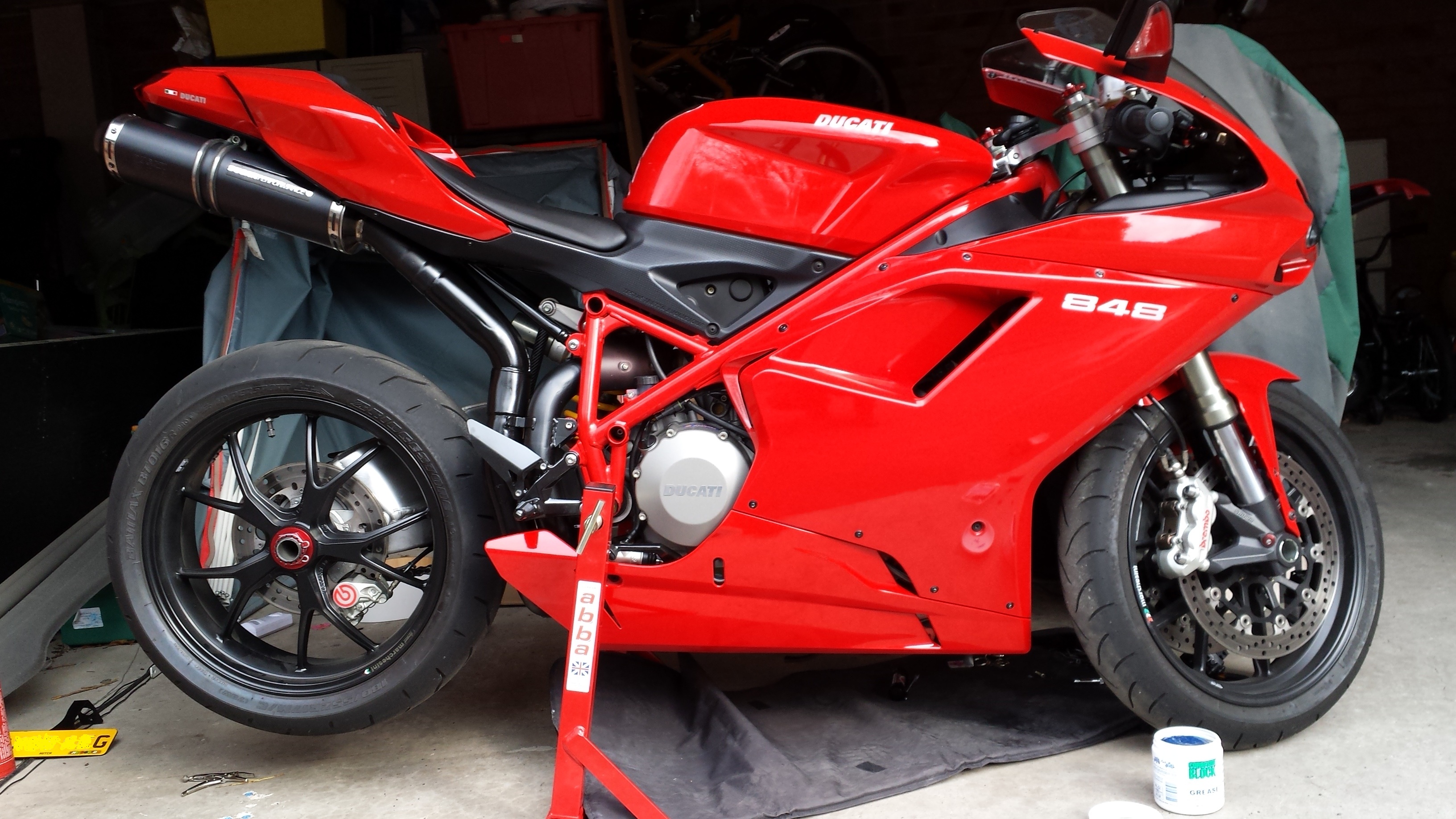

    red spacer (?) on the hub looks well :cool:
  3. Cheers bud, not overly confident it will stand up to the abuse of wheel removal though... The alloy is quite soft & more looks than fuctional
  4. Good solution and the pics are a really good quality :)

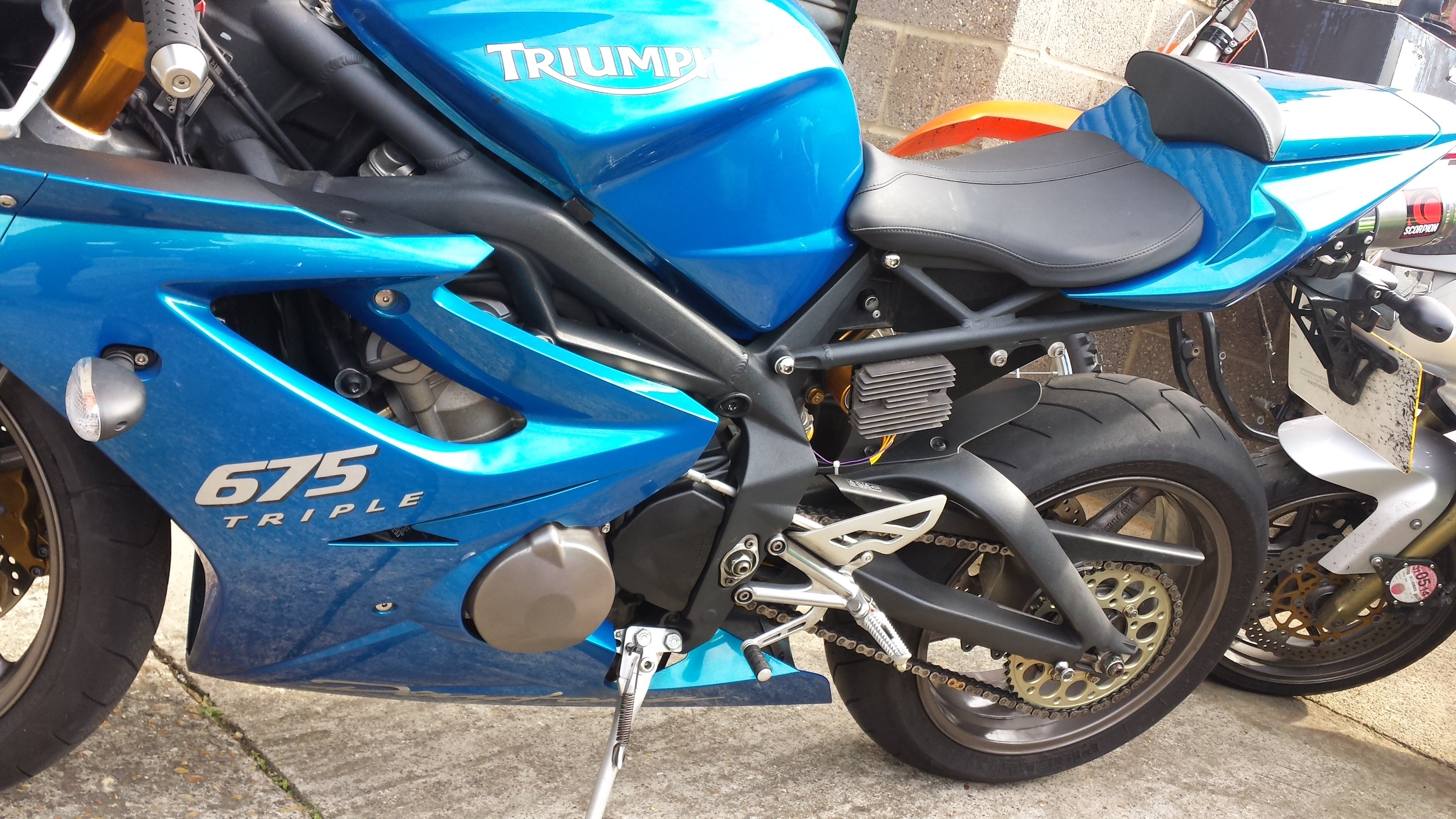

  6. I went with copper as it still conducts well & it was cheap enough... The mosfet runs a hell of a lot cooler anyway so coppers more than sufficient... As for keeping it in the fairing where it sits now still has much better airflow & its invisible plus I wanted to extend the loom as little as possible to avoid electric resistance in the wiring.... Funny.. I was at BSD yesterday getting her belts done & a custom map for the ECU... Spotted this 675 below.. Seems the italian bikes are not the only ones suffering the issue.. Not the tidiest soloution though..

  8. The Daytona 675 was subject of a Worldwide recall for the R/R. Triumph supplied the better Mosfet ECU, a mounting bracket and wiring loom (fitted free). Looks like this bike has slipped through the recall.
  9. I see..At least Triumph acknowledged the issue & dealt with it correctly... A heatshield & rec check recall imo is not enough.. The components used are just not up to the job
  10. The 2009 triumph daytona moved the reg rec up to in the right hand air gap by the radiator. Previously it was down on the back of the engine case by the rear shock which is stupid! My bike did 5k miles not missing a beat. The placement on the 848 is truly shocking! With no fairing I can barely see my reg/rec, it must just get cooker
