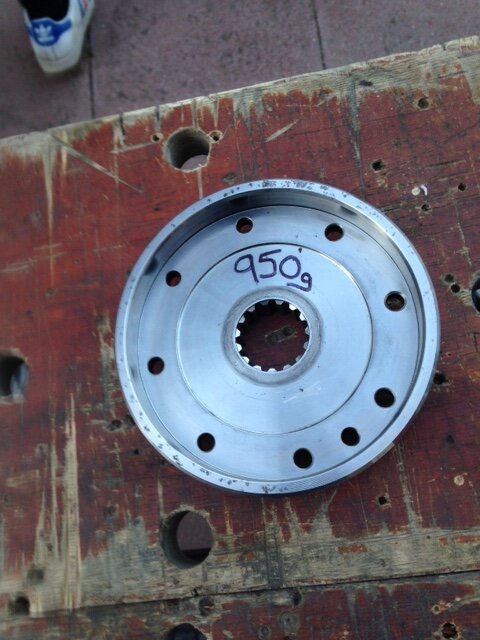

  10. I've just had my one done...

  13. I might have the piece of paper with the weights of the gears and f/w that were lightened written down in the garage. I'll have a look tomorrow.
  14. The standard f/w was 1870 grms .. I was offered one that was 745 grms but the mounting boss was different.
