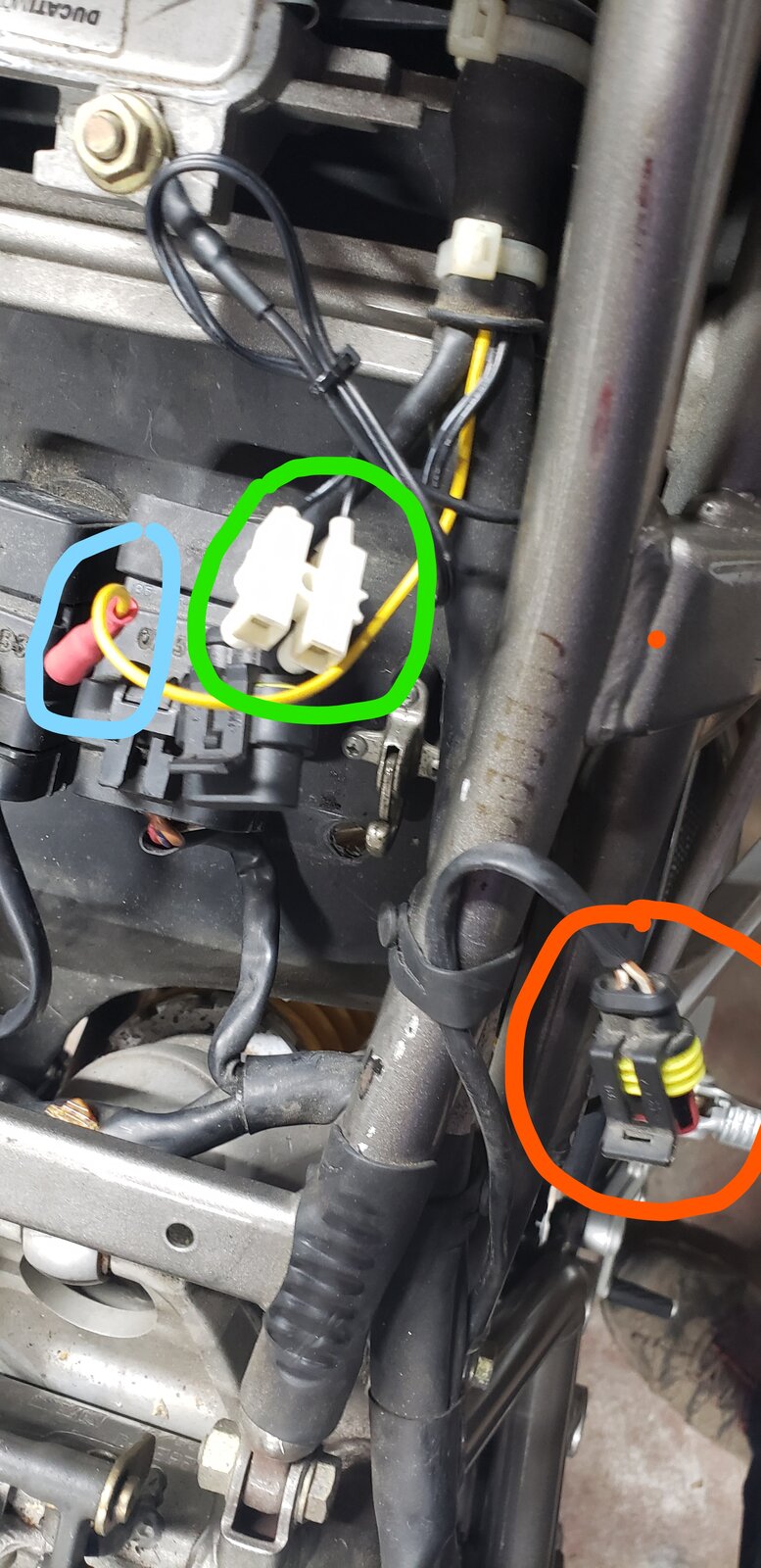

    This alarm from 2003 keeps causing issues with starting etc.
    I insured the bike without it and want it gone.
    The alarm had the following connections:-
    - multiple connections to the rear indicators. Removed and indicators function normally.
    - a looped in connection to the starter solenoid. Removed and orginal connection rejoined. Bike starter works.

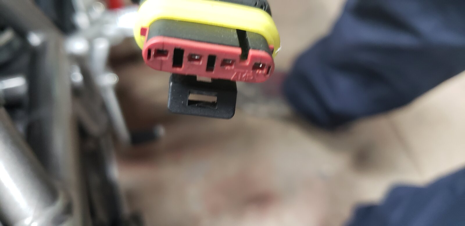

    - a cable plugged into the main loom. When the alarm is removed the residual connector is circled red in attached photo. There seems to be nothing to connect it to
    Not conected to the alarm but loose are a yellow wire and a white connector circled blue and green in the photo
    The bike cranks, there is a healthy spark, the fuel pump does not make any noise but both realsy by the CPU click in.
    Ideas?
    Thanks
    Nick

  6. Are the two wires into the connector circled in red the same colours? They look Brown/White. If so they probably need linking.
  7. I'd check voltage at those (clearly DIY additions) two with ignition on & off. Perhaps one is an 'accessory' 12V connection so may be worth keeping...
  8. Wiring colours could be different, but on my 98 SPS the Brown & White wire is the fuel pump live feed.
  9.
  10. Thanks Gang
    I linked the 2 wires that were brown and white in the red circled connector and the bike is perfect. I guess than means there is normally a plug in that connect them.
  11. That connector is a Ducati wired one for an alarm. They would normally be bridged inside the alarm with the bridge open/closed depending on alarm status. You’ve done the right thing by bridging them :upyeah:
