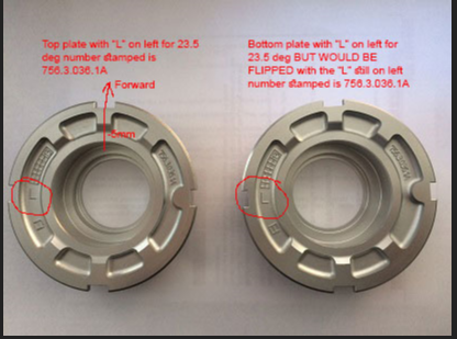

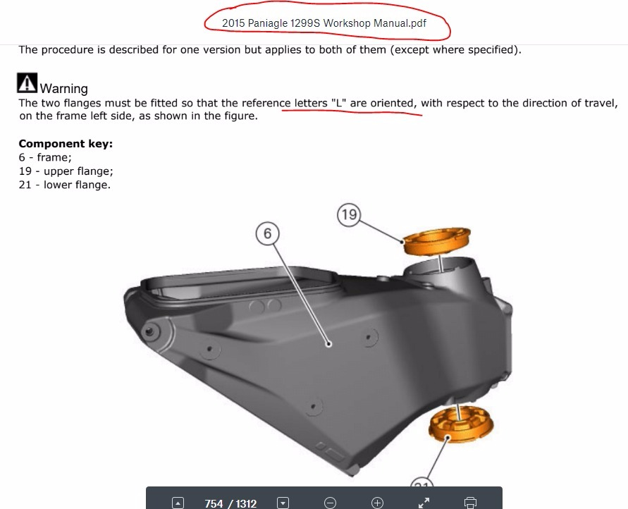

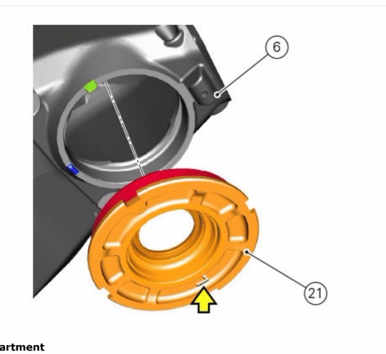

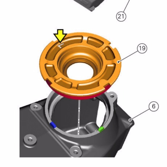

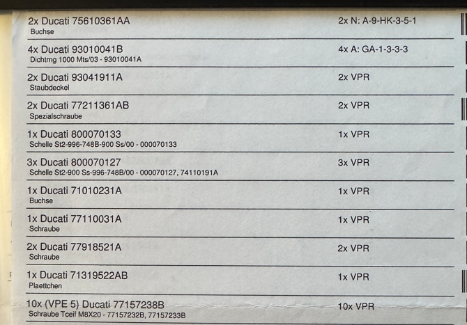

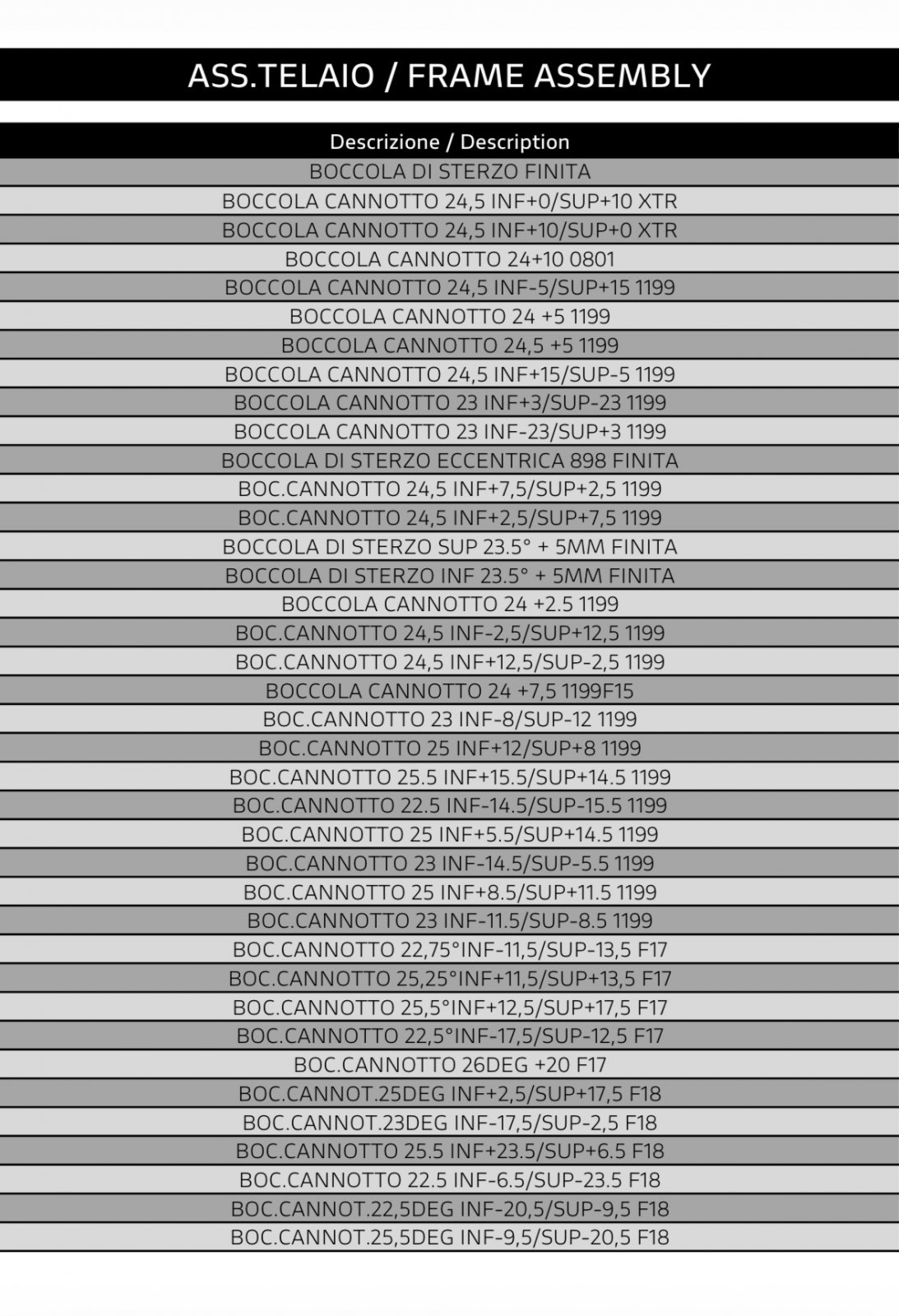

  6. Can anybody confirm which way round the 1199R plates go into the frame - been looking for a 1199R workshop manual but cant find one easily..

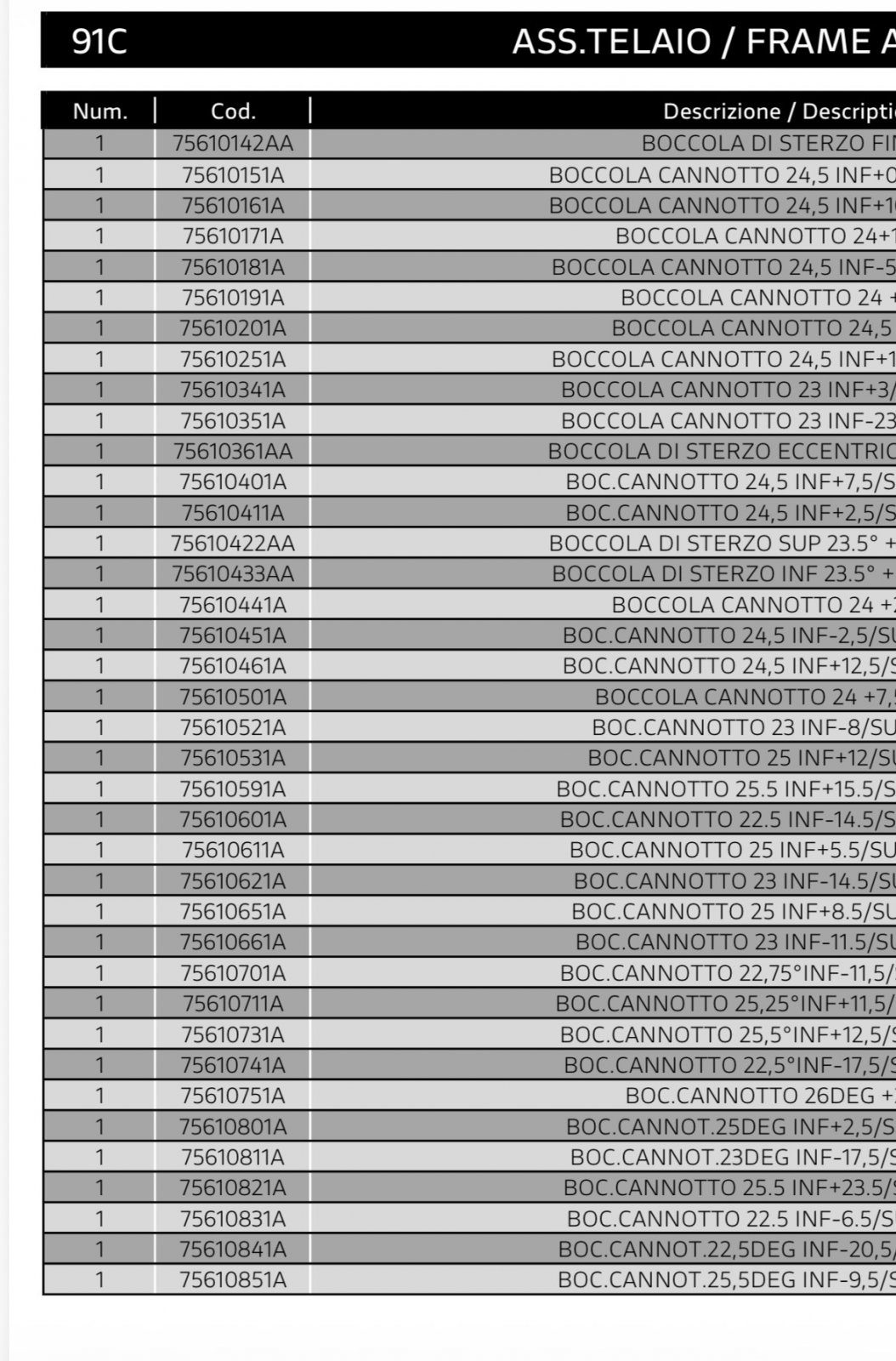

    These are teh parts ordered fromMoto Rapido an don invoice it states..
    75610361AA part ordered
    STEERING BUSH OPTION 1199R/899
    24.5 deg 5MM = L MARKING ON RIGHT
    23.5 DEG -5MM = L MARKEING ON LEFT
    So i am assuming....sitting on bike facing forward..
    Top plate goes with "L" to the left which would move the top yoke forward 5mm
    Now for the bottom plate ...
    If you flipp the part upside down with the "L" still on the left , then the bottom yoke would come backwards the 5mm
    Thus giving the 23.5deg rake
  7. I think this confirms what i thought ;-) its a 2015 1299s but same principle..
    So "L" rermains on left side of bike
