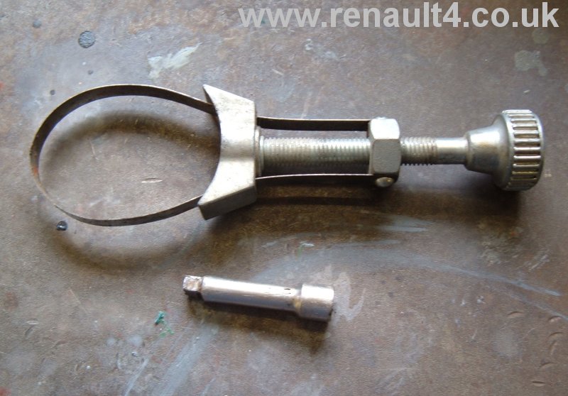

The one I use if it's a tight one is similar to this, it has a thin band which allows you to get on the filter and has never failed me yet...fingers crossed.
