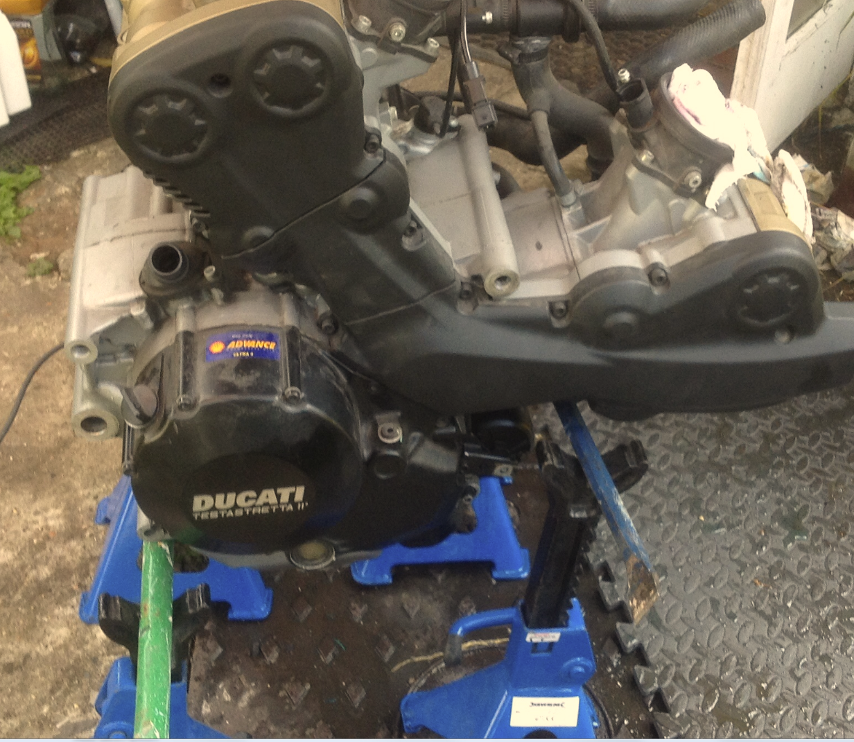

    Actually, too old for that. I do need to get the engine out of my 1198 though so do i need to buy a 1 ton hoist (£100 on eBay) or is there a simpler secret way to do it that is easier?
    Any tips? Thanks.

  2. Get two pairs of axle stands and a couple of steel bars mate.
    Use one pair underneath the front cylinder (either side), and the other pair at the rear of the engine.
    Undo the engine mounting bolts and remove the swingarm.
    Lift the (now light) bike off of the engine.
  3. Ps. Don't suppose you're flogging that engine?
  4. Thanks mate, will give that a try. Unfortunately not, i'm taking it to Glen at Moto V to be fixed, but thought i would save myself labour by getting it out myself.
    Got nice S4RS engine though, what are you building?
  5. That axle stand thing works a treat - done it tons of times.

  11. I also have an Abba stand with the SA removal adapters, a car trolley jack and a handy sized railway sleeper if you need to borrow.
  12. And 2 long lengths of scaffolding poles I use with ratchet straps to hang mine from the rafters (cue screams of horror........).

  14. Yep, axle stands work well.
