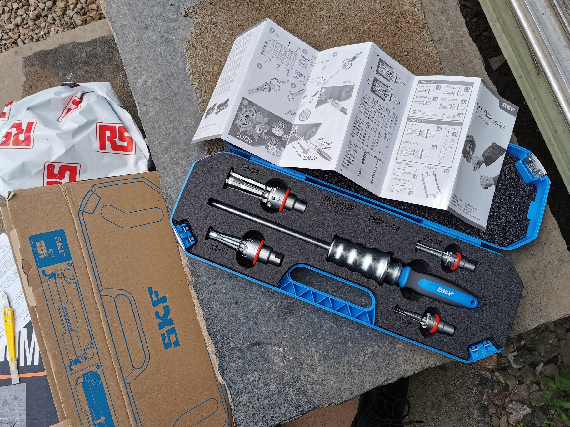

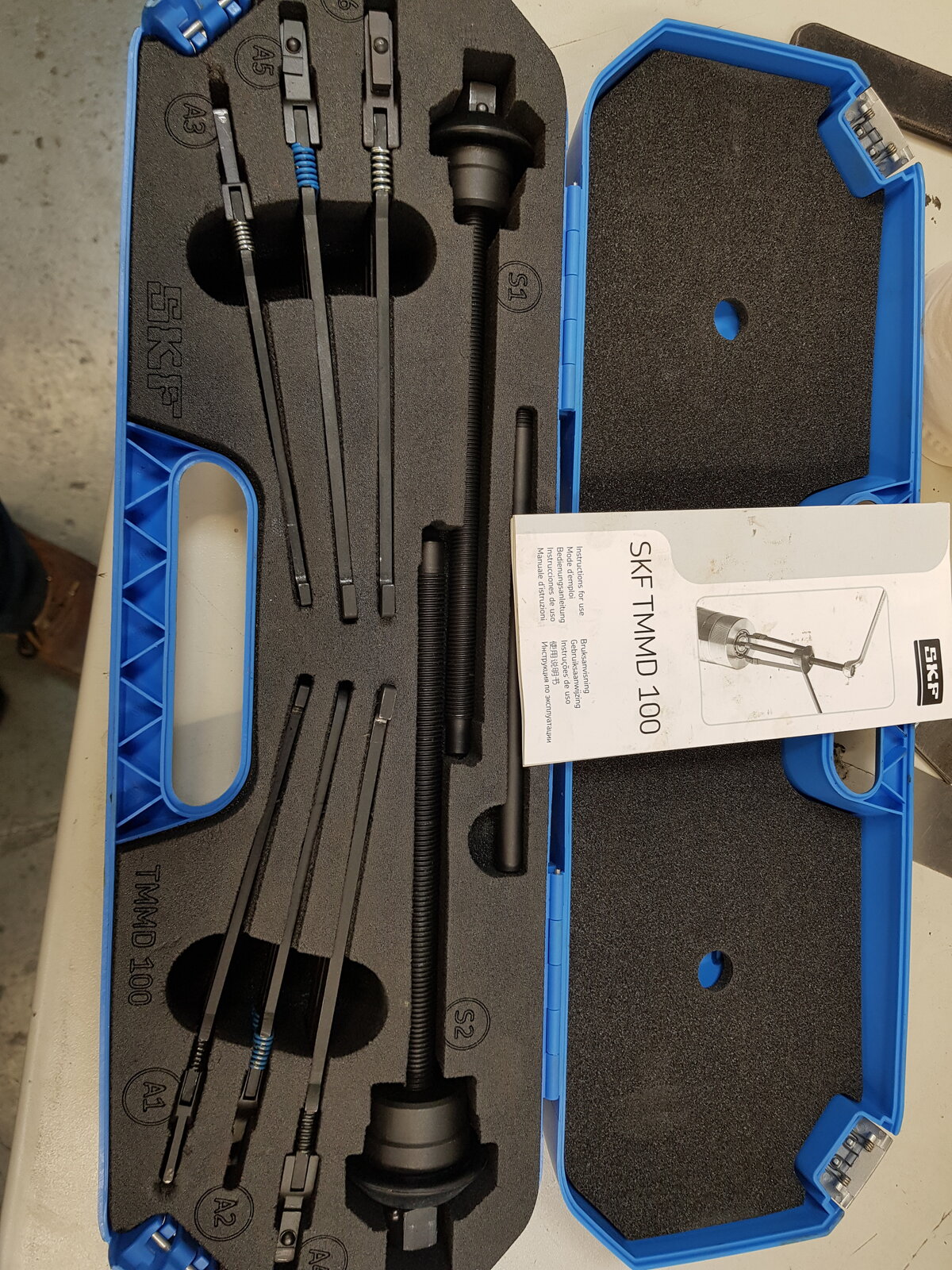

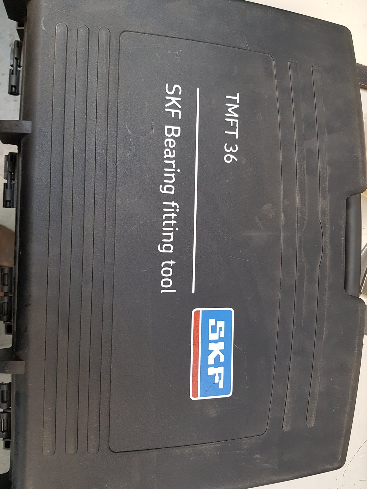

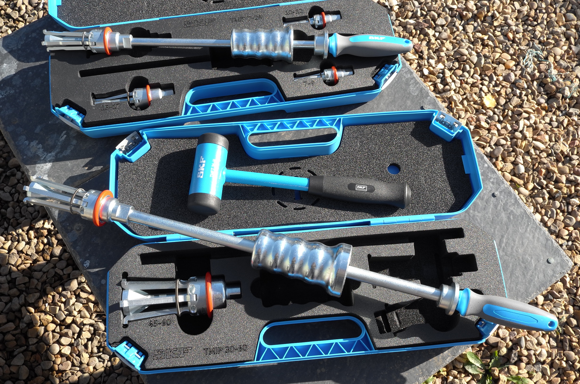

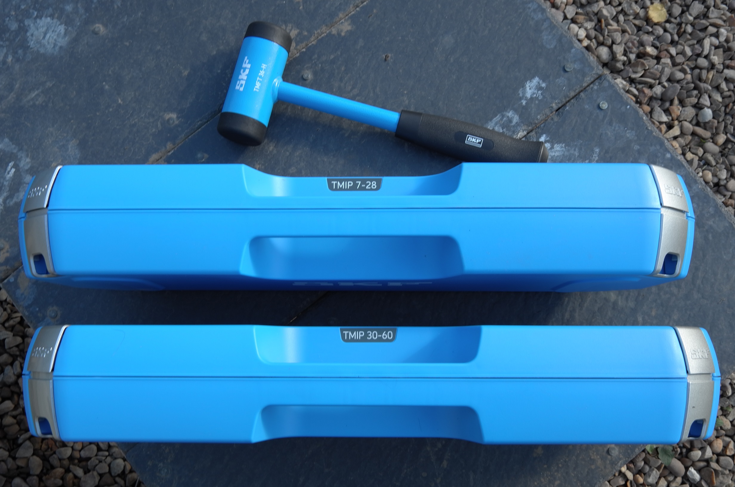

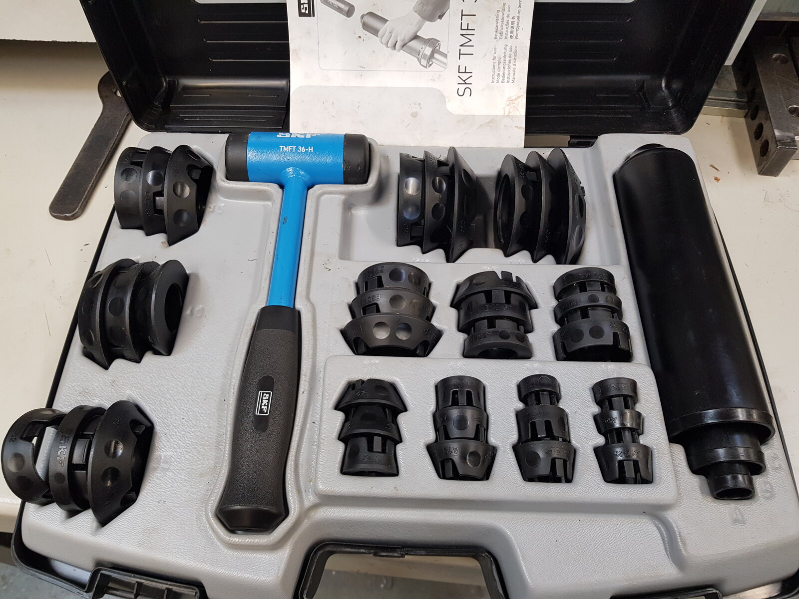

  12. Well the painful thing I did not share was that I actually needed the other kit also. These manufacturers love making it so you need the larger stuff for jobs. Bit the bullet & got a decent quote from RS components so too finish off my day. I'm chuffed to share these images'
    The SKF TMIP series 30-60 kit dwarfs the other one now.
  13. Ooh,
  14. I did briefly see the dead-hammer bearing seating kit,...now stop!! You could of waited to taunt me in 2021'
