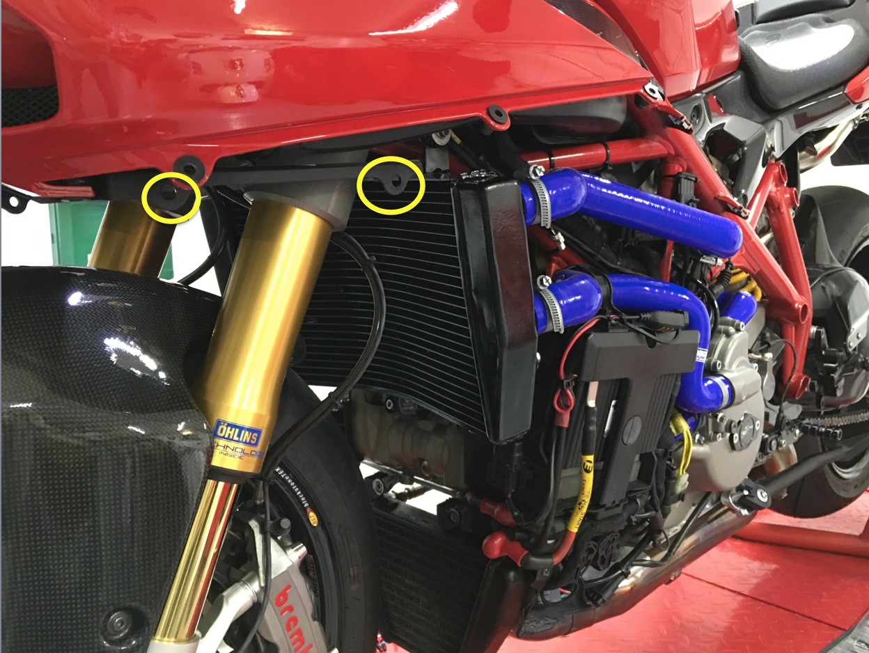

    I am trying to fit a battery optimiser on my 2009 1198s but when I remove all the fixings mentioned in the manual it still appears to be fixed to the inner headlight fairing. I have removed the one fixing underneath adjacent to the headlight. Am i missing something ?
    Regards
    Pete
  2. Sorry, did not mention that i am referring to the side fairing
    Pete
  3. There are 2 plunger type clips behind the fairing, around the fork leg area.
    A flat bladed screw driver releases them easily. It'll be a chew on until you do it the 1st time, then you'll see how they fix in.
    Here's a pic of where they fix through into your side fairing. :upyeah:

  4. just the job. Thanks
