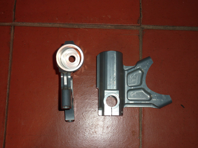

  11. They are threaded onto the fork legs, have a locking grubscrew and will be loctited. I didn't personally remove mine as I had Ktech change the internals & service the forks at the same time.
    If you look at this pic you'll see the fine pitch thread cut inside the mount;
  12. no locking grub screw on the Showa forks, there is a thin O ring .......wheel spindle keeps them from rotating during normal use :upyeah:
