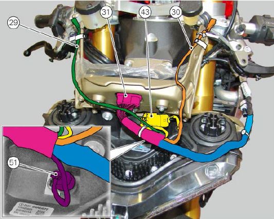

    Just purchased some bar end mirrors and indicators I've not taken my Ducati apart so really don't know where to start
    What do I need to remove to get to the indicator wires where are connections located
    Any advice would be much appreciated
    Thanks
  2. Remove the fairings and, if you wish, (although I don't know why you wouldn't just leave them in place for a future owner and functioning) disconnect the wiring to the indicators marked 29 and 30.
  3. Matt
    Great diagram thanks, I will be leaving all the original wires in place so if I wanted to take back to standard
    But with the new indicators I wanted to know were they could be connected
