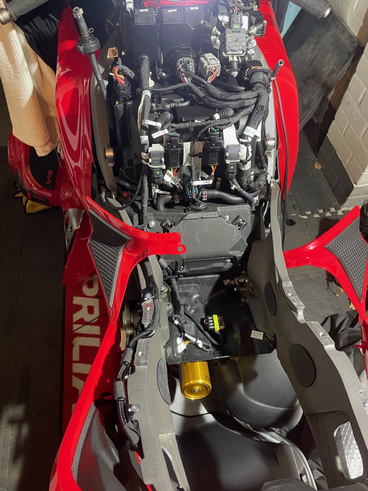

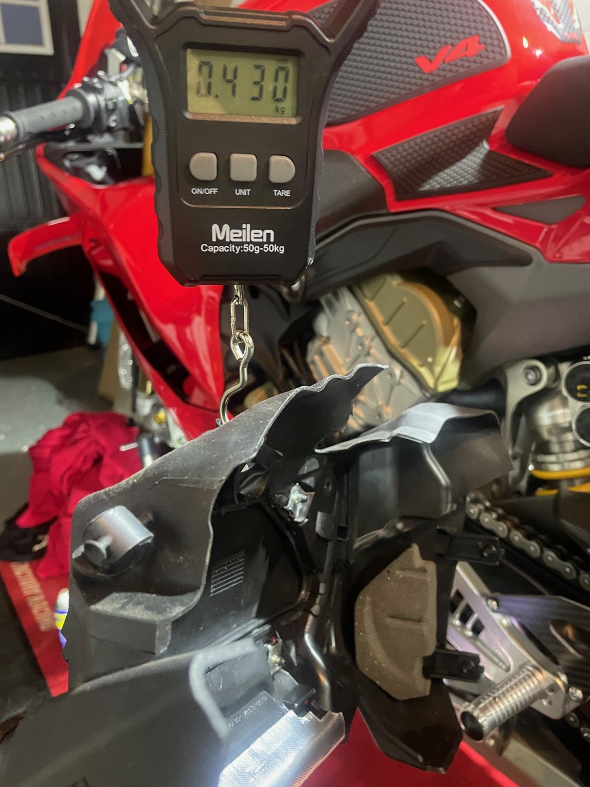

  1. Has anyone attempted to remove the black plastic covers that hide the rocker covers on a 2025 Panigale V4?

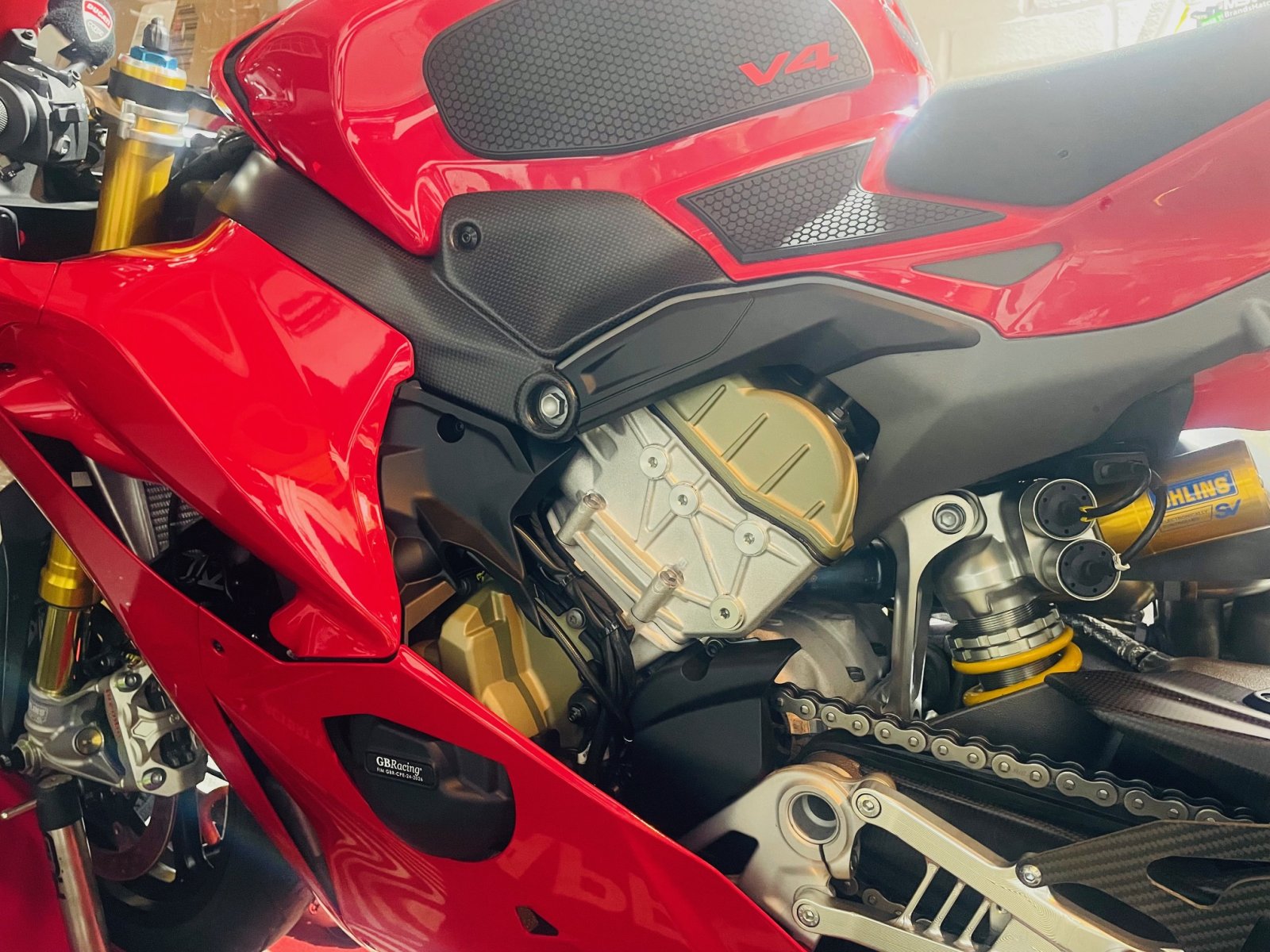

    I removed them from my 23 bike mainly for aesthetics and for me the bike just looks great without them. It wasn't the fastest job though with so much removed just to achieve something more pleasing to the eye.
    Anyway i am guessing might be the same case with the 2025 bike. Tank off to get to three screws that retain the covers.
    Cheers
    Gav

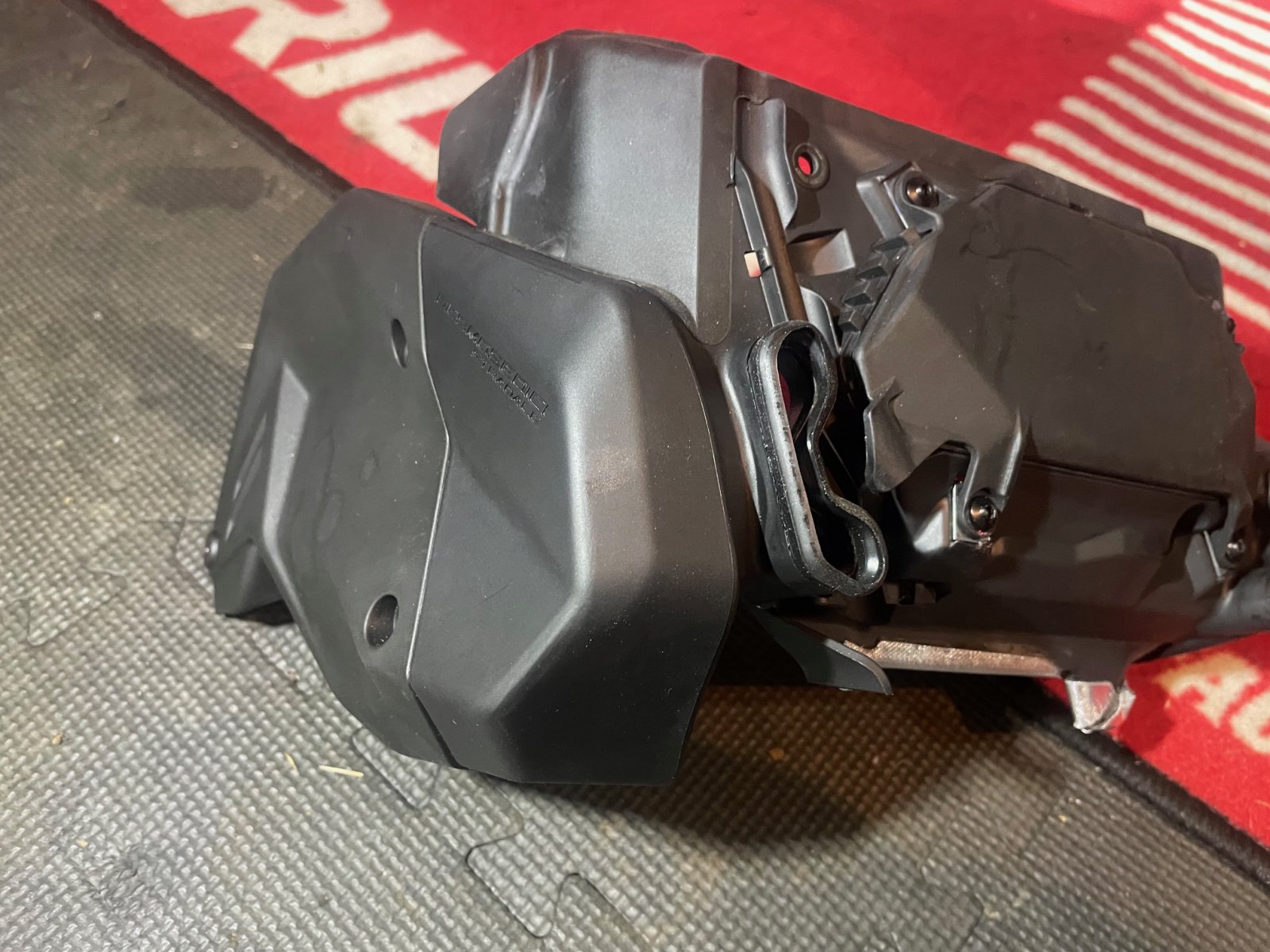

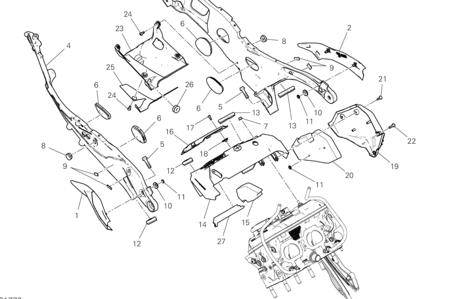

  2. If you are talking about the rear cylinders the covers aren’t like the previous bike and screwed to the inside of the subframe!
    They are part of a one piece section that sits on top of the rear rocker cover..
  3. Sorry i should have said the rear cylinders! But thanks Andy this is really helpful! Looks like tank off still and a sea of plastic covers to get to it.
