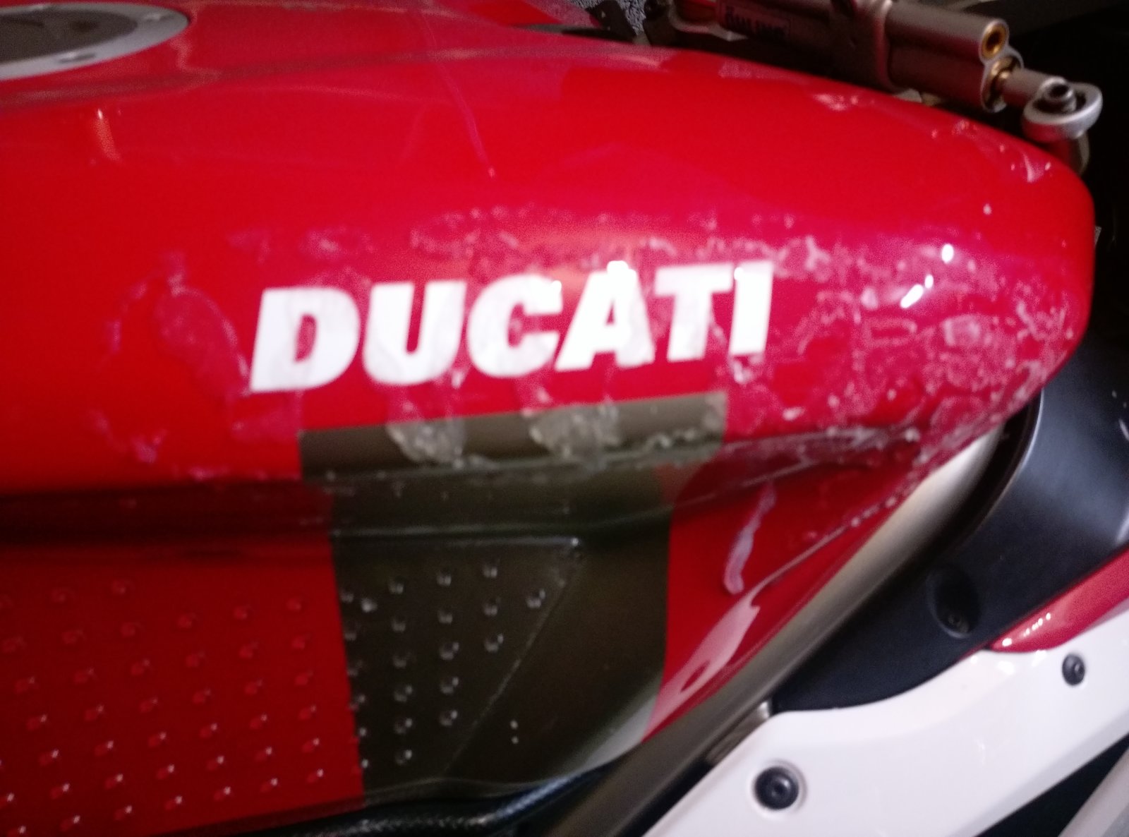

  11. So, what a bugger! Tried hair dryer after hot water bottle idea. Bugger all movement.
    Thin fishing line, nope.
    Eventually realised they are stuck on with clear silicone. :mad:
    Dont EVER put silicone any where near something where you might want to get it off. Hate the stuff, spent years working with it on various jobs.
    Worked it out anyway;
    Use a thin membership card to get under the edge, then thin cloth around the card, then thick cloth. Sort of cut with card edge and 'floss' from side to side with strong cloth to work your way through the silicone. Hard work and need to be patient.
    Then once you get the carbon off, your faced with the real hard work. Cleaning off the silicone residue. Only way is to painstakingly pick through it with thumbnails, now got two very sore thumbs and got other IMAG5088.jpg IMAG5088.jpg IMAG5088.jpg side to do (Friday eve?).
    Who ever put these on did not ever intend removing, it would only have needed a fraction of the 'adhesive'.
    • WTF WTF x 1
  14. So, its immaculate underneath, white spots just flash back. Why oh why cover up the iconic part of the bike with tat? :/
    Hoping the other side is the same and already happier.:upyeah:
  15. Very innovative removal process there, great effort and result!
  16. Great stuff, fingers crossed for the other side!
