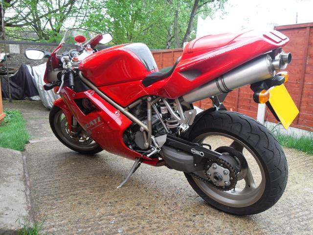

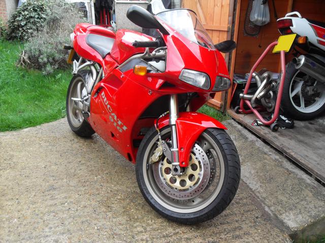

    New to the site. Bought my Ducati 916 Biposto in 2009 after looking for something a bit different from my Honda CBR 600 (1991) which I still use today which I got in 2007.
    When I got the bike it was in very good condition with no marks. It had a lot of carbon extras and little bits I didn't like so I put it back to original except the carbon rear hugger and WP shock (which has now been set up for me)
    You can see the assortment I got of exhausts with the bike in the background and a slight view of my CBR.

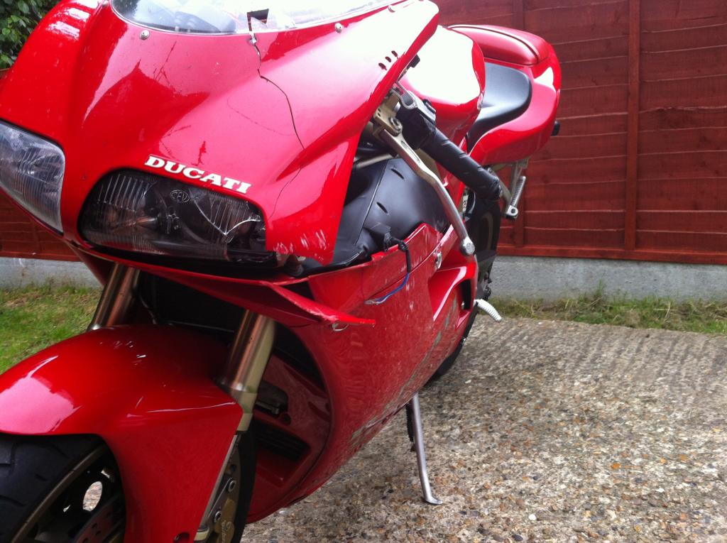

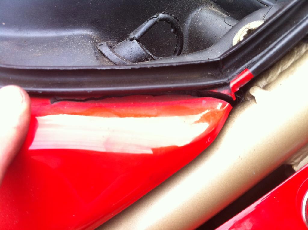

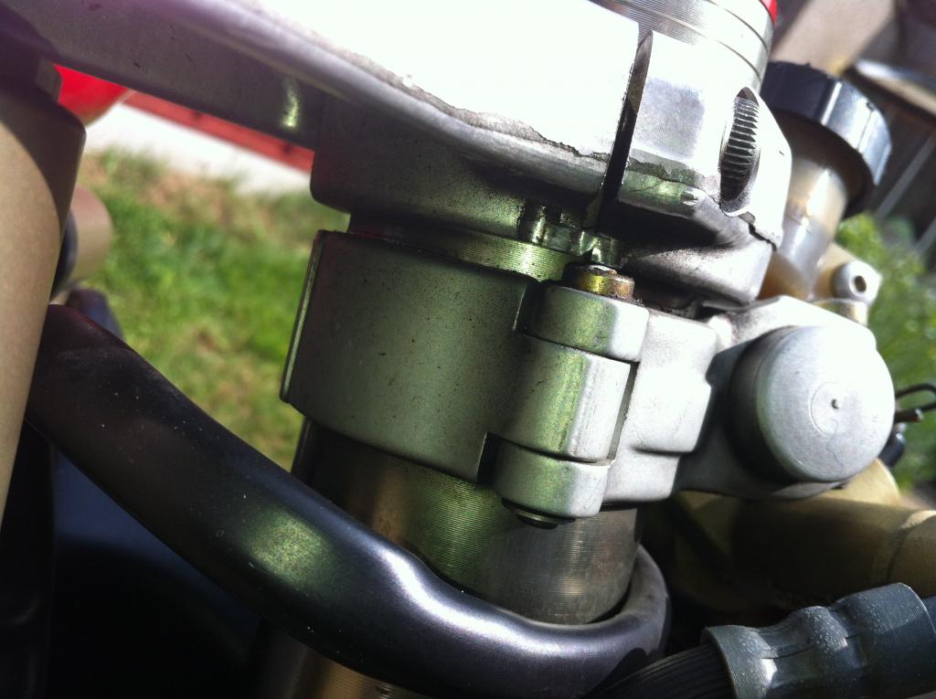

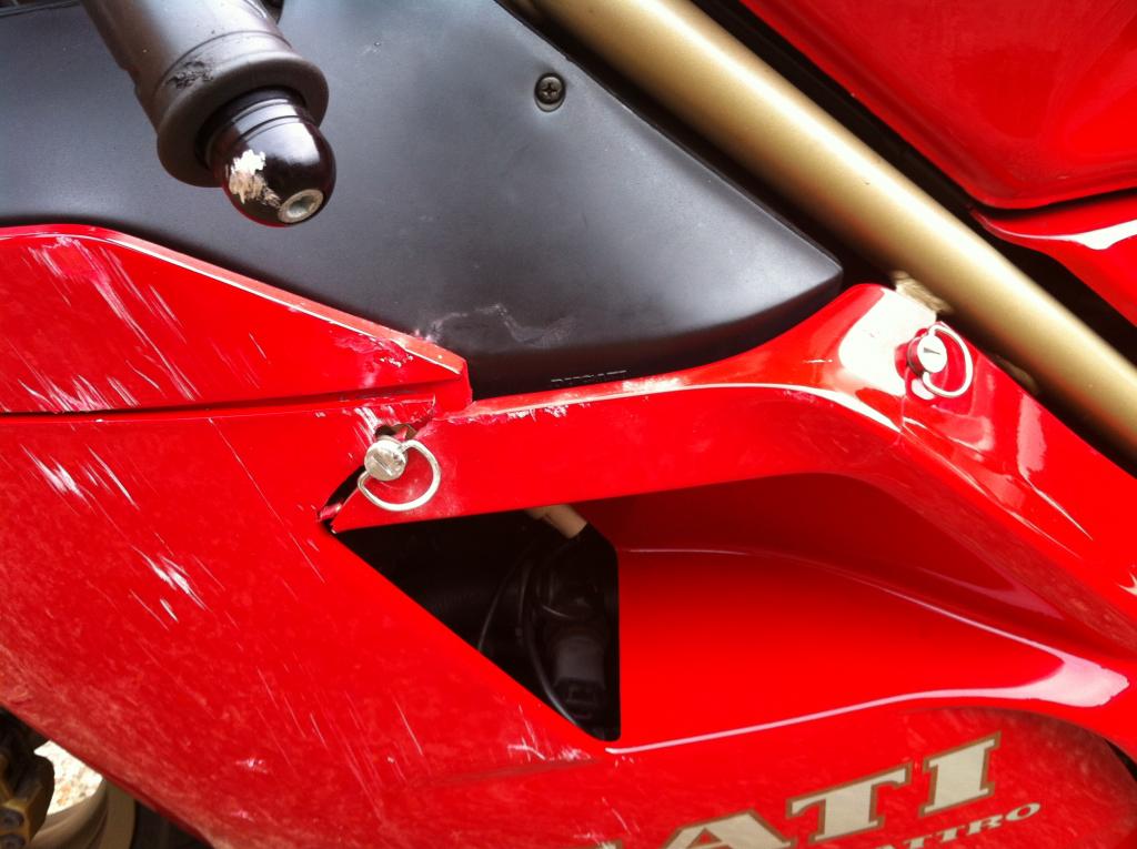

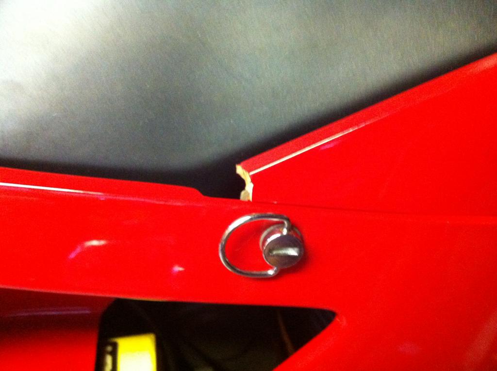

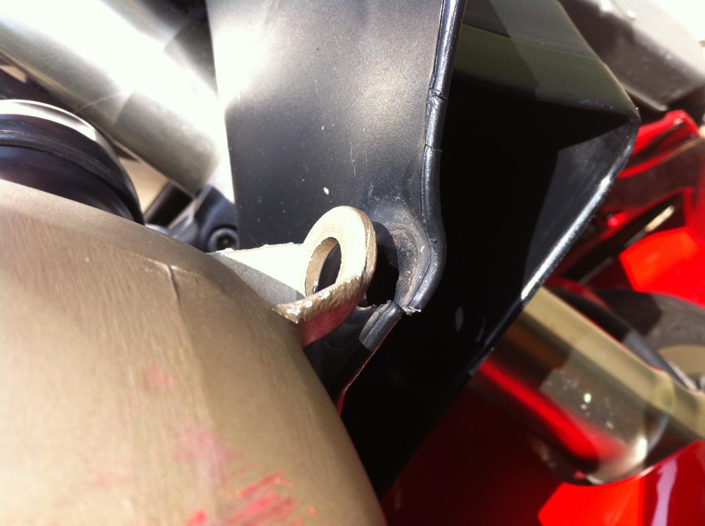

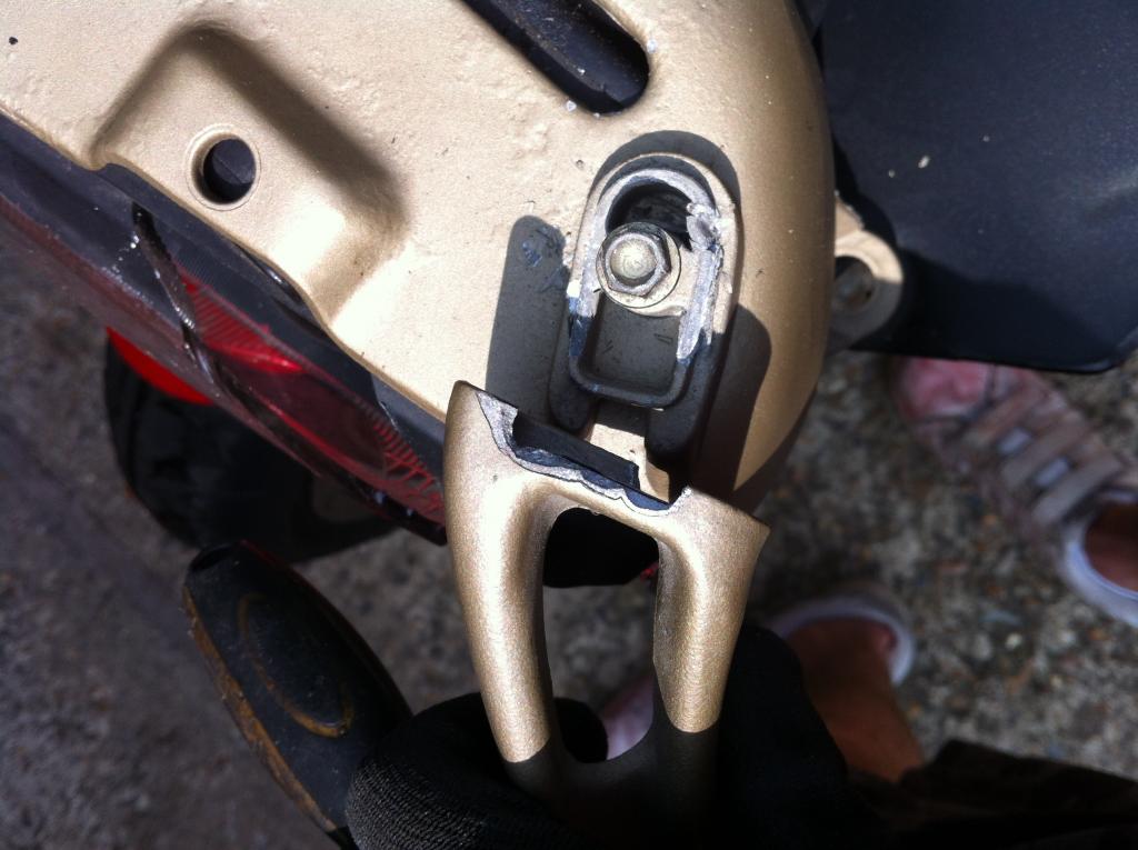

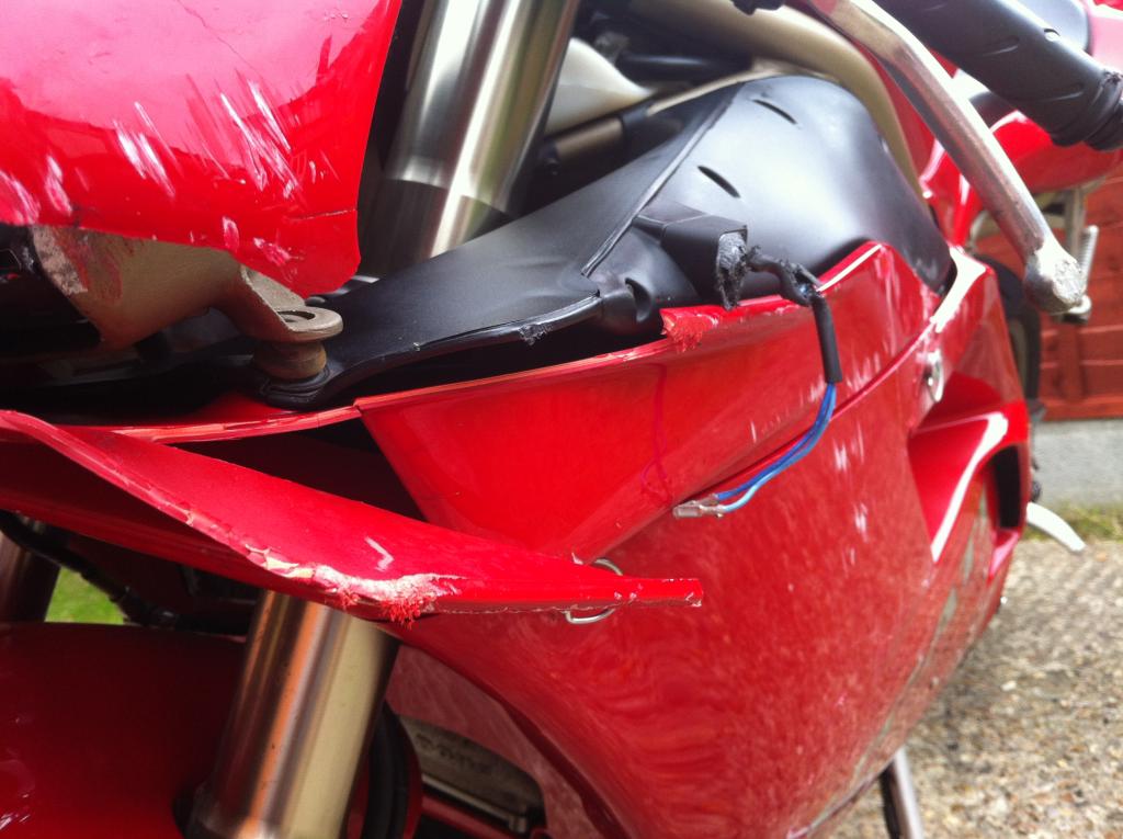

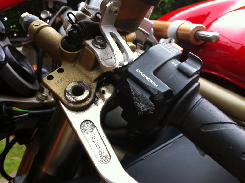

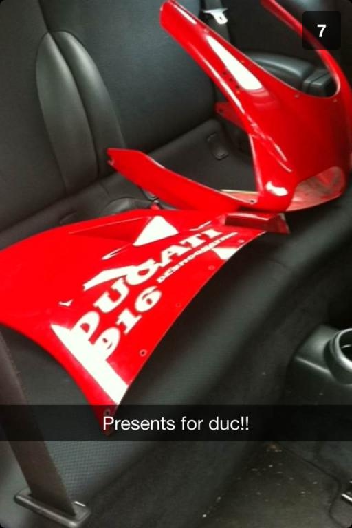

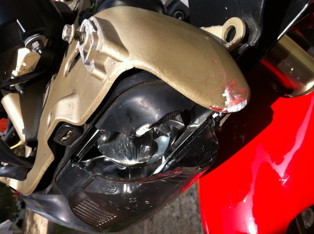

    The bike. It took all the damage on the LHS but structurely sound after being checked out by a Ducati dealer. It's just cosmetic really which needed fixing. As you can see from the pictures earlier, I had kept it in that shape and detail for 4 years, I intend to get it back to that state with second hand bits and new bits.
    Here is the damage:
    So I've got a bit to repair. I'd like to get it how it was, if anyone has any advice would be appreciated on where to get bits etc :upyeah:

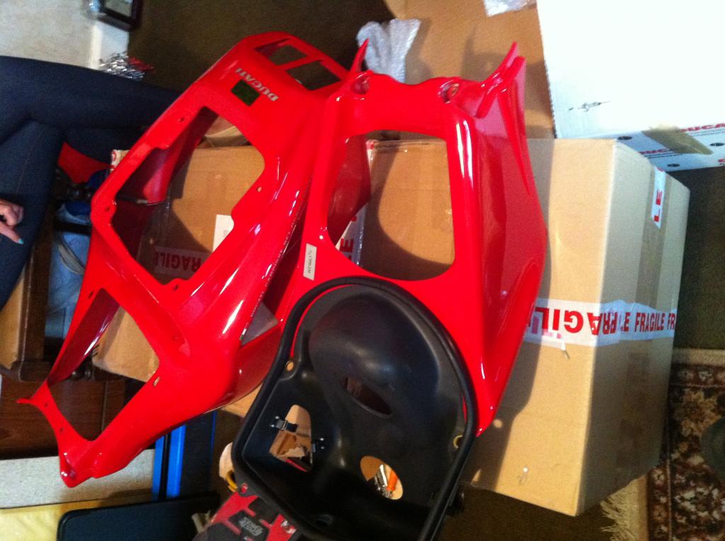

    I'm still waiting on getting paid out from insurance so progress has stopped for now but I managed to get a couple of bits:

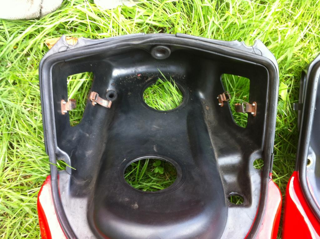

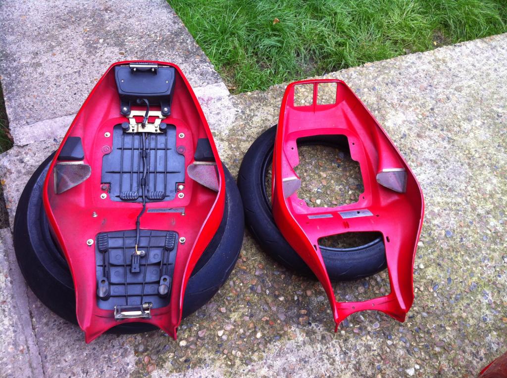

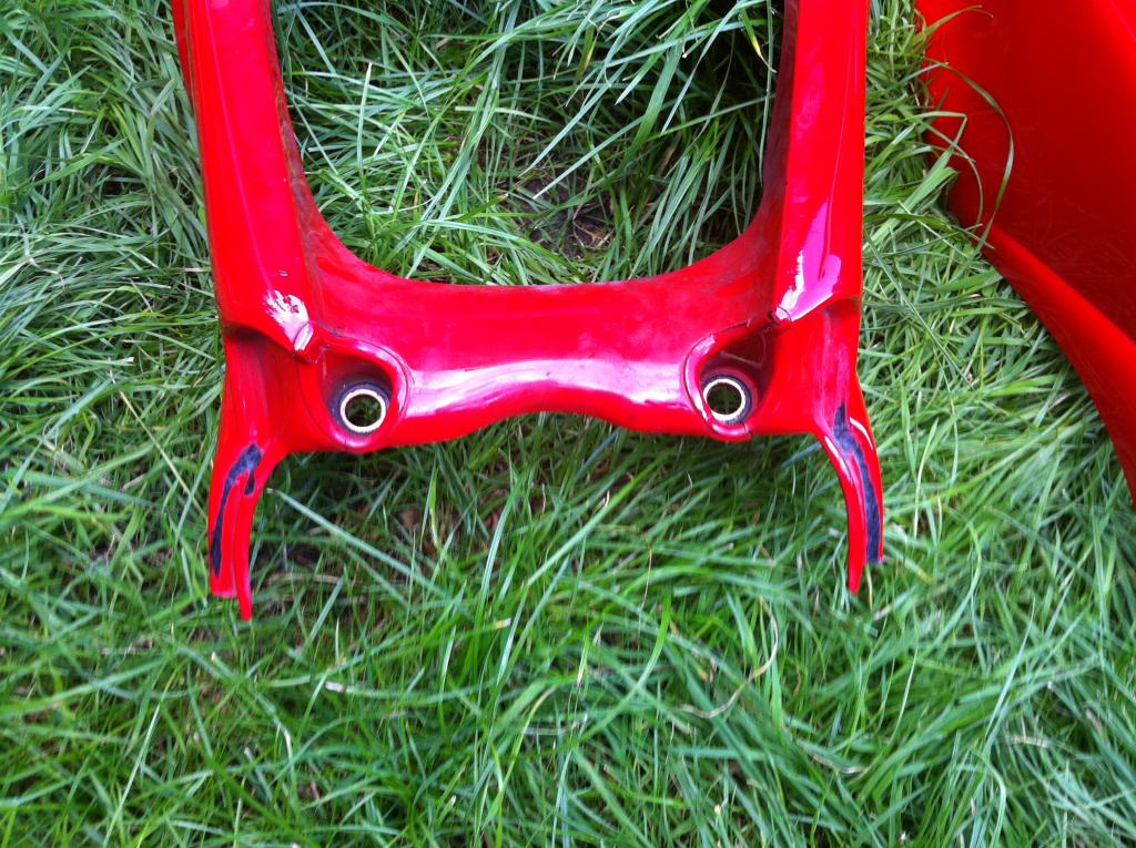

    These parts were all second hand. Airbox was taken from a brand new bike when they wanted the carbon air box fitted so it's mint. The rear seat unit is also mint, very happy with them both.

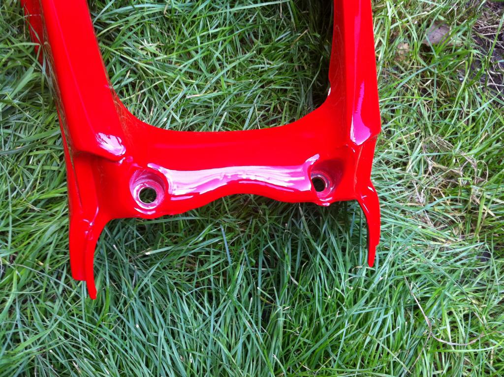

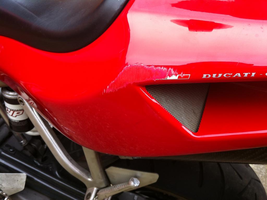

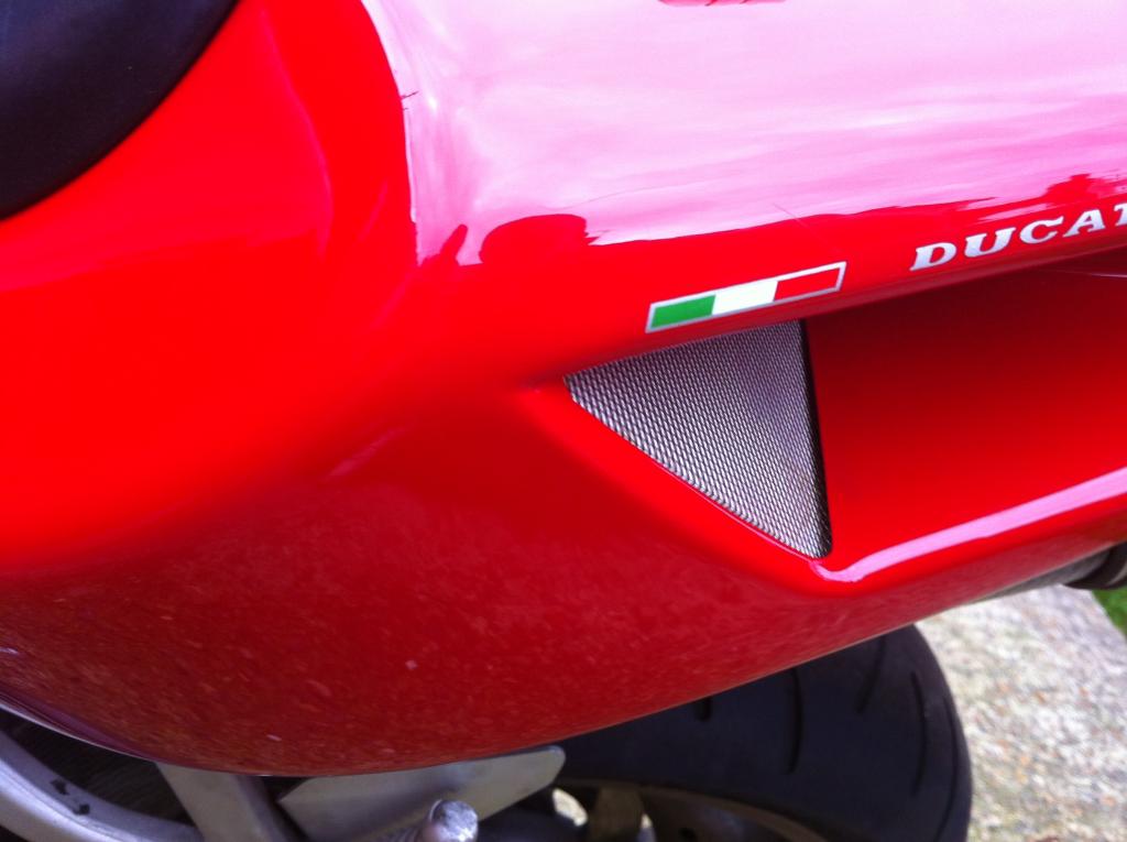

    Also the front nose cone, very good condition although a little chip on the corner (picture below) so I'm looking for a nose cone still (mint/vgc) The side panel was bought cheap and has a little mark on, so still looking for one of them.

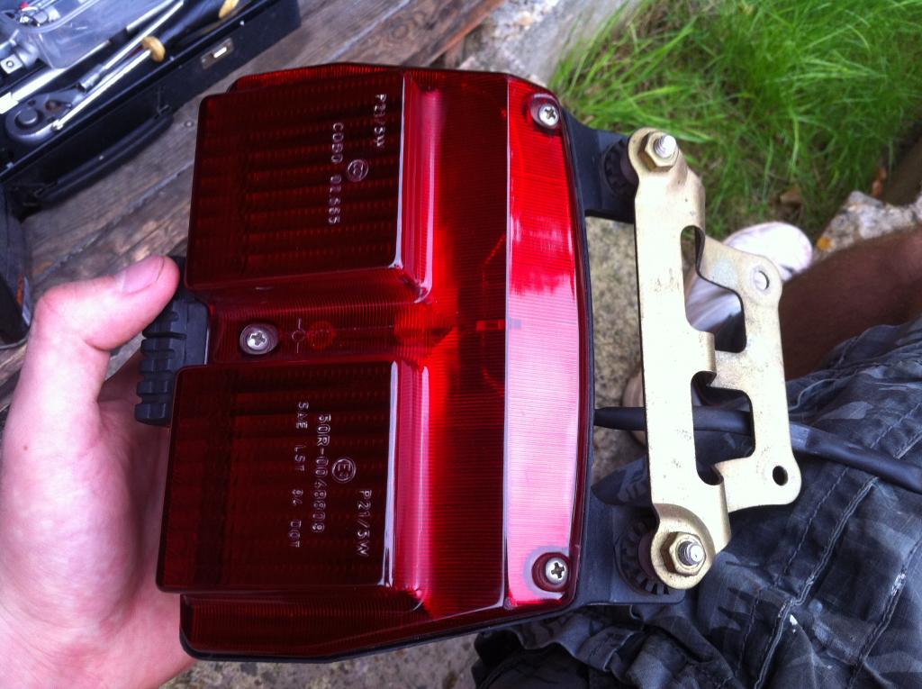

    First job I did was the seat unit replacement. The one I bought didn't have the internals so had to switch them over. Gave them all a good clean before putting back together:

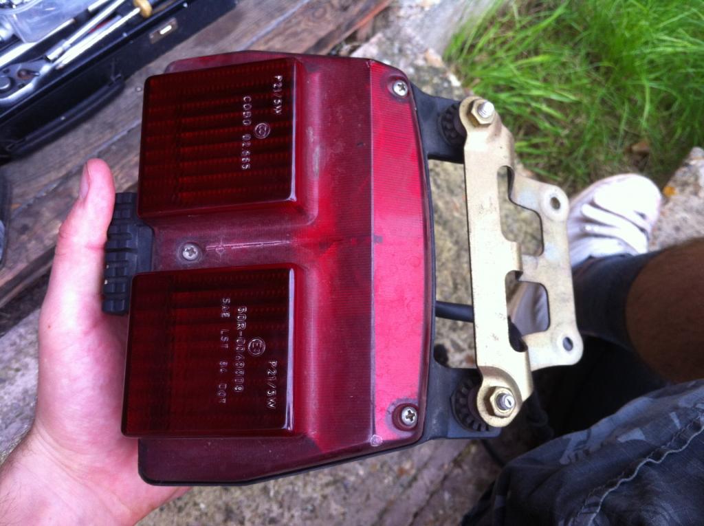

    Cleaned the light unit:
    Continued on next post.

  3. Following on from the above post.

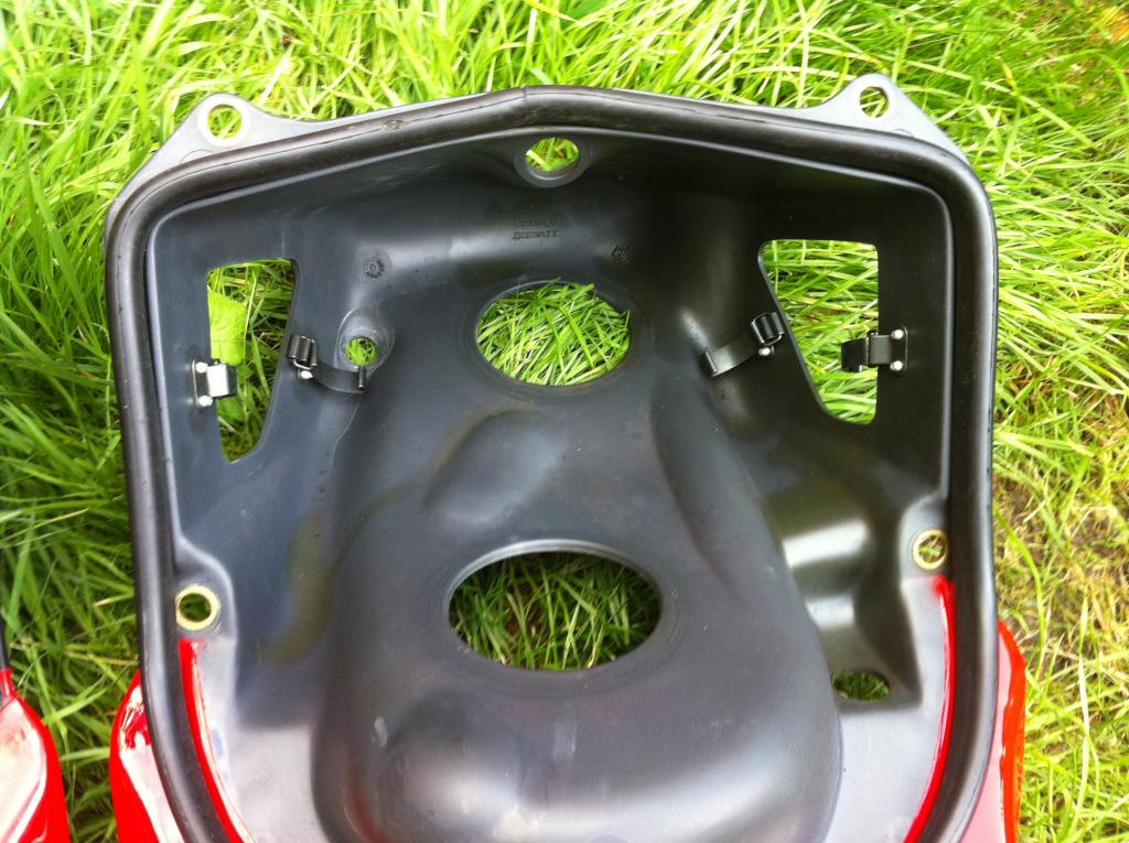

    The seat unit now all complete and finished:
    Without the damage :biggrin:

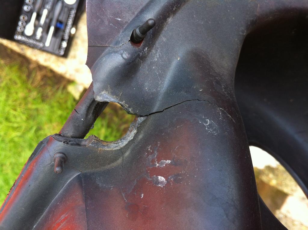

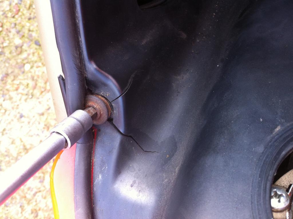

    Next up was the airbox. Wasn't a priority for me but I saw it come up on eBay pretty much new so had to get it as I knew I had a little break on it. Wasn't till I actually took it off the bike, could see the extent of the damage!
    Was shocked to see how bad it was. The below pics are the old damaged one with the new I bought, big difference!

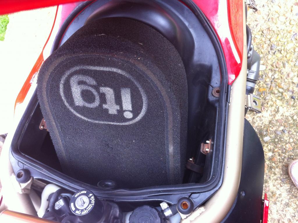

    The airbox also had this air filter:
    I've had a read up online and it's mixed reviews. This one seems to be falling apart so was looking to replace. Not sure where to get from? It's either this or I have a brand new set of original air filters that go in the tubes (fitted them now, temporarily if people advise differently?

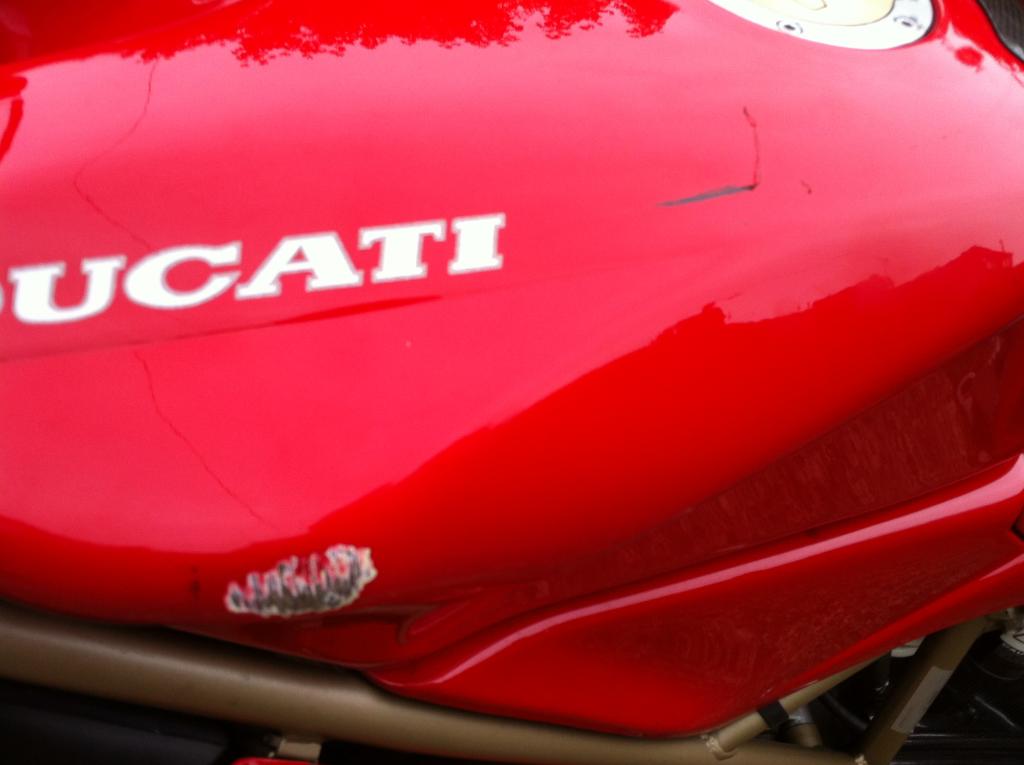

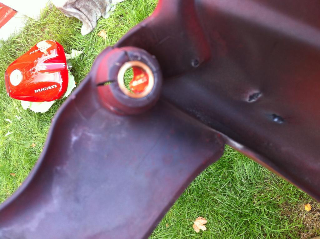

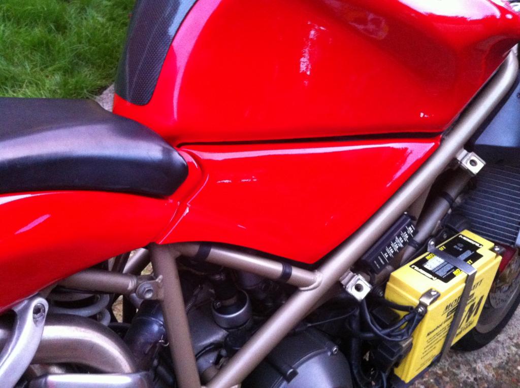

    The main bit I'm annoyed about is the tank. Are carbon side covers available in the normal carbon you get like my tankpad? There is a set on eBay but it's yellowish carbon so, do not want!
    Also, with the side panel screws, do you generally use a Ducati specific tool? As I used a non Ducati item, wasn't the best though.
    Cheers for looking and I'll update when I can :upyeah:

  6. Cracks on the airbox are not uncommon, especially round the screws as your shows. Even with no accident damage. Mine has them and I just sealed them with silicon.
    There is some debate about over the bell mouth filters vs the standard onse in the air tubes. Ive ran both with no noticable effect as far as I can tell but i am sure someone will say their rubbish. Ive put MS Production carbon air scoops on mine so i had no option but to use what youve got. Works fine for me.
  7. Re: air filter - the ITG 'all in one' type is certainly the most efficient as the seal between the tank and the airbox never worked 100% as standard even when new but a bit risky if engine is prone to flashback through the injector mouths. The BMC triangular type that fit in each side of the airbox apertures replacing the original type are the next best thing but very expensive for what they are. (MOO)
  8. re the airbox:
    i had a JHP one and it caught fire..so i got rid of it. I have a new stock airbox which ive never used, but decided on a carbon one with carbon air tubes..i went down the BMC route. these have made the throttle crisper and there is a louder induction noise. i got them for £120, so deals can be done out there...
    after my fire in the hole episode i personally wouldnt risk an over bell mouth filter. it isnt a common event, but it is certainly not isolated.
    cant wait to see this baby walk again!
  9. Jesus! ^ we are in alignment again, what's going on?..
  10. So, the guys had a crash, is putting his lover back together and all we can do is tell him his bike may spontaneously combust and burn him to death in horrible yet exquisite ways.
    You just dont get this kind of service anywhere else.
  11. my first 996 had an ITG all in one with a melted hole in it above the front bellmouth and melted filter all over the butterfly - took forever to remove.
  12. If the above have not put you off, I have an itg filter in the shed from a previous bike, (running Pipercross in standard airtubes now).
    Let me know if you are interested.
  13. i wish someone had told me that before i fitted the filter...it wasnt nice when i could smell petrol at 80mph, lost power and saw smoke...i pulled her over to the roadside and had to watch as flame began to flick up the side of the bike...where were my fellow ducatisti?? anyway, muchos £'s later, its a distant memory.
    seeing your beloved on fire, aint nice...id rather someone be straight with me and tell that these fkrs are a liability, but no, i'll stand on ceremony instead.
  14. Thanks for all the replies. I think when I get paid out from insurance I'll go the BMC route just for piece of mind. A lot of money for what they are though!
    Can't believe the ITG filters have caught fire or been bad! Good to be signed up to here to get many opinions of what's best.
    Im going to buy the ducati tool for the side panels and screen bolts soon.
    Has anyone come across carbon covers for the side of the tank? I'd imagine they were available back in the day especially with the racing bikes?
    Theres a set on eBay at the moment but it's a yellow carbon fibre rather than the carbon which is like my tank pad.
    I started the Ducati up today just to give it a breath of life, just want to get it all fixed up now!
