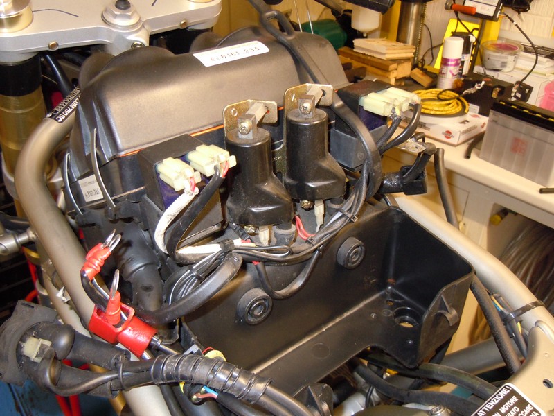

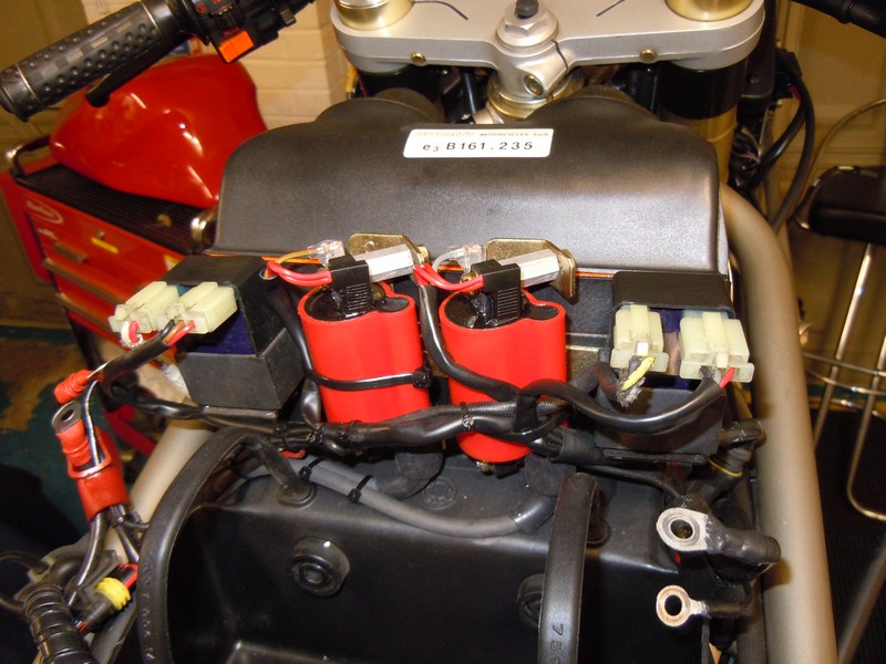

    Finally fitted my new coils. Because the LT connections are at the opposite end on the new coils I removed the smaller straight spade connection & fitted flag connections so they matched the other connection on each coil. Not sure why Ducati had one of each style on each coil, but the wire routing looks much better now. Got a few other jobs to sort out & then I'll get to try the modification & see if it makes any difference.
  10. Very neat :)
  11. Quick update, got all my planned jobs done so bike is back on the road. I did have an issue the last time I used it when it just died at a set of traffic lights, just like someone had turned the ignition switch off. Anyway, got it going again after a bit of messing about. As it was due a service & after reading about the California Cycle Works coils I thought I'd just add that to the list of jobs. So after the usual service items including oil, filter, shims, etc I replaced the main ignition relay & replaced the coils. Also found one of the oil cooler pipe connections had a damaged thread, presumably done at the factory as I have never had the cooler off & I'm sure my then dealer never had. So I replaced both flexible hoses & the damaged adaptor in the cooler.
    Anyway, no issues when it came to starting so initial thoughts are positive. The real test will be when the bike gets left for a few weeks, (at least two weeks) & I try starting it. Up until now it would struggle to fire on both cylinders & when it did if I went out a few miles down the road it would start playing up again. Having owned the bike all it's life I'd got to the point where, if it'd been left for two or more weeks before I even attempted to start it I would replace both spark plugs. I also used to turn the fuel tap off before I'd get home to run the carbs dry before leaving it for any length of time.
    I'll keep you posted on my finding when it left for a while, but like I say, my initial findings are positive.
